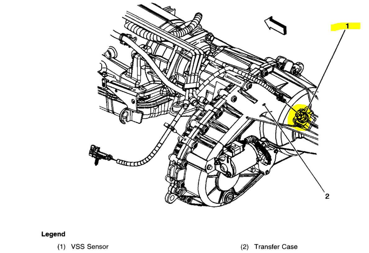

The ABS system is set up using three sensors. Both front wheels have a speed sensor and the VSS on the rear of the transfer case functions as both the vehicle speed sensor and the ABS sensor. (See pic 1 below)

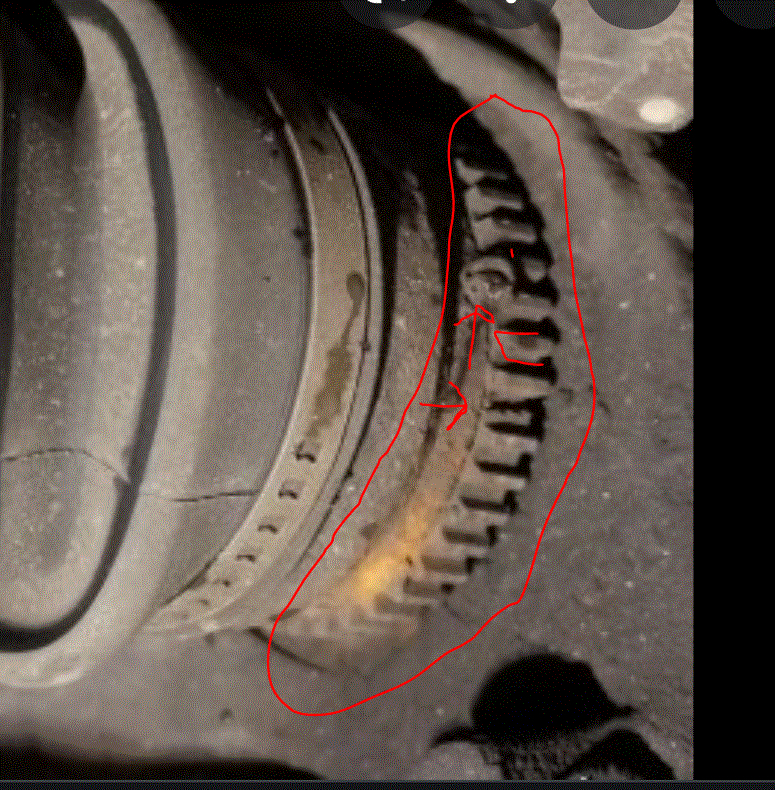

Next, I realize the front ABS sensors have been replaced, but the reluctor wheel on them can cause this as well and are not part of the hub assembly. See pic 2. I have arrows pointing to damaged points on the reluctor. Check this as well.

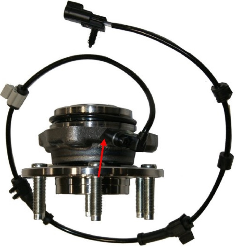

Hi guys. Excuse the interruption. A real common cause of the "false activation" when slowing down is due to that wheel speed signal dropping out, as you were told. The most common cause of that is rust build-up under the front wheel speed sensors. These sensors develop rather wimpy signals to start with. Add to that the fact that speed affects signal strength, by the time you reach 15 - 20 mph one of the front signals becomes too weak for the computer to read it. It thinks that wheel locked up, so it activates to modulate brake fluid pressure to that wheel. That's the buzzing and vibrations you hear and feel.
The distance between the magnet and the coil of wire in the sensor, to the toothed tone ring on the axle shaft / wheel bearing also affects signal strength. The rust under the sensor pushes it away from the toothed ring. That results in a weaker signal that is more likely to drop out at lower speeds.
Most ABS systems are designed to not activate or to stop activating below roughly 9 - 15 mph because the wheel speed signals are always going to be really weak at that point. The function of all ABS systems is so you can maintain steering control. At real low speeds that is not an issue.
The arrow in this photo shows where that rust develops. Remove the sensor, then scrape off any rust you find there on the bearing housing.
