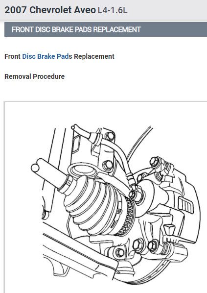

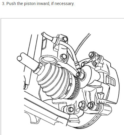

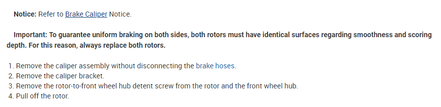

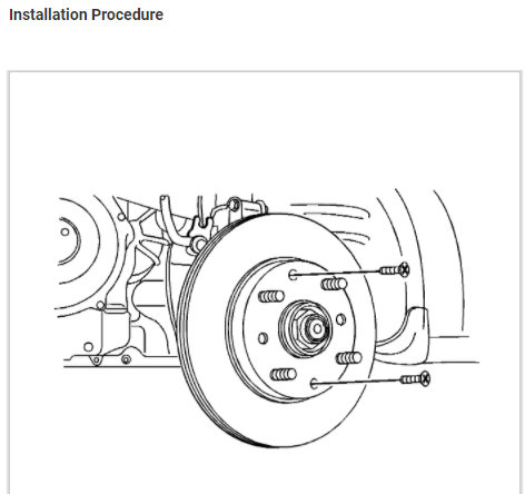

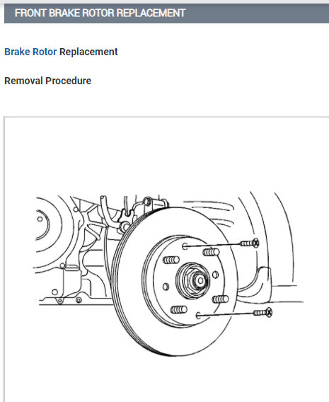

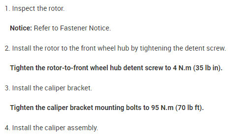

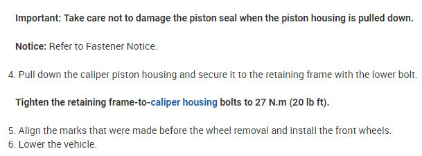

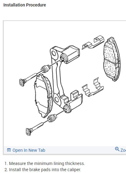

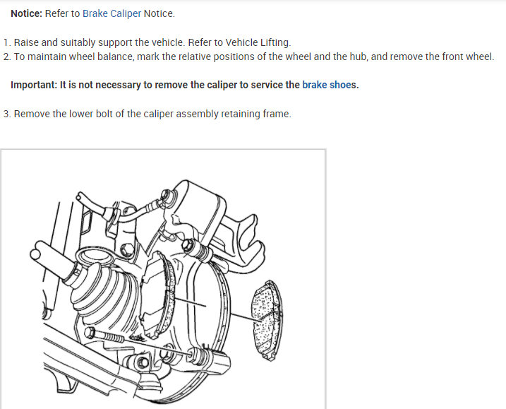

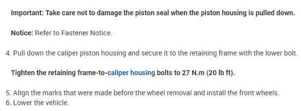

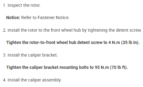

Hello, I am from Romania I have a brake job to do can you please give me instructions?
Best regards, Toni
Sunday, January 28th, 2018 AT 10:01 AM
DANNY L
MECHANIC
5,648 POSTS
Hello, I'm Danny.
Here is the information you requested. This is a tutorial showing what is involved on how to change front brake pads and brake rotors:
I've attached picture steps below on how to change the front brake pads and rotors on your car. Hope this helps and thanks for using 2CarPros.
