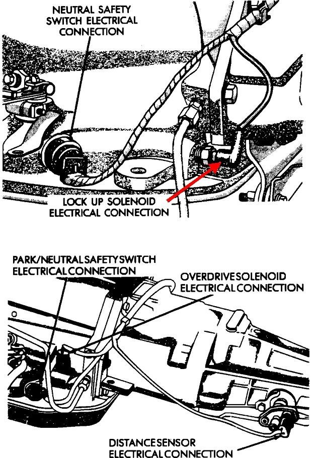

This seems to happen worse when braking in reverse and when the engine is not up to operating temperature.
Sometimes the stalls in reverse seem to temporarily take the engine to very low RPM and stops or the RPM's come back up and the engine comes back to idle.
In addition I hear the tires screech when this happens.
I have replaced about every sensor there is on the engine plus I put in a new distributor because the old one had a pool of oil in it. I thought for sure that was the problem but no dice.
Is it possible that this could be some sort of transmission “lock up” problem that just occurs sometimes? Solenoid stuck or something?
There were no codes other than 12 when I disconnected the battery

You originally asked about a lock-up torque converter problem. The only common problem with those was with early GM front-wheel-drive cars. They would stick engaged and cause stalling when slowing down, similar to not pushing the clutch pedal with a manual transmission. The "fix" for those was to unplug the two-wire connector so the lock-up function never occurred.
In your case, being below 35 mph, and being in reverse means the converter hasn't locked up, so it can't be sticking on. There are other things that can happen inside the transmission that might cause symptoms similar to what you described, but there should be other problems then when you're driving.
+1
Tuesday, October 8th, 2019 AT 6:40 PM
LENNIER
  • 11 POSTS
So, your saying that with this A500 transmission there is probably no way the transmission should be locking up? If so, I will give up on that idea. This was just one "off the wall" cause that I read on a forum and at this point I will look at all the off-the wall suggestions :(.
Any history of the PCMs causing this kind of problem?
Wednesday, October 9th, 2019 AT 3:15 AM
CARADIODOC
  • 34,489 POSTS

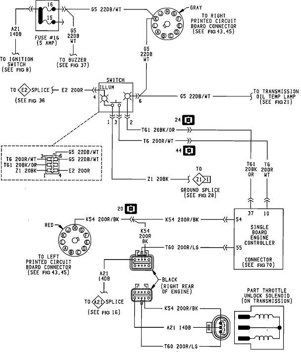

Chrysler's Engine Computers of this era caused very little trouble.
Lock-up torque converters were invented by Chrysler, as were most of the innovations from the '50s through the '90s that truly benefited car owners. The first ones used in 1977 with big block engines were controlled by valves in the valve body of the transmission. No electronics involved. The newer ones, like yours, are switched on and off by the Engine Computer that turns on an electric solenoid that opens a valve to let fluid flow to the lock-up clutch. That will only occur once the engine is warmed up, above approximately 30 - 35 mph, and only in third or fourth gear. Also, the computer unlocks it when the throttle approaches fully-closed, in anticipation of coming to a stop, and at anything over roughly 3/4 throttle. That is because when not locked up, torque converters cause engine torque to be doubled compared to the clutch on a manual transmission. Double the torque at high throttle is what allows you to pull out and pass with blazing speed.
The last and best clue to verify the lock-up function is working properly is to hold the accelerator pedal and road speed perfectly steady while you're cruising at highway speed, then lightly tap the brake pedal with your left foot. If you have a tach in the instrument cluster, you'll see engine speed pick up 200 rpm for two or three seconds, then it will drop down again. This is also done in anticipation of slowing down to a stop.
Since tapping the brake pedal causes the converter to unlock, a circuit from the brake light switch is an input to the Engine Computer. That same circuit is used for the "cancel" signal for the cruise control. This is a second part of the brake light switch, and is not the part used for the brake lights. The reason for this is one switch turns on to turn on the brake lights. If those contacts become burned or arced, you won't have brake lights. While that is undesirable, it would be a safety problem with the cruise control. If that switch was defective, the cruise control would not kick out when you need to slow down when overtaking another car. To address that, the second part of the brake light switch is turned on and provides 12 volts to that terminal on the Engine Computer. When you press the brake pedal, that 12 volts drops to 0 volts. That is what tells the computer to cancel the cruise control. This way, if that set of switch contacts were arced or burned, or the wire was cut, the cruise control would never set, and there would be no safety concern of it not kicking out.
That switch and circuit that cancels the cruise control is the same circuit that tells the computer to unlock the torque converter. What this means for us is we can use the operation of the cruise control as a diagnostic tool when there's a problem with the lock-up converter. If the cruise control sets normally, and it kicks out when tapping the brake pedal, you know that switch and entire part of the circuit are working.
Leaving the computer, the cruise control servo solenoids and the torque converter clutch are on their own dedicated circuits. Also, the electronic switching inside the computer is done by different circuits, so if one system works properly but the other one doesn't, the place to start looking is at the computer and the circuits leaving it. The one circuit coming in from the brake light switch can't be the problem if one of those systems is working properly.
In the rare event the converter seems to be sticking when you come to a stop, that is highly unlikely to be caused by a shorted switching transistor inside the computer. Most commonly when a high-power transistor like that shorts, it stays shorted. That means it would try to energize the lock-up clutch as soon as you turned on the ignition switch. I've never heard of that happening, so I'm not sure what the symptom would sound like. For sure it would snub the engine off as soon as you tried to shift out of "park".
It would be more likely the lock-up clutch would stick mechanically due to something coming apart inside the converter, but that would surely result in a miserable vibration. If you think crossed or shorted wires are keeping the converter locked up, you may be able to verify that by unplugging the three-wire connector on the left side of the transmission.
You can also tell if the converter is locked up by observing the tach when you accelerate slowly, as in from 55 to 60 mph. If the converter is locked up, engine speed will increase exactly the same as road speed increases. If it's not locked up, engine speed will jump up right away, then it will take some time for road speed to catch up. This is easiest to see if you do it before the engine has warmed up. In my case, when leaving my house on a hot summer day, I can drive about two miles on the highway before lock-up occurs. On a cold winter day, it takes over six miles before the coolant temperature is high enough for lock-up to occur. When that lock-up finally occurs, it is not unheard of for some drivers to mistake that as up-shifting to a higher gear. The delay is designed in because when the transmission is cold, the fluid doesn't flow well to the cooler tank in the radiator. Higher engine speed equals higher transmission front pump speed, and that helps push the fluid through the cooler tubes. Once everything is warmed up, the fluid will flow much easier, so the lower front pump speed is not a concern. If lock-up occurred right away, the relatively low 5 - 10 pounds of fluid pressure might not be sufficient to push the thick fluid out of the cooler lines. The fear is the hot fluid inside the transmission won't get a chance to go through the cooler, which would result in overheating the fluid.
If all else fails, you can use a scanner to see when the computer is requesting lock-up. I have a Chrysler DRB2 and a DRB3 for all of my vehicles. They show the "torque converter clutch request" as "on" or "off". You can watch it switch to "off" when you tap the brake pedal, close the throttle, or slow down below the minimum speed. The idea is to watch for the lock-up request and the lock-up you feel not agreeing. I've never run into that. The problem that's usually being diagnosed is a failure of the converter to stay locked up. The clues to that are found under the cruise control diagnostic menu. It will show the state of the brake light switch, throttle position, road speed, and coolant temperature. You have to figure out which of those isn't correct. Most commonly it's caused by a brake light switch that is out-of-adjustment, or it's so close, that the pedal vibrates when driving over bumpy roads. That's the biggest cause of the cruise control kicking out intermittently. The torque converter will unlock and re-lock intermittently at the same time. The typical complaint is engine speed is surging, and people think the transmission is slipping.

I did take it for a drive this weekend and found that if it tapped on the brake while driving at a steady speed (55) and OD engaged that the OD never disengaged. I did this several times.
Also, when I first started out when the engine was cold it did stall when I put in reverse and gave it some gas.
I then did the same thing with the OD button pushed to off. As soon as I put it in reverse the engine stall (died). Now this is just the opposite reaction I would have expected.
I than pushed the button to OD on and tried again and it worked perfectly, no stalling.
I than pushed the button for OD off and tried again an it also worked, no stalling.
So I repeated these steps again and than it started stalling again. I guess my point is that taking it in and out of OD did temporarily changed the behavior, however I'm not sure I can interpret what that means other that I'm not convinced that the AT is not the problem.
I think the next step for me would be to disconnect the electrical connector and see what happens.
Again thanks for your help.

I unplugged the OD connector and I found out I still had the problem. The interesting thing after playing around with it, I found that if kept the brake on and revved to about 1,800 RPM's the engine shut down.
It will not do this in drive just reverse. So it seems to me that so how in reverse the overdrive locks up and kills the engine. Now it might also do it in drive but this time I could not make it do it. If it is doing this it is purely mechanical.
Also when I start he engine when it is cold the RPM does rev up 10 about 1,500 for a little while. You had asked about this once and I never gave you an answer. So, I guess this means that my A500 transmission is shot?

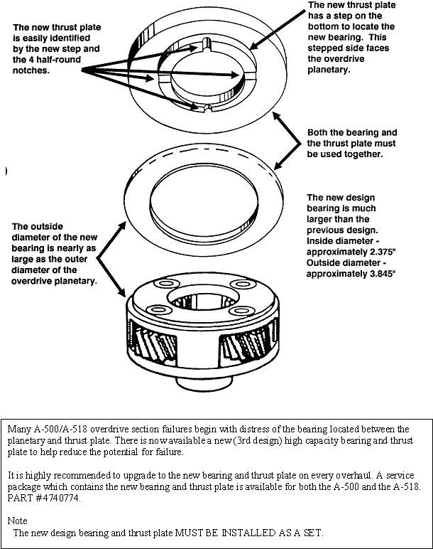

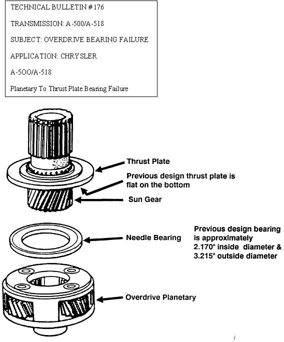

There was a service bulletin many years ago that had something to do with a check valve in the over-drive clutch drum. I thought it caused over-drive to not work at all, or it stuck on when down-shifting. I'm going to do some research to see if I can find that bulletin.
Saturday, October 19th, 2019 AT 7:05 PM
CARADIODOC
  • 34,489 POSTS
The bulletin I just mentioned is not listed for a Dakota, but I did find this one. Unfortunately they didn't list the symptoms this problem causes. There are some other service bulletins for your transmission, but those that might have applied referred to problems caused by incorrect parts installation, which we know isn't the problem you're having. One has to do with the over-running clutch being installed backward, and the other has to do with installing straight and waved snap rings into a clutch drum in the wrong order. That one resulted in no over-drive.
