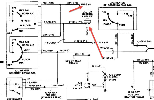

The air conditioner does not work; the blower does not work. If I put voltage on compressor clutch, a/c clutch engages. I checked the blower and I put voltage on blower and it works too. thanks in advance,

ok now that we know what we are dealing with again I am assuming system is full. arrow points to the clutch cycling switch which is located on the accumulator . I t looks like a tall can where pipes go in it will have a large pipe for a/c going to it. fuse 9 controls a/c. jump the wire and see if compressor starts if not then it's a wiring problem or diode on compressor but in previous replies you said if you power up compressor it will work. if system is not full that is why compressor doesn't work and Freon has leaked out. you will have to refill system with R134 instead of R12 because 12 is very expensive

the a/c compressor is coming on after I replaced the accumulator switch. Yet, the fan blower does not come on with any speed on blower switch with a/c or vent on, if I connect voltage to fan blower under hood, the fan works on any speed.

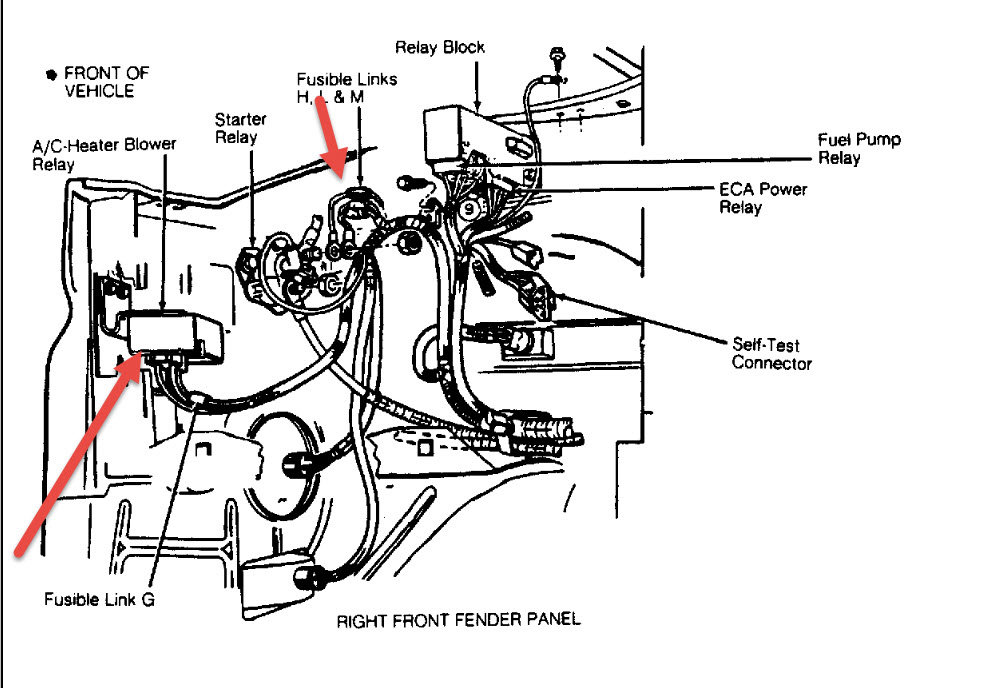

that is either the relay or a bad fusible link it is on rh side of engine compartment above headlight. links are attached to starter relay and should have 12v on both sides. pic in next email

see pic

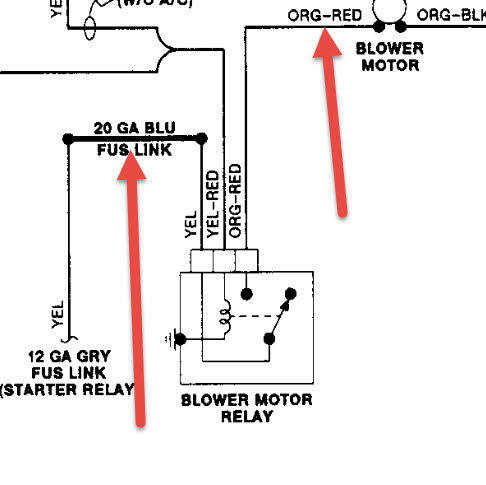

I have checked the fusible links and they have voltage on both sides; the relay has 4 wires, solid yellow, solid red, brown w/blue stripe and orange w/ blue stripe. what should the voltages on each wire with key on? Thanks

yellow wire should have power then orange/red in pic you will see another fusible link blue if no power at yellow check that. although relay could be bad, now that I remember that was a common failure on fords was the relay. but that was 30 some years ago..for me lol

The yellow wire has powerw/o and with key on, the other wires except orange w/ blue stripe have power, does the orange w/blue stripe have a fusible link?

forgot to load the damn pici don't show orange/blu I show orange/red which goes to blower if no power there then relay is no good yellow/red shold have power when a/c is turned on.
