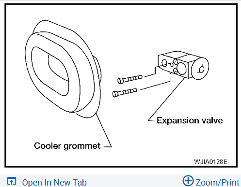

My A/C quit working. I need to know the location of the orifice tube. Can you please send me a pic of the location?
Jul 22, 2025 at 8:47 PM
  • 54,502 POSTS
There is no orifice tube in this system, there is an expansion block at the firewall where the A/C line runs into. Does the system have the correct amount of refrigerant? This video and guide can help us see what is going on:
https://www.youtube.com/watch?v=4UjfQKvrB6Y
and
Here is what the expansion block looks like. Check out the images (below). Please let us know what happens.
