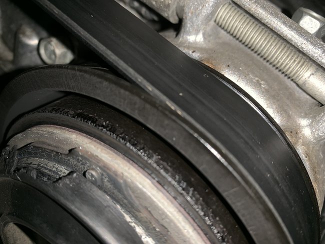

Hello all, I just experienced this issue recently and I'm looking for a diagnosis. I was driving yesterday with my A/C on, it working just fine. As I came to a stop, I went to accelerate. But when I pressed on the pedal, I didn't get anything. So I stopped and put the car in park, then proceeded until I got to my house. Shortly after continuing, I noticed that cold air was no longer coming out of the vents. And when I got to my house I popped the hood and I could smell a strong burning smell. And now no cold air is coming out of the vents. Just warm air, not too hot.
For some months I've been noticing an issue that when my car is at idle. And I have the A/C on, sometimes the motor will shake. It usually happens when the A/C is on full blast.
I've done some looking online, I saw where it could be A/C compressor failure. So I looked at the A/C compressor to see if the clutch was engaging. The clutch is engaging, but still no cold air coming out. Also the belt is also spinning. So I'm wondering if a A/C compressor can be bad, but the clutch still engages.I did notice that there was some wear and tear on the clutch. Rubber pieces around it, has begun to tear away. Also when I cut on the A/C the burning smell comes back.

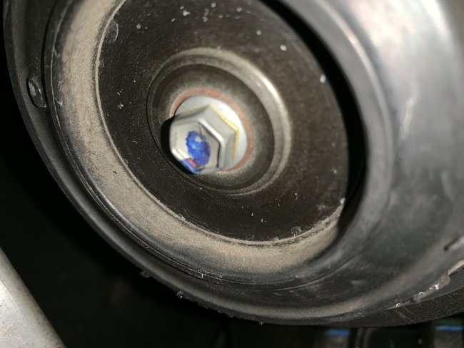

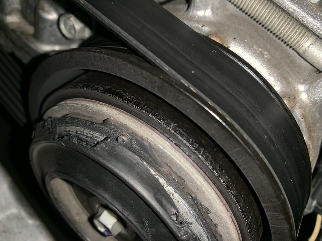

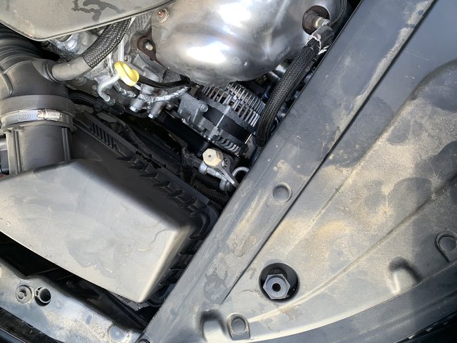

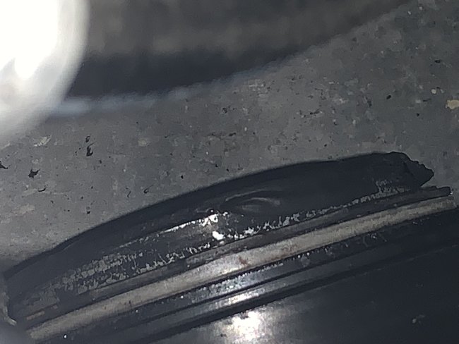

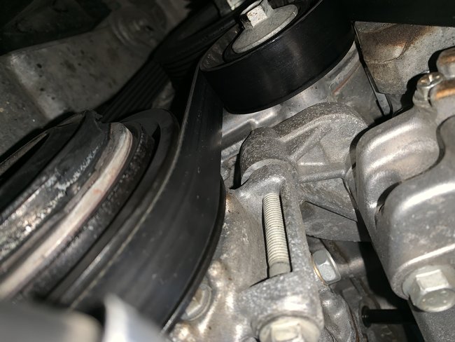

Hello Joe, I gave it a shot this morning. I also had a helper with me during this. We could see and hear the clutch engaging. We heard that clicking sound that you mentioned.
I'm attaching some videos and pictures. Particularly when the A/C is off, it's like a rattling sound coming from somewhere (2 short videos). Hopefully you can hear those sounds, it's almost like something is out of alignment and rubbing. I also attached a longer video so you could see the clutch spinning. We still noticed the burning smell when turning on the A/C. And in the pictures that I've attached, you can see the rubber pieces around the clutch tearing away.
Thanks for you help again!
Jul 6, 2019 at 4:57 AM
Looks like you need the compressor changed out.
