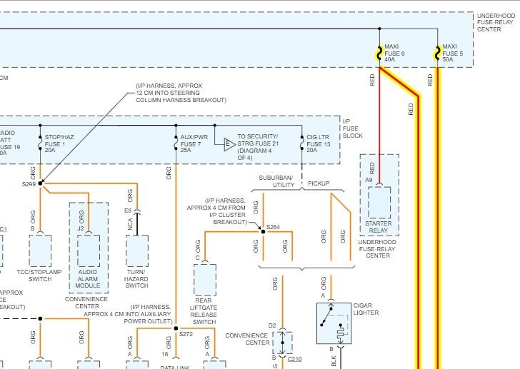

In step 5 of circuit/system testing, there is always voltage between terminal 30 and 87. So, how do I find where the short is?
Thursday, July 25th, 2019 AT 5:14 PM
  • 52,797 POSTS
30 is battery powered. 87 goes to the load.
Thursday, July 25th, 2019 AT 5:38 PM
JASON123177
  • 27 POSTS
Ok, I know that I have been a bit confusing because I didn’t really know what I was doing when it came to testing the electrical part of this system. But, I think I have figured it out after doing some studying. So, terminal 30 always has 14.2vdc when key is on. Terminal 86 has 14.2vdc when there is demand for A/C and 0vdc when there is not. I am thinking that those voltages are what they’re supposed to be. So, there is an issue between terminal 85 and the pcm. The pcm isn’t allowing the circuit to be complete between terminals 85 and 86 for some reason and not allowing the switch to close between pins 30 and 87 in the relay. Therefore the pcm isn’t providing the ground to complete the circuit between terminals 85 and 86. The circuit from the compressor to terminal 87 has to be complete because the compressor runs when 30 is jumped over to 87. This is where the pressure transducer comes in to play correct? But, the pressures should be within operating range at 210psi on the high side and 50 psi on the low side. If there was a condition where something grounded out between terminal 85 and the pcm, electricity would still flow between pins 85 and 86 and cause the relay to close and the compressor clutch to engage. So, I am thinking that there is definitely a problem with the pcm. Please correct me if I am wrong.
Thursday, July 25th, 2019 AT 7:47 PM
  • 52,797 POSTS
Correct. The PCM grounds the control side of the relay to power pin 87. It will do that when it sees the correct signal from the pressure switches.
Even when it does turn it on, the low side is incorrect. It is too high as I stated before.

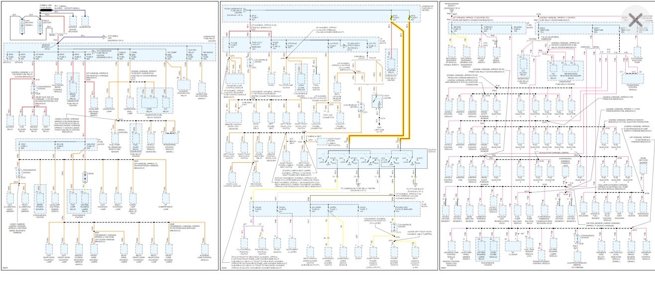

  • 52,797 POSTS
They come from maxi fuses. The actual fuse block may be the issue.

If I should be tracing down electrical issues, how would I test the fuse block. Also, the scan tool would not operate the A/C. It kept saying something to the effect of not being able to connect to the A/C system. But, it read the engine DTC’s
