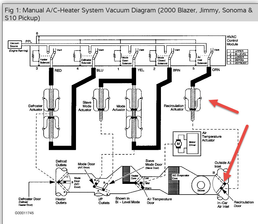

I turn air conditioner on to max and it works great. It blows hard and strong but when I hit the gas it slows down like you turned the knob back down to regular air conditioner setting on the knob. Once you let the gas off it comes right back to max and blows like it should. This happens every time I pull out into traffic or leave from a stop sign.

There is a check valve in the vacuum line that is located in the engine compartment which feeds the climate control system. Locate the vacuum line headed into the firewall and then remove the check valve and try to blow in it. It should only blow one way.

Pulled check valve today. The part has three ports on it. Two of them tie together. Air will only blow one way, so this valve is OK. When I blew on it oil came out of it. But it still works. What can I try next? I have already replaced the vacuum valve behind the glove box which operates the doors and also the vacuum control swich on the dash.

There can't be no wire contact problem because I removed all the wires and cleaned them. Both battery cables and EVERY single ground on this truck. I cleaned them and there contact spots. Charging system works like new. What are you talking about the control head scan and where is the transfer case vacuum switch? There is oil in the vacuum tank in the inner fender plus the 4 wheel drive vacuum actuator. It must have to do with a vacuum door that opens when you turn the A/C switch from regular A/C to max. When I step on the gas it looses vacuum and shuts the door.

I am sorry HMAC300 you mite of not under stood me. My fault! The fan does not slow down, it happens like this. You put the controls on max and it works great, blows a lot of air. When I hit the gas it is like I turned the knob from max to regular A/C it still works but not as powerful as on max but, as soon as I let of the gas it comes back to max again. The whole A/C head control unit is new and there was no oil in it. Just oil in the vacuum tank in the fender and the 4 wheel drive actuator. Where do you think this oil is coming from?

What I told you a couple of replies ago it should be easy to find it's either on the axle or case you could have a broken door as well but it sounds like the one door or a couple are changing due to a vacuum loss. Which can be anywhere in the vacuum system try holding the fresh air door closed so it only pics up air from the cab that is what max air does besides speed the blower up. That would tell you it's a vacuum leak or see if the hose was not connected or connected to wrong place.

Thank you so much HMAC300 I found the small leak in the orange tube going to the recirculation actuator behind the hvac control panel. Now I will check the transfer case vacuum switch out next. Thanks again!
