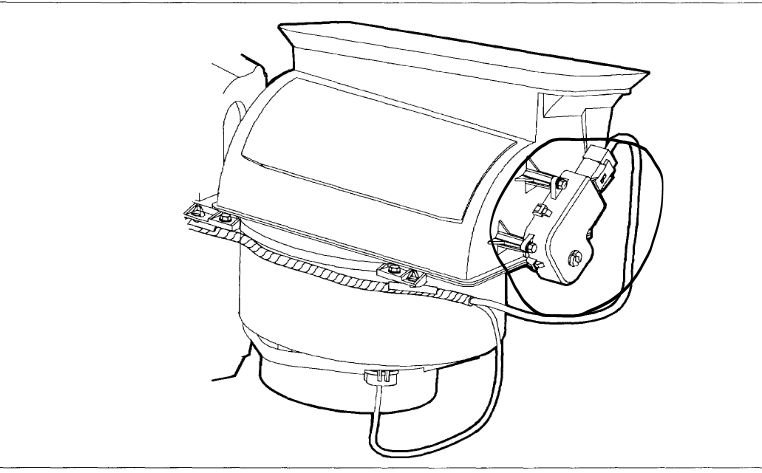

If the compressor engages, then you have enough freon in the system that you should get some cool air. Have you checked to see if the blend air door actuator under the dash is working? Also, do you know the high and low side pressures?

Thanks. I found a small leak in the discharge line. I will be replacing it and will let you if it works. Where exactly is the blend air door actuator?

That's your problem. The Freon is slowly leaking from the system. As far as a blend air door, this vehicle has what is called a mode actuator. It is under the dash, but now that I heard you found a leak, I doubt this is the problem.
I attached a picture for you to see the part.
Let me know if that helps and if you have other questions. Also, let me know if fixing the leak takes care of the issue.,

Well, we thought we found a leak, not so sure now. It was under the foam piece on the hose but after taking off the foam. we think it was just excess from when it was filled. Do you think it's safe to put some Creon with dye in the system? The only thing in the system not replaced was the evaporator, all other components are new. Is there a way to test the blend door actuator?

As far as the blend air door actuator, you would have to check and see if it is moving the door. Here is a link that explains some symptoms related to a bad one and in general how one is replaced:

Would the blend door actuator be bad if the heater works fine? I also see a diode in the fuse box marked A/C diode. If this was bad, would that cause no cold air?

If you can change from heat to ambient temperature, then chances are it is fine. As far as the diode, chances are no. A diode is designed to only allow power to flow in one direction. Even if it is bad, it shouldn't stop power.
