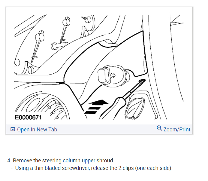

Ignition key lock tumbler replacement?
KEN L
  • MASTER CERTIFIED MECHANIC
  • 55,281 POSTS

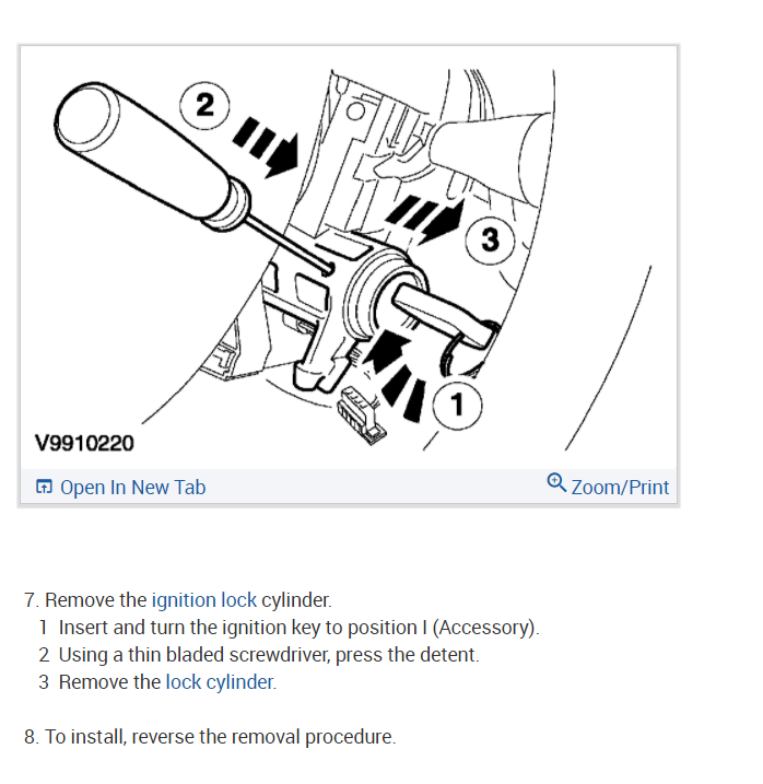

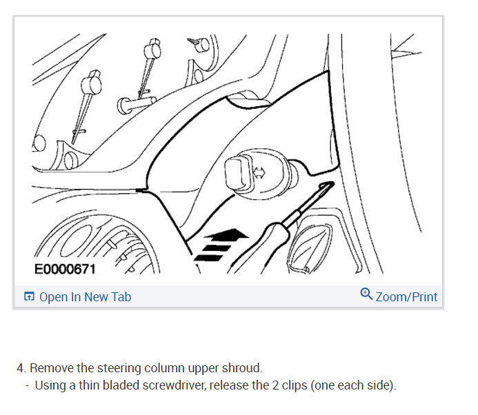

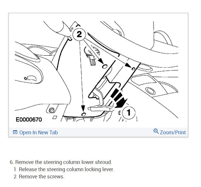

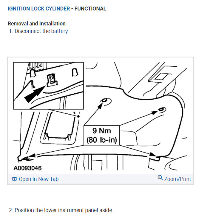

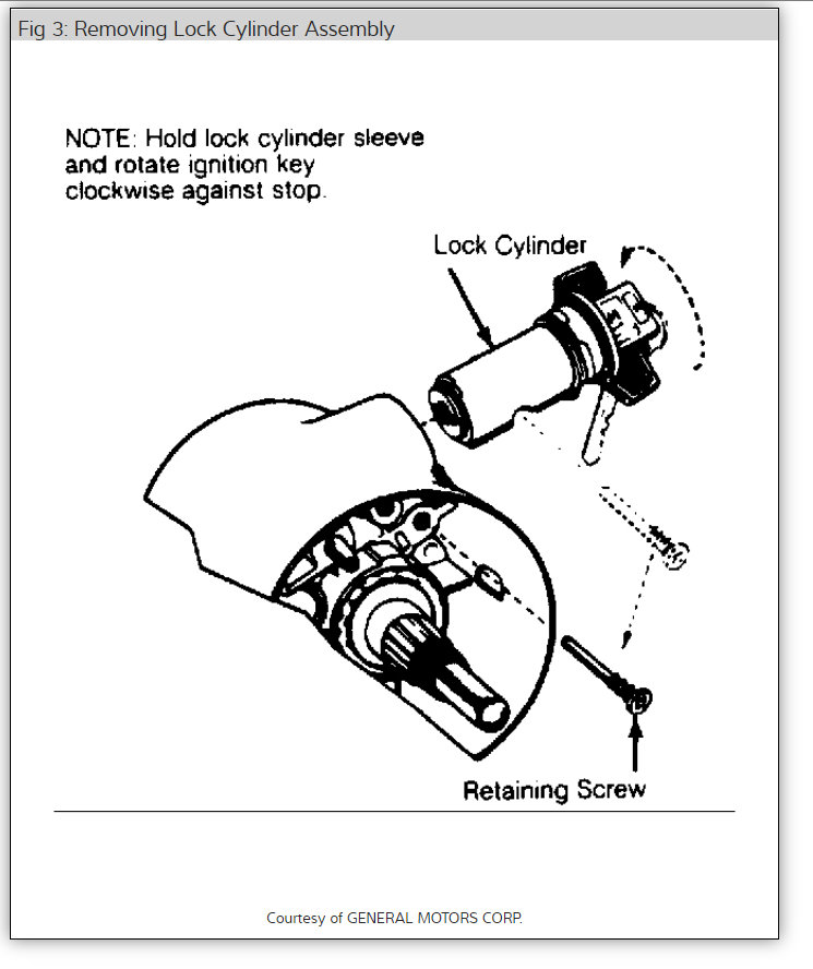

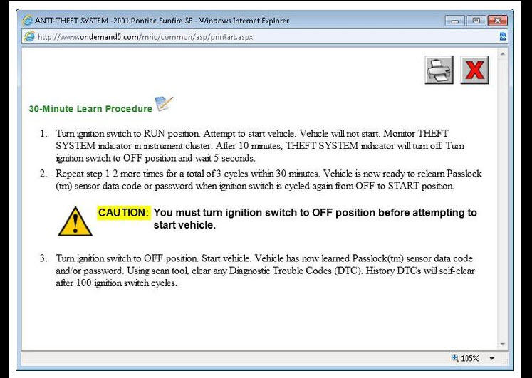

Yep the key and cylinder are worn out. Here is a guide hat will help you remove the tumbler, you might be able to clean it and spray WD40 in it to get it to work again. AS far as the chip in the key the dealer will need to reprogram that for you or you might be able to just have the old key with you and the RF could still work.
Best, Ken

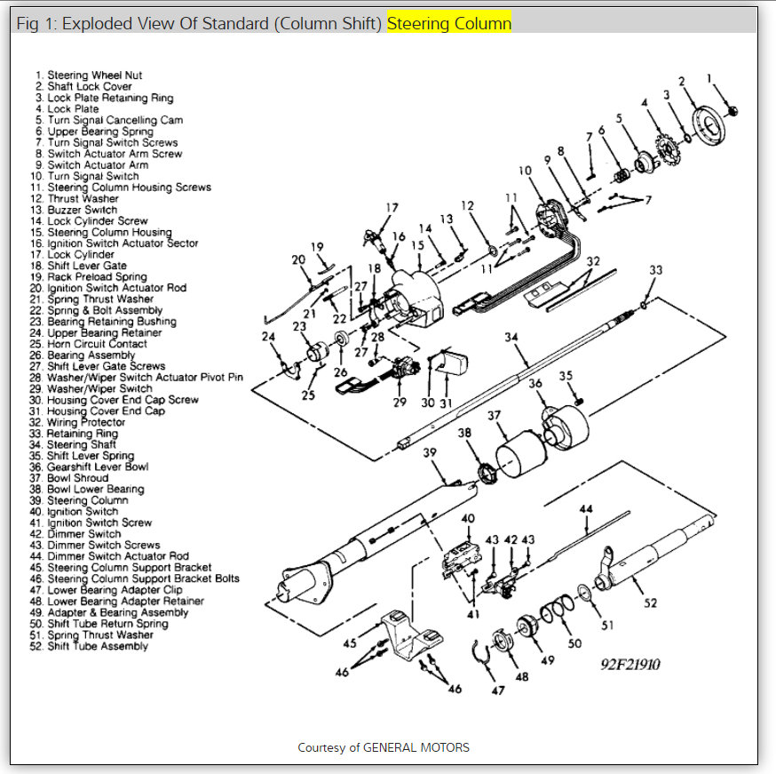

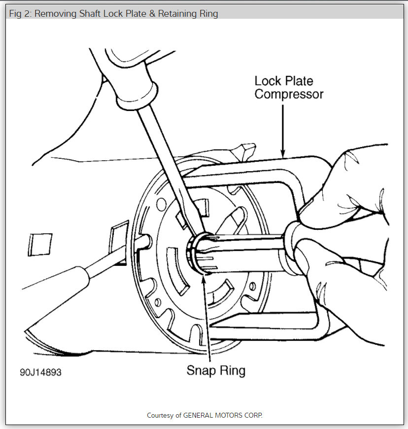

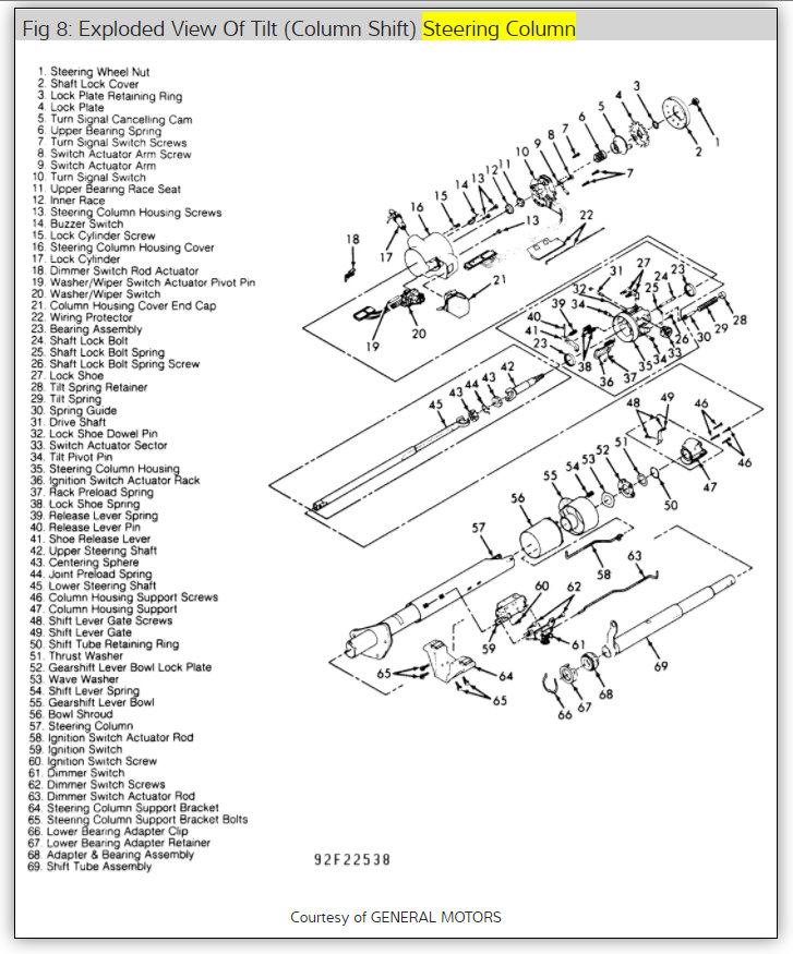

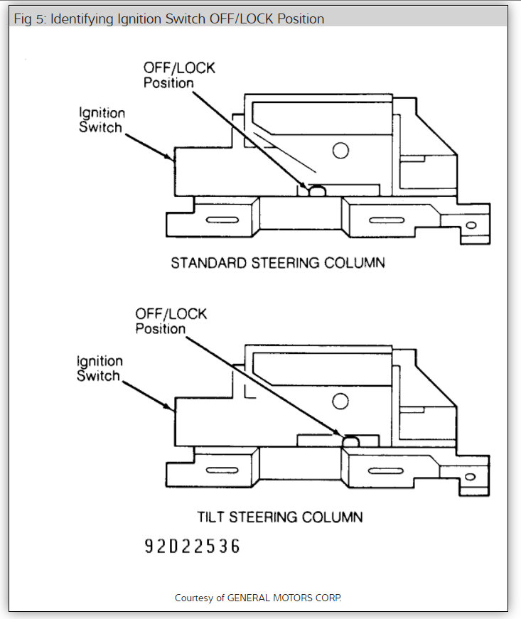

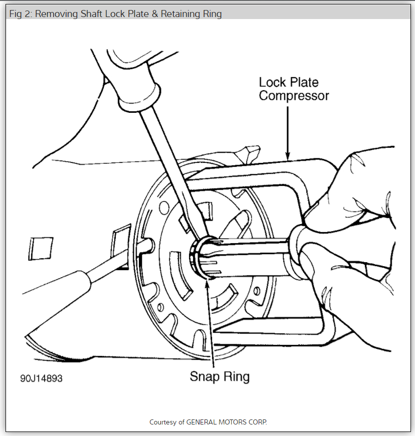

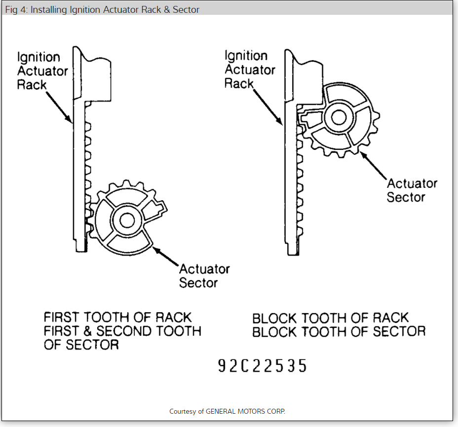

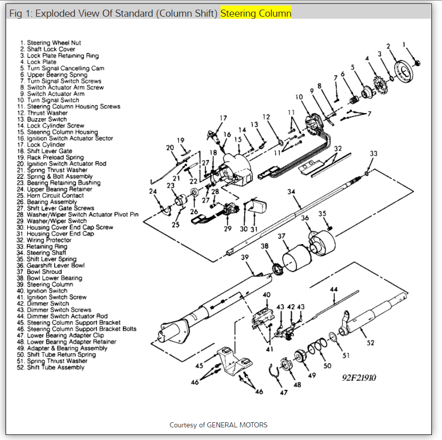

It sounds like the ignition lock tumbler needs to be replaced which is common. Here is a guide to help you step by step with instructions in the diagrams below to show you how on your car.
Tuesday, December 15th, 2020 AT 8:17 AM (Merged)

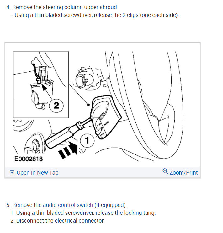

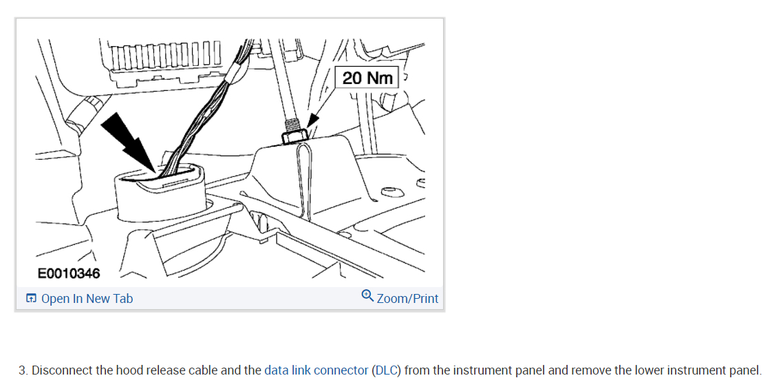

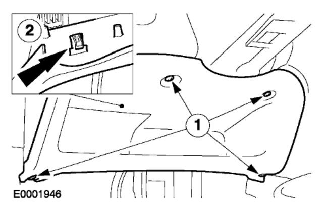

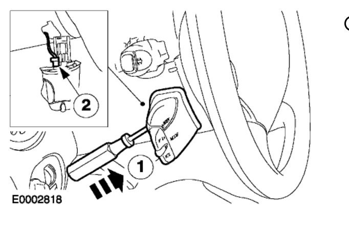

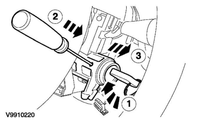

This article supersedes TSB 05-19-11 to update the Service Procedure.
Some 2000-2005 Focus vehicles may exhibit ignition key related issues including difficulty or an inability to turn the key, an inability to remove the key, or (2005 only) the key-in-ignition warning chime continuing to sound even when the key is removed.
Need to remove and replace ignition cylinder
Tuesday, December 15th, 2020 AT 8:22 AM (Merged)
JAKUBLA
Is this a repair that a semi talented lay person can do?
BMRFIXIT
  • 19,053 POSTS
Ignition Lock Cylinder - Non Functional
Removal and Installation
Remove the steering wheel
Remove the passive anti-theft transceiver.
Draw a line through the middle of the ignition lock cylinder face 90 degrees to the key slot.
Mark a point on the line 3 mm (0.11 in) down from the slot which is just beyond the center of the lock face.
Drill a 4 mm (0.15 in) pilot hole 3 mm (0.11 in) deep.
Drill a 10 mm (0.39 in) hole 35 mm (1.37 in) deep.
Remove the lockbar from the side of the hole.
Rotate the ignition lock cylinder while pressing the retainer pin on the housing and pull out.
Use the lock cylinder repair kit (XS4Z-11582-AA) and install the ignition lock cylinder.
With the key in the ACC position insert the ignition lock cylinder.
Turn the key to the OFF position and remove the key.
Install the passive anti-theft transceiver.
