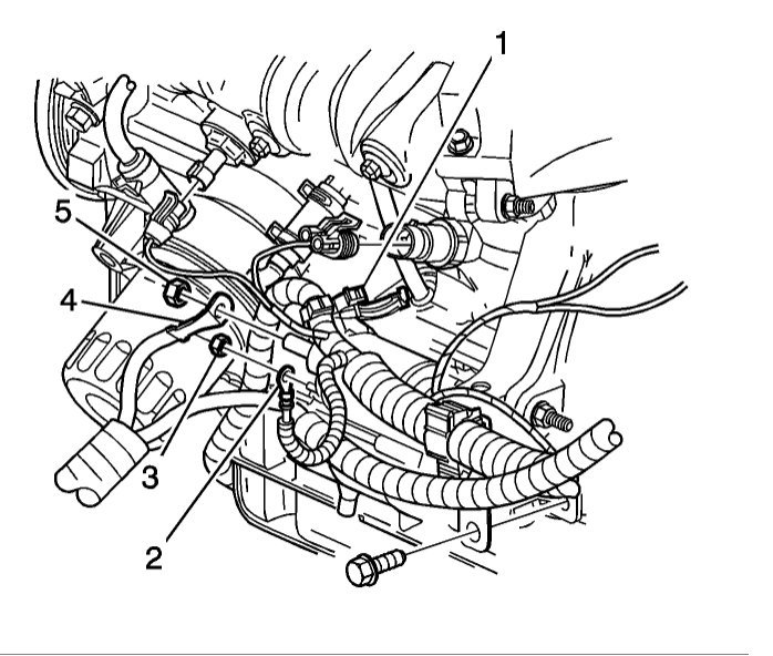

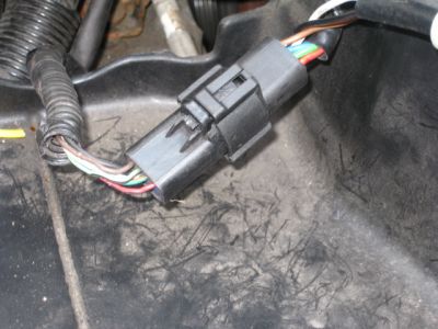

That would be the screw attached to the fender at the top, that is near a strut for the hood? If so, that is the screw I used for ground. That's the one whereby I spliced connections from the wiring harness plug (the part that plugs into the wiring harness for the headlight. It had about 7 wires, and I tried most of em, got sparks most times, and caused the lights to come on good, but without aid of the headlight switch in the car. That one I couldn't figure out. Like i was bypassing the switch, and it worked good, you just couldn't shut it off.
https://www.2carpros.com/forum/automotive_pictures/180565_IMG_0946_1.jpg
If I could add an arrow, I could show you I spliced on the back side, where the thinner wires are. Only one I didn't do was a pure black one, but I assumed it was for the turn signal lights, (white/brown/black wires go to the signal on the light) (Green, Blue, Red go to the headlight) and by then my last splice had fallen apart.

https://www.2carpros.com/forum/automotive_pictures/180565_IMG_0945_2.jpg
This is what I think you mean. Yeah that was tight as can be, and I used that as a ground point to determine continuity and hook-up a new splice for ground. Which then set the lights on, but you couldn't shut em off.

DOCFIXIT
  • 18,828 POSTS
Problem is low and high have two seperate grounds. When you add ground to get bright lights what color wire and is it at that plug in pic? Possible Light Green/Black or Red/Black?

BRAVESTAR1
  • 234 POSTS
There are 3 wires there.
1 is thicker and all black.
2 are thinner one is black with a lime green stripe, the other is plain black.

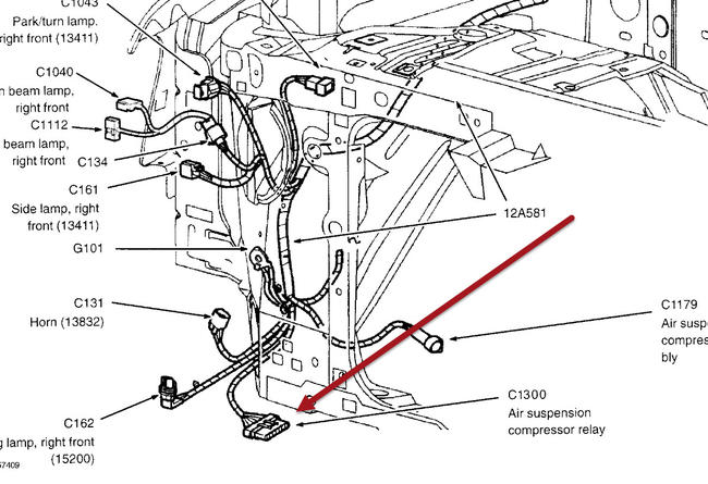

My diagrams show different colors, red/blk goes to the DRL relay, Lt Grn/Blk goes to the multifunction switch and grounds through that, and Dk Grn/Orange, goes to he Battery junction box under the hood and is #19 for the right headlamp, You have DRL, but does it have Autolamps?
Principles of Operation
The headlamps are supplied power at all times from the battery junction box (BJB). Ground is supplied through the multifunction switch and the headlamp switch. The flash-to-pass feature has ground supplied through the multifunction switch.
Place the headlamp switch in the ON position.
Place the multifunction switch in the high beam position.
Do the high beams operate correctly?
REPAIR circuit 13 (RD/BK). TEST the system for normal operation.
For LH headlamp, REPAIR circuit 160 (DB/WH). TEST the system for normal operation.
For RH headlamp, REPAIR circuit 161 (DG/OG). TEST the system for normal operation.
