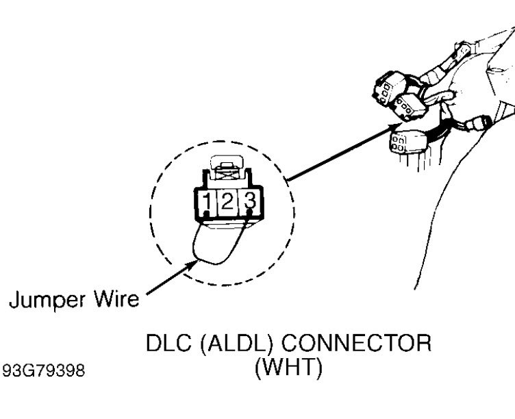

Nope see pic for aldl which is behind lh kick panel count flashs each will flash 3 times 1 then 2 +code 12 which is normal. Any other code get back to us your blet could have slipped but I kind of doubt it as when a water pump is installed is usually a timing belt kit which includes new tensioner/pulleys /water pump

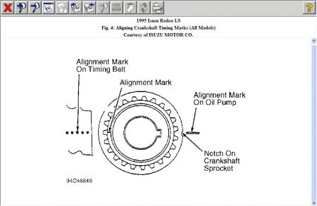

How do u check and adjust the timing? Just replace the head gaskets, got it all put back together and now it wont start. Fires up with starter fluid but dies when the fluid burns up.
Saturday, June 20th, 2020 AT 10:37 AM (Merged)

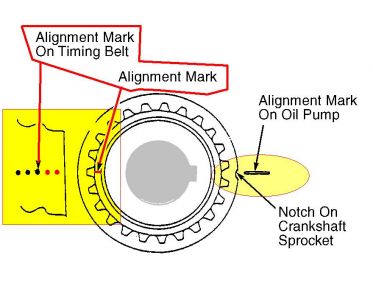

BLUELIGHTNIN6
  • 16,542 POSTS
Ignition timing is controlled by PCM. ensure timing marks on belt are aligned properly. The timing belt on the 3.2 SOHC does not get installed at tdc#1 the crank pulley has a half moon cut-out that positions at 3oclock and the slots on the cam pulleys point at raised dots on the rear cover
https://www.2carpros.com/forum/automotive_pictures/261618_Graphic_687.jpg
TXGIANT31
  • 6 POSTS
Which way do I turn the pulley? The info was very helpful! Thank u!
BLUELIGHTNIN6
  • 16,542 POSTS
The timing belt should have arrows of the correct direction, crank turns clockwise
TXGIANT31
  • 6 POSTS
Thanks! U have been a big help!

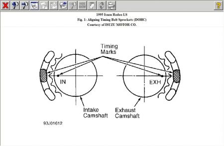

VOIGHTSL
  • 1995 ISUZU RODEO
1995 Isuzu Rodeo Question 6 cyl
My Timing belt blew while driving. We followed the Haynes book and replaced it. I lined up the Came shaft marks to the cover. The Crank Sprocket to it's marks. After putting it all back together. It won't start. It turns over but now the intake butterfly valve pushed air out instead of sucking it into the engine. Is the timing off? I ensured the # 2 Piston was TDC. Could something else be wrong Or was it operator Error (ME). Any help would be gladly appreciated.
Thanks.
  • 75,992 POSTS
Put the engine no.1 piston on its compression stroke/TDC then line all the timing markings
What is it a SOHC or DOHC 3.2L
+1
VOIGHTSL
Thanks,
DOHC, The book says No 2 Pistion. Should I do it on No 1. Willthat damage the engine?
  • 75,992 POSTS
J
https://www.2carpros.com/forum/automotive_pictures/12900_cam3_2.jpg
ust set all the timing marks as you see below.
https://www.2carpros.com/forum/automotive_pictures/12900_cam_2.jpg
https://www.2carpros.com/forum/automotive_pictures/12900_cam2_2.jpg

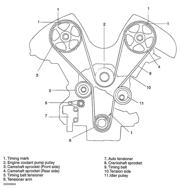

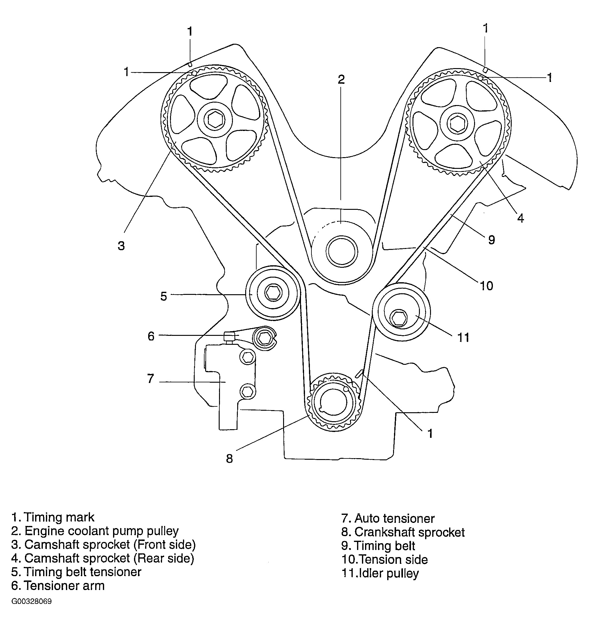

HOLLOWAY
  • 1994 ISUZU RODEO
  • 6 CYL
  • 2WD
  • 119,000 MILES
I'm doing a water pump on a 1994 Isuzu Rodeo, V-6. I got it in, but I had to pull the timing belt to getr to it. Now its out of time. I know I need TDC on the #1 cylinder, my quesion is, is that only gives me one side. I have to time both camshafts together with the crankshaft, and I just don't know how to do it. Any advise would be greatly appreciated. Oh, and I struggled really badly at getting the belt back on. The tensioner seems to be sticking or something i'm doing is incorrect. That advice would help tremendously too !
Saturday, June 20th, 2020 AT 10:38 AM (Merged)
BMRFIXIT
  • 19,053 POSTS
You should use a new belt
and the new belt should have marking on it it goes with relation to the pulleys
like in this one note the dots
https://www.2carpros.com/forum/automotive_pictures/99387_belt_2.jpg
