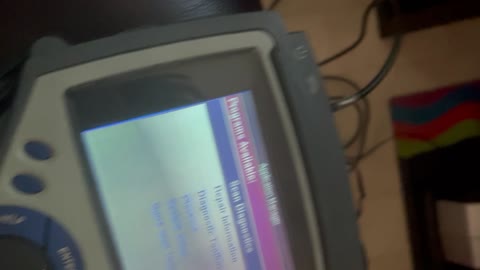

Hey there! I did attempt to upgrade the scanner to the 2007 but the computers are not recognizing the scanner despite purchasing a few retro items to accommodate the update. The internet upgrade doesn’t seem to function either. Do you know of an alternative way to get it to update?
Tuesday, June 3rd, 2025 AT 12:54 AM
STEVE W.
  • 15,671 POSTS
It's been a while, but I seem to recall that to do the updates you loaded the software onto the computer, then updated the application on the computer then used that to update the memory card using a card reader. Then you plugged the memory into the tool and used the card to activate it.

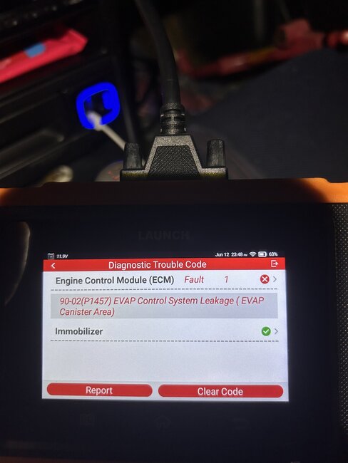

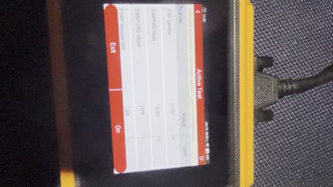

Hey there! I Had returned the unit before the window to do so closed. I only had a month. I went on ahead and went for a more modern scanner. I have a 2025 LAUNCH Creader Elite V2.0 for Honda and Acura.
It did detect the P1457, and also let me do the active solenoid tests. I attached a video but here is what happened for each test:
1. PCS(CPV) On, CVS On And BPS On - FTP Sensor value fluctuated. It almost filled like the engine was bogging down while all were engaged.
2. PCS(CPV) Off, CVS On And BPS Off - FTP Sensor fluctuated slightly. No noticeable difference in idling.
3. PCS(CPV) Off, CVS Off And BPS On - FTP Sensor stayed steady. No noticeable difference in idling
I’m uncertain what the other metrics meant, but the check engine light has not fully come back on.
Thanks for your continued help!
Thursday, June 12th, 2025 AT 10:33 PM
STEVE W.
  • 15,671 POSTS
Well looking at the video and the tests I would say the issue isn't the purge or vent solenoids or the canister. However, there are other parts that you can't really use a scan tool to test. Like the fuel filler neck, the pump and the lines. That first test showed that the purge will open and pull a vacuum (that is why the voltage dropped on the FTP) It also showed that your vent solenoid seems to work. The bogging was the very rich fuel mix being pulled through the purge system. The last test will normally only show anything if you wait a while as it should show the FTP rising from the fuel in the tank warming up. I believe the solenoids and valves are not the issue. That leaves things like a small leak around the fuel pump, a small leak in something like the filler neck or vent line. Testing those would need a smoke machine and a quite place to work with no breeze. There are a few of them you can build out of a paint can and a BBQ regulator if you want to DIY. You don't get the fancy features, but they do work. The hard part is usually finding the tiny leak.

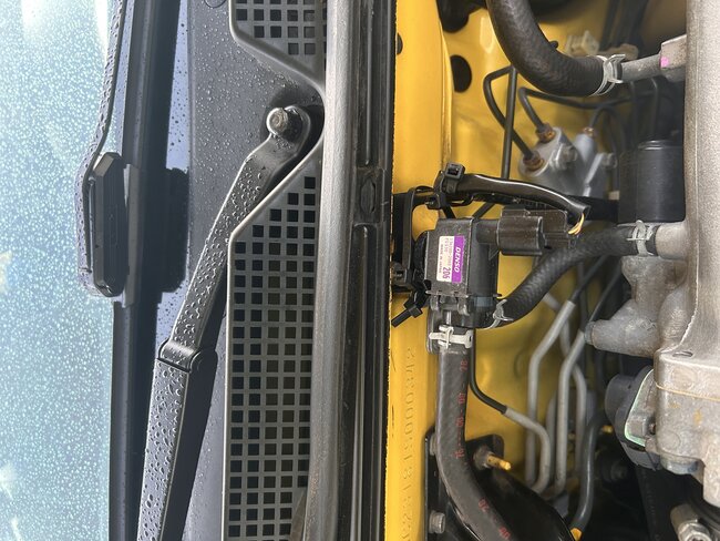

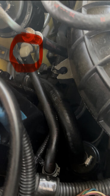

I just smoked it again and see smoke is coming from the top of this hose, but I don’t know where it connects to and not sure if normal for smoke to pour from it.
Friday, June 20th, 2025 AT 5:36 PM
STEVE W.
  • 15,671 POSTS
Check the connection itself for cracks. If you want to see the smoke better use a bright hand light with the lights off. That usually lets you track the smoke easier. A way to drop the pressure would be to open the machine and connect a BBQ regulator in the airline. That would drop it to a half of a PSI.

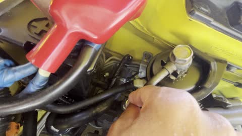

PACMANTYPER
  • 54 POSTS
I will be picking up the regulator this weekend, but I was able to do another short test.
I found that where the smoke was coming from is a vent tube meant to be open to the atmosphere. I plugged it during the duration of the smoke test (about 30 seconds) and saw no smoke anywhere from the canister area
Once I get the regulator, hopefully I can run the smoke test longer with no fear it will damage the system. Should I keep that vent plugged when I smoke it again with continuous smoke?
Friday, June 27th, 2025 AT 12:35 PM
STEVE W.
  • 15,671 POSTS
That tube is likely the canister vent. Your scan tool should be able to close the valve it has for that. If you turn it "off" so the vent is closed and still gets smoke out of it, the valve is bad. It may turn on and off, but it isn't sealing.
