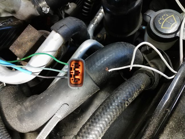

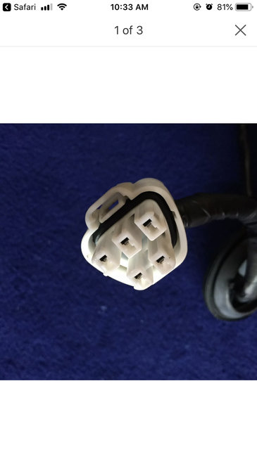

VICTORGOLD
  • 6 POSTS

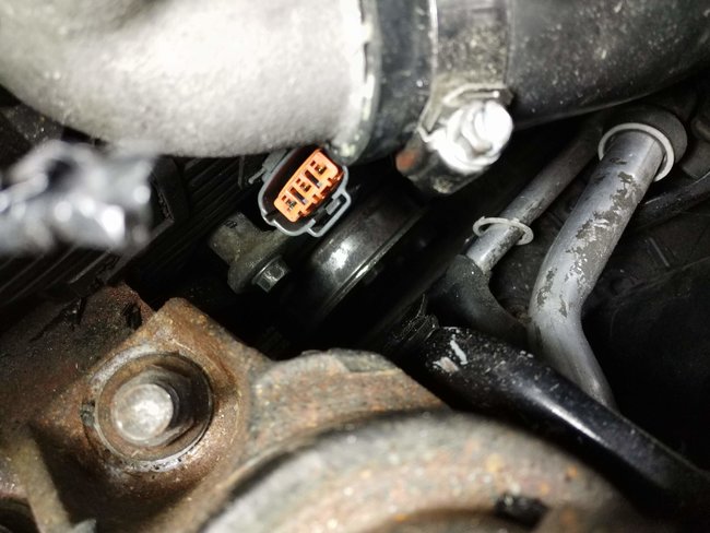

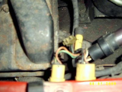

There is no check engine connector located anywhere near the fuse box. I searched the underdash area and the engine compartment and all I could find in the way of available connectors are the two shown in the attached photo which are located in the left underhood area close to the ignition coil. Neither has anything on it that identifies the contacts. The larger has three wires entering it and the smaller has two wires. Is either of these the check engine connector?
Wednesday, December 9th, 2020 AT 8:56 AM (Merged)
  • 75,992 POSTS
It should be in the engine compartment you are on the right track the terminals is in the gray small box close to the coil-so much of repair manual accuracy The photo is the check connector where you can jump batt to fp to fire up the fuel pump

VICTORGOLD
  • 6 POSTS
Hello again,
I couldn't find anything that could be described as a gray box near the coil. I did find two grommets on the inner fender where the two round connectors, shown in the earlier photo, seem to store. There is a squarish yellow connector with two conductors shown in both attached photos. could this be the "check connector"?
https://www.2carpros.com/forum/automotive_pictures/385694_1985_Toyota_4_Runner_underhood_with_two_connectors_mounted_in_grommets_1.jpg
https://www.2carpros.com/forum/automotive_pictures/385694_1985_Toyota_4Runner_underhood_showing_2_conductor_connector_1.jpg
  • 75,992 POSTS
I'm using the Haynes manual for reference on location-Try checking behind fuse/relay block no.2
