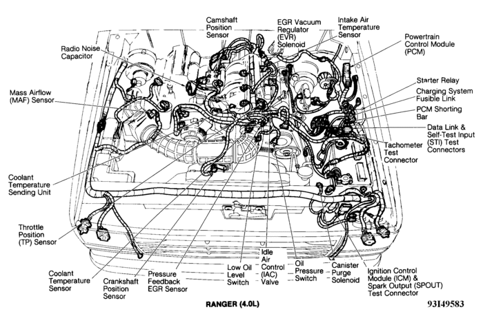

Wrenchtech uses a different reference that we do. A better one. According to both references, Pin 22 should be light blue/orange, and be the fuel pump negative enable. For the 4.0 liter engine. Our reference shows the same thing for the 2.3 engine as well.
I understand but pin 22 is white and my pcm is round like a circle and.pin 21 is the color ur telling me and it runs to pin 85 on fuel pump relay
Apr 5, 2012 at 11:30 AM
You're not even looking at the right module.
Apr 5, 2012 at 12:21 PM
Then where is it rivermike rat sent me a diagram it said by the brake booster on driver side on firewall
Apr 5, 2012 at 12:56 PM
Wrenchtech, Mit1 is showing his PCM by the brake booster. What's AllData say about it?
Apr 6, 2012 at 3:28 AM
Yes, that's where it is but he's still testing the wrong module.

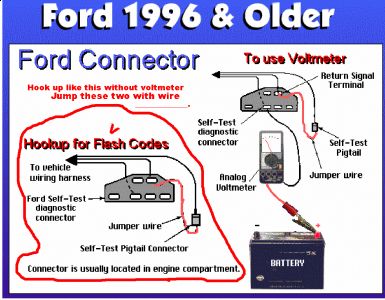

We need to see if any codes are stored in the PCM do it this way:
Jump the two termnals shown together and turn key to "ON" and count the flashes... a 22 will flash as 2 flashes then a short pause, then 2 flashes, if more than one code is stored, the pause will be longer. The codes will display three times and end with 11 or 111. Write them down and post here. First do this with the key on engine off, then again with it running.
