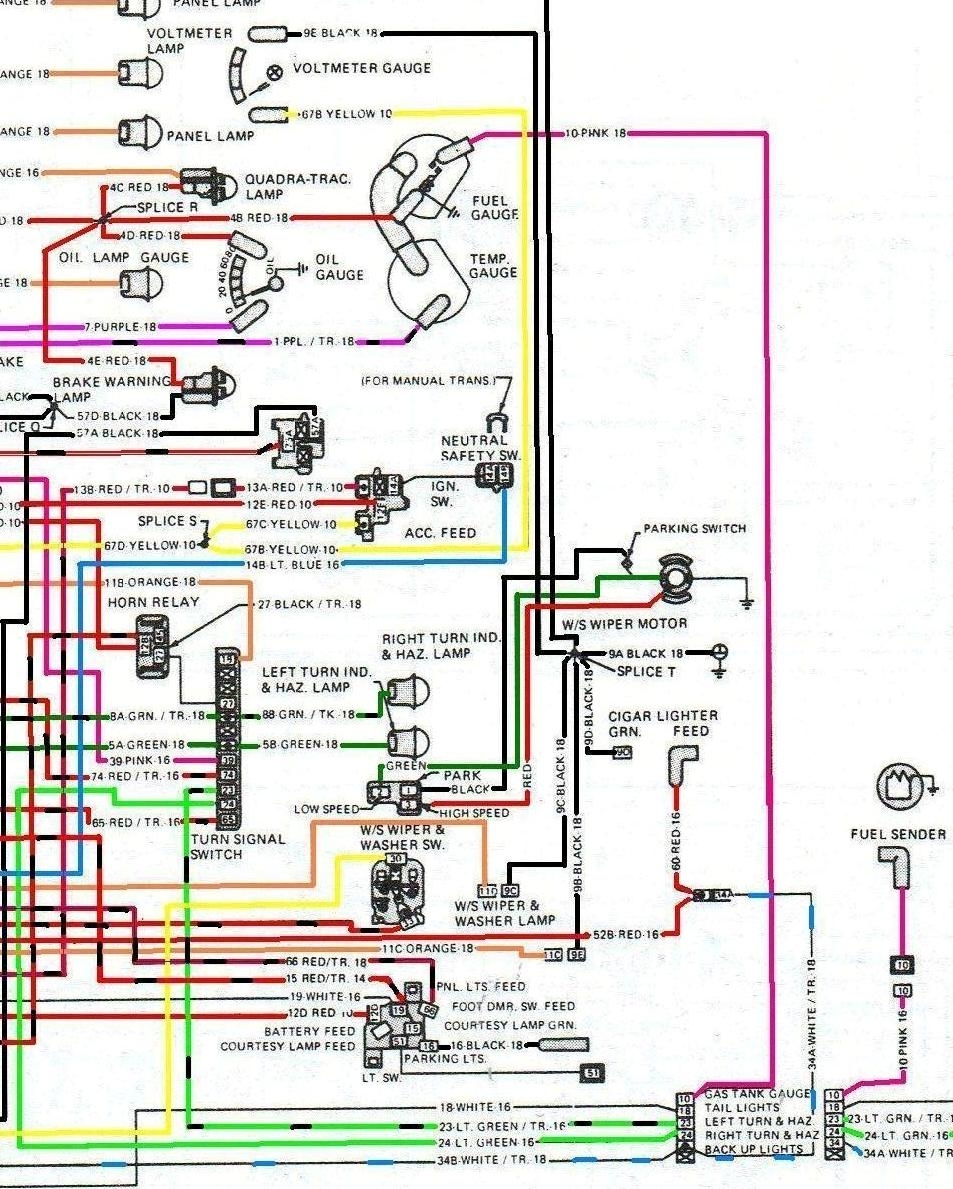

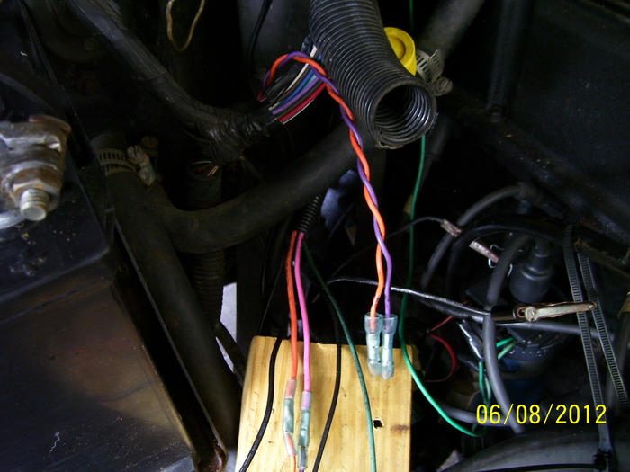

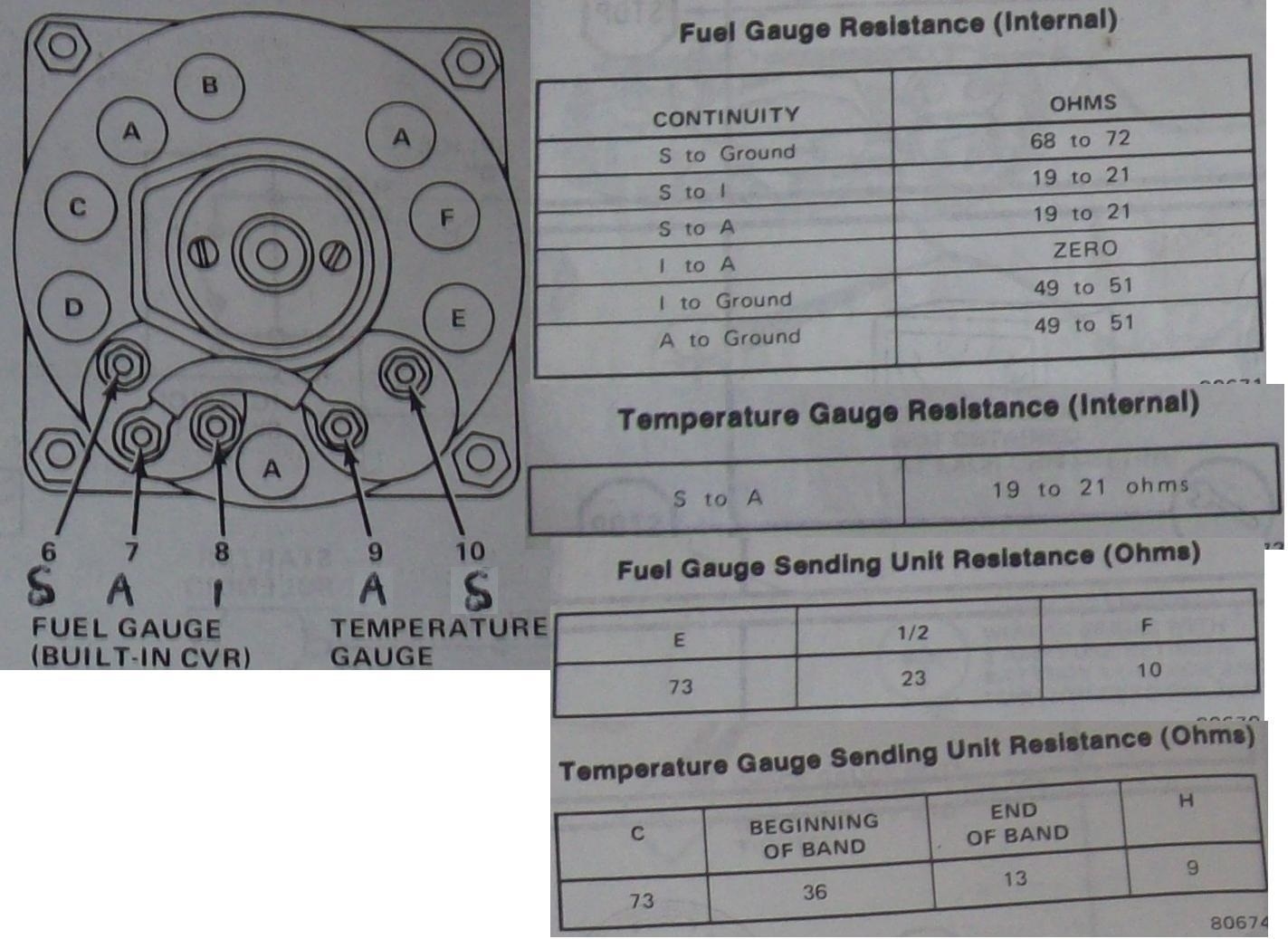

So, this solution seems really not to work for me. I thought it was working okay before I took my Jeep in for a Rear Main seal last month. Now, I see the following: the fuel gauge stays always at just under 1/2 a tank. No matter how much gas is in it. The temp gauge starts at about 1/3 warm and then goes way up when the jeep heats up. My mechanic checked the actual temp and it's fine. Any ideas of what could be messed up here? Possibly need a better ground? Since both gauges are acting up, I'm curious for input. Thanks. Mark

We are assuming things are hooked where they should be.

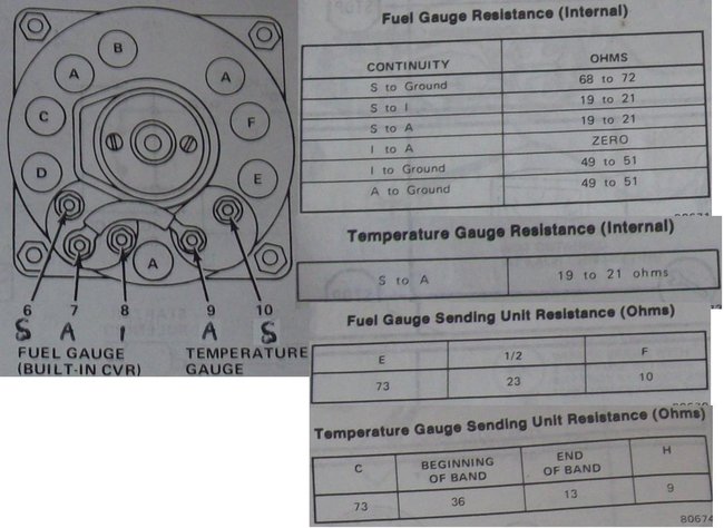

Lets unclip the wire on number 6, it should be a pink wire. Is it pink?
(it is the sender, all the way from the tank)
Gear shift in neutral wheels chocked
Turn on the key to "on"
Did the fuel gauge do anything?
With an alligator clip jumper, clip onto the female of the wire you just removed. Ground the other end of jumper to a good ground
The fuel gauge should rise to the top. Does it?
Fix everything back
While we are at it do the same for number 10, the temp gauge sender
This wire should be purple. Is it?
Let's ground that wire too, the gauge should rise to, and maybe past the top.
Okay, put everything back and post your results.
Depending on your results, I may be able to focus on a direction to continue on with.
I'm not exhausted yet!

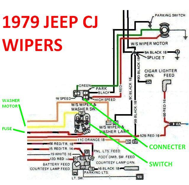

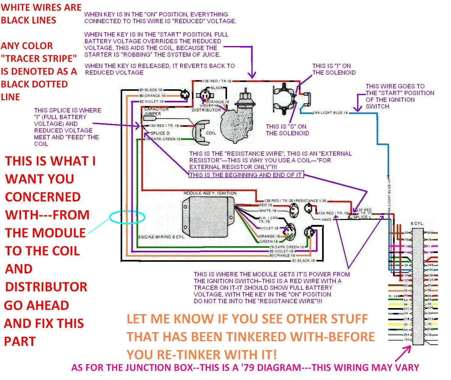

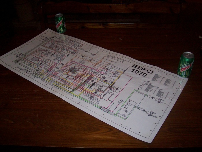

2nd diagram upper right side displays the wiring to the speedometer gauges. The rest of this diagram is for a 1979 some may not apply to your year. The dashes I place on wires denotes that it has a tracer stripe the stripe colors were not denoted in the legend

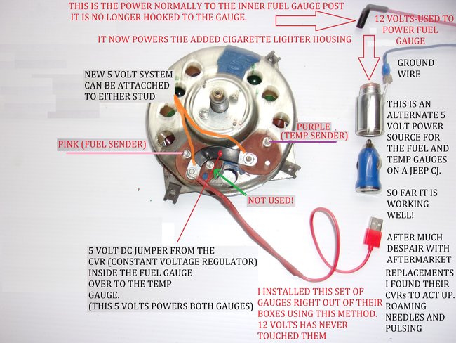

Took me a while to get back to this. But I did finally get the dash off again. I got some strange results. I verified that the gauges peg properly when power is applied. Then, I rewired them properly with the 5v transformer and tested and both seemed to work just fine. The only thing is that the battery of the car was nearly drained out since it had sat for over a month. Anyway, got the battery charged and the Jeep started up and the gauges worked momentarily then both went way down to the left. I'm guessing that the transformer I got is not putting out the right Voltage. I'm going to try a different one and see if that makes any difference. Will update here once I do that.

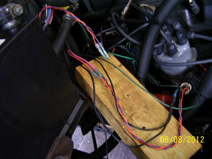

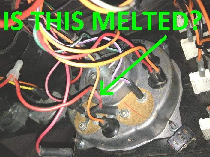

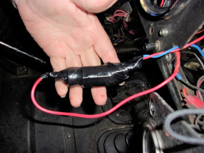

Here's my Blob---goes behind the Dash.
Not sure how you hooked yours up,
Any kind of oops! Might be fatal to the gauges!
If you are unsure of something, before you just "Go for it", Maybe I
can explain better or a different way.
The Medic
Tuesday, November 9th, 2021 AT 4:53 PM

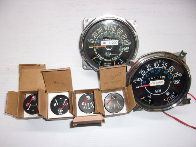

I just read back through
Temp gauge runs backwards?
See how I introduce 5V to the fuel gauge---jumps to the voltmeter with the original jumper.
The Fuel gauge sender wire is pink
The temp gauge is Purple.
Over the years, the gauges may have been changed to aftermarket stuff

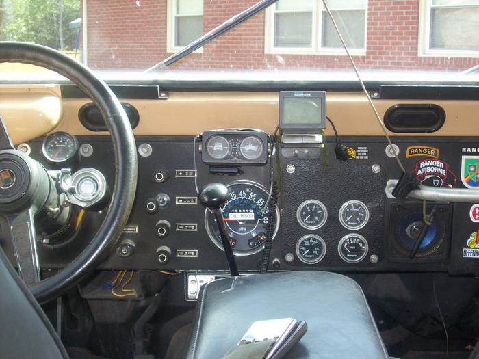

Here's 2 of mine, like the originals, the "zero" for both gauges is all the way to the left---the ones in the boxes too (one is upside down)
Some aftermarket stuff the "zero" is the the right---they travel backwards from the way the originals do (cold and Empty are on the right)(Hot and Full are on the left).
I have not ever installed those types----Without their instruction sheet to go by, they might have the posts reversed in their back side.
Experimenting by playing "Musical Wires" with any of your gauges (even for a split second) most likely will leave you with a sad face!
