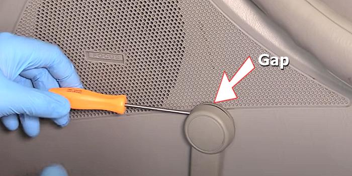

There will be a plastic washer that sits between the window crank and door panel. Start by using a small standard (flat blade) screwdriver to help open the gap which will expose the retainer C clip.
window crank washer gap

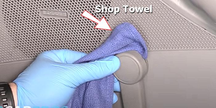

Now, insert a shop towel between the window crank and the plastic washer as in the image below.
shop towel between window crank

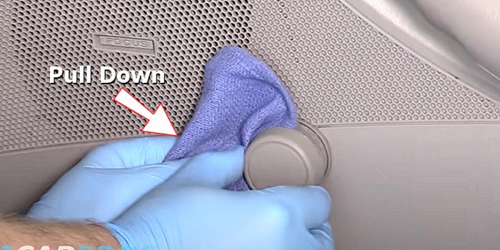

While holding the window crank, pull down on the shop towel this will cause the fibers of the towel to grab the C retainer clip and remove it from the crank handle allowing the removal.
pull down on shop towel

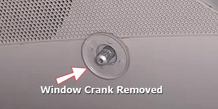

Here is what it looks like with the window crank removed, at the same time you can see the plastic washer or spacer

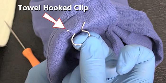

This is how the towel works behind the scenes, you can see how the towel grabs the C retainer clip.
towel hooked clip
In this image you can see the C retainer clip installed, this gives you a better idea on how the removal works, note that the clip can be installed in either direction, so if the towel trick doesn't work one way try the opposite direction.
c clip installed on window crank
