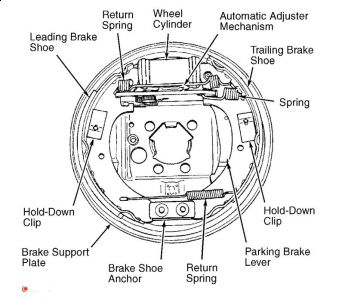

What is the schematics on the drum breaks of a 1999 Plymouth Breeze?

An exploded view?
Just do one side at a time and look at the other side if you have assy. probs.

I edited it to show a diagram.
