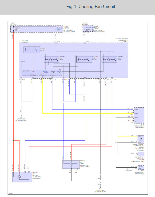

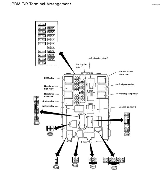

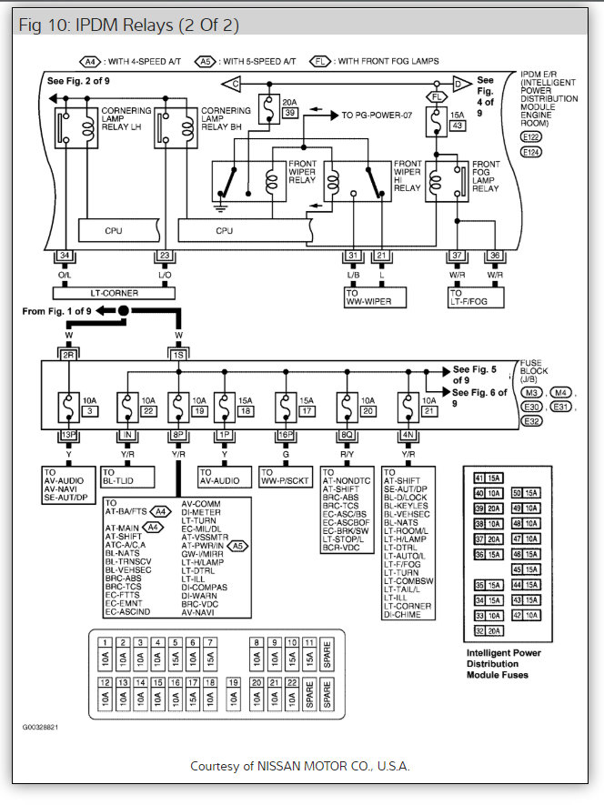

I have a '04 Nissan Maxima..Still trying to isolate the following problem:
The car started overheating at idle and the A/C started blowing warm air at idle also. I found that BOTH radiator/ac fans are not working. My local Nissan dealership suggested that the fan assembly could be bad but I find it hard to believe that BOTH fan motors went bad at the same time. I started thinking the problem could be a fuse or relay.
I looked up a diagram and I found that there are 3 cooling fan relays. Why are there 3 relays to only 2 fans? Whats the 3rd relay for? Do you think this is the likely problem? I'd figured i'd start with the relay since it is the easiest.
thanks for your help!

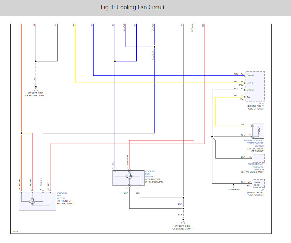

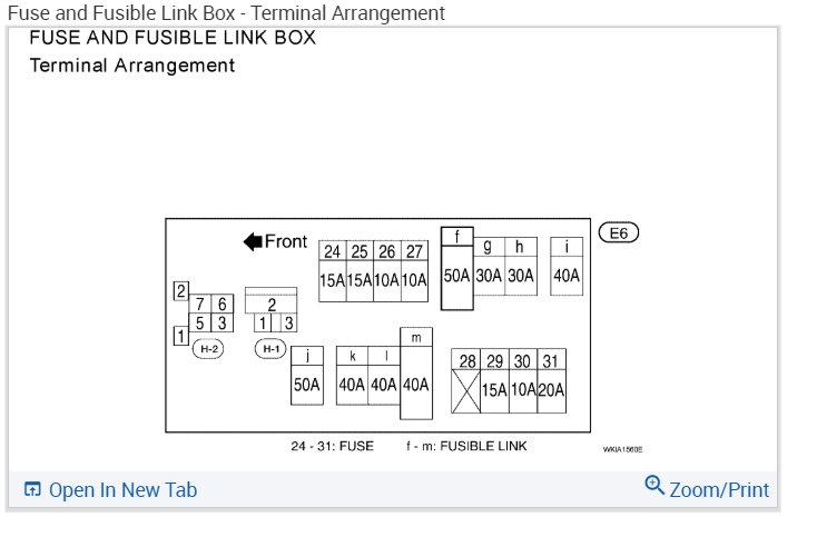

There are 3 fusibles that need to be checked as well as three relays here are guides to help with both with the relay locations and the cooling fan wiring diagrams so you can see how the system works below.
and
Check out the diagrams (Below). Please run this test and get back to us.

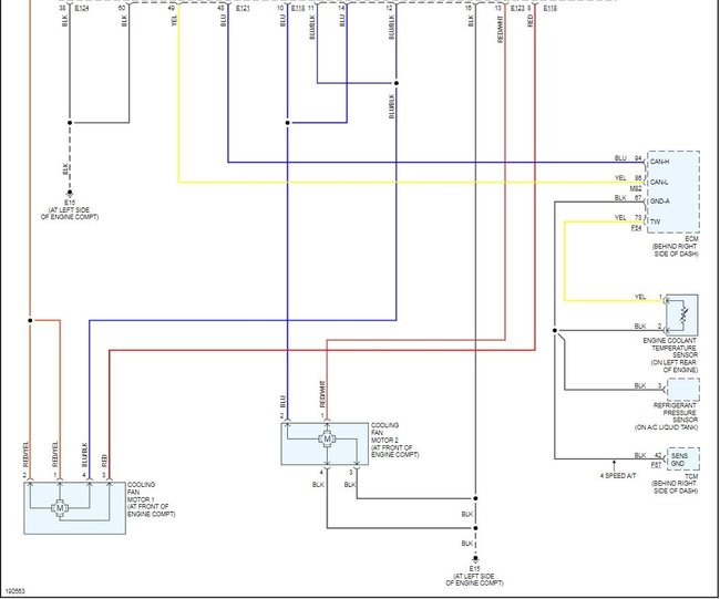

For electrical testings you would at least need a test light or DVOM. To test the fans, disconnect the fan connectors and ground one terminal while applying battery voltage to the other but this fan should have 4 terminals so you might make a mess out of it.
Get a DVOM or testlight first because to test the fuses or relays and their terminals you need to know if battery voltage is present.
Heres a guide on how to use a test light and a DVOM
Attached below are the wiring diagrams for you cooling fans

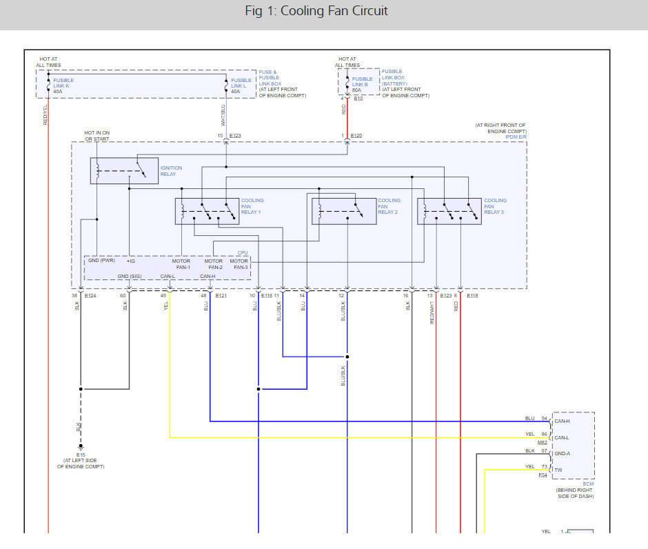

I have a '04 Nissan Maxima, both radiator fans stopped working at the same time. I started thinking its possibly a fuse or relay since both fans stopped working. I contacted the parts dept. of my local Nissan dealership and they didnt list any fan fuse or relay for it (which i find a bit odd).
I find it hard to believe that both fan motors went bad at the same time..Any suggestions of what else it could be if there isn't any kind of fuse or relay for the fans?
Thanks!

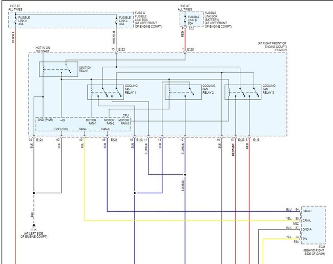

I dont know what they are talking about because there are 3 relays that run the system here is a guide to help you test the relays.
Here is the wiring diagrams for the fan and the relay locations.
Check out the diagrams (Below). Please let us know what you find. We are interested to see what it is.
Cheers
Mar 27, 2019 at 6:22 PM (Merged)
DHORNB1
  • 10 POSTS
It was the relay thank you so much I love this site :)

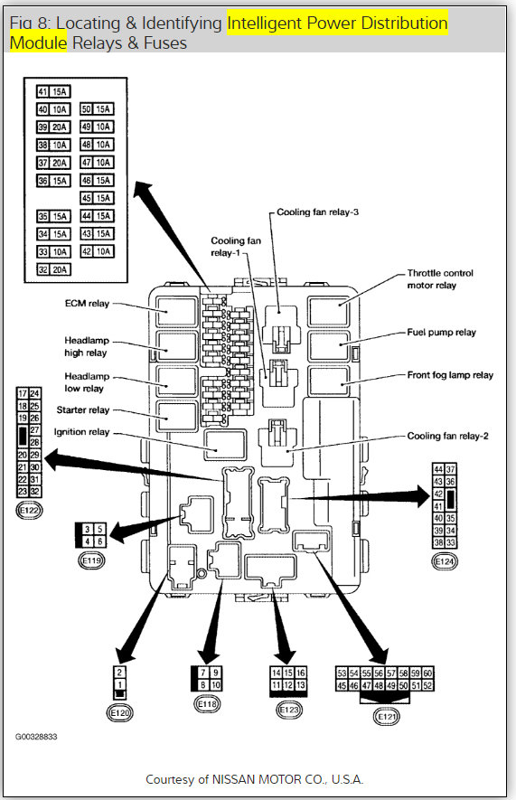

Sorry, for delay in responding. Ok, do you know the location of the Radiator Fan Relays? They are located in the Relay Box on drivers side in engine compartment... You will need to check them... Here is a diagram...
https://images.2carpros.com/forum/automotive_pictures/188069_89maximaRadfanrelays_1.jpg
Check out the link below for relay testing.... https://www.2carpros.com/how_to/how_do_i_check_a_relay.htm If relays test good then try straight wiring from battery to fan plug. .
