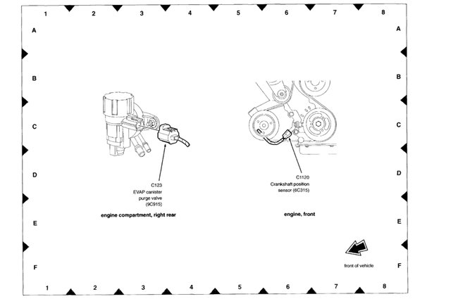

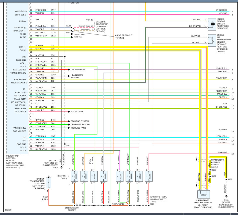

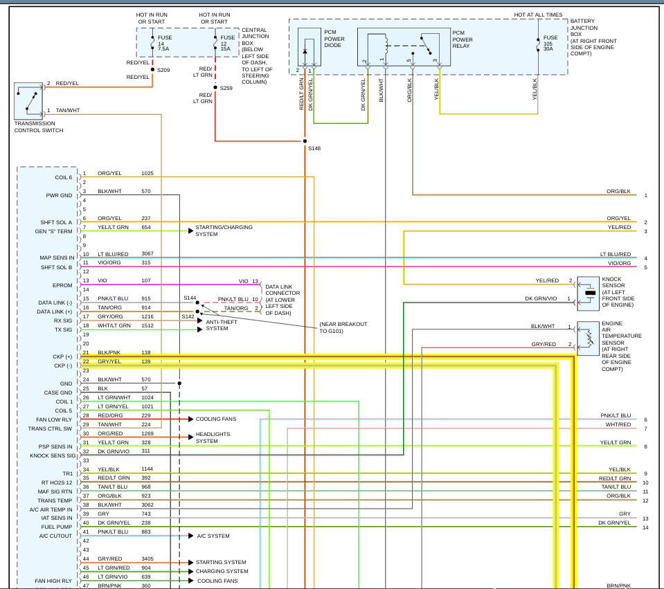

MIKECHOATE
Took my car to car wash and I pressure washed under the hood at the car wash.. drove car home ran great.. next day go to start car cranks over but does not start. The fuel switch in the back trunk has been reset.you can hear fuel pump kick on still won’t start. I’ve checked all fuses no issues looked for access water on all components all good. please i am needing some help.
Feb 22, 2021 at 8:05 AM (Merged)
SCGRANTURISMO
  • CAR REPAIR CONTRIBUTOR
  • 4,897 POSTS

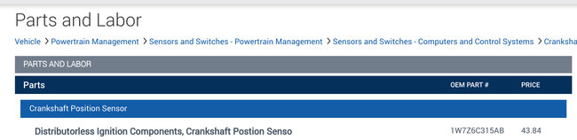

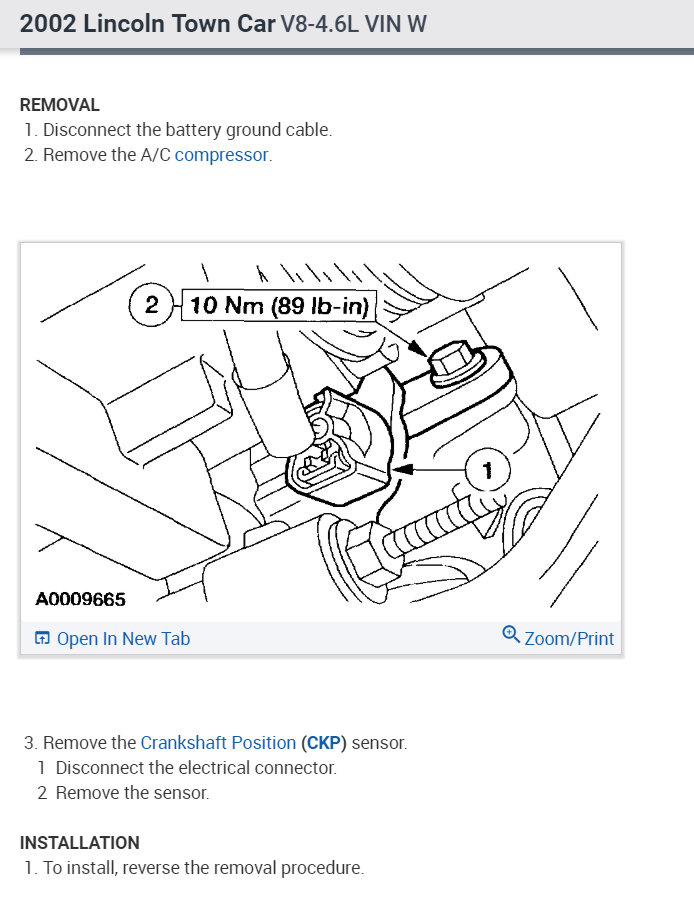

This could be a problem with your vehicle's Crankshaft Position Sensor[CKP]. In the diagrams down below I have included the Power-train Management wiring diagrams for your vehicle with the CKP wires high lighted for you, the location of the CKP, and the Original Equipment Manufacturer[OEM] part number of the CKP for reference as well. Here is a generic guide explaining how to replace a CKP below:
Please replace the CKP and report back with how everything turns out.
Thanks,
Alex

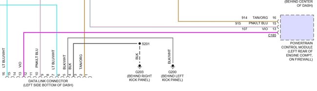

RUVIE TUESDAY
  • 10 POSTS
Thanks for responding so quickly. I haven't ran a scan because I don't have a reader. The car is in my driveway and the closest auto store that will scan is five miles away. Do you think the ignition control module ( in the steering column) would cause a crank no start?
Feb 22, 2021 at 8:08 AM (Merged)
RUVIE TUESDAY
  • 10 POSTS
So I got a computer it says error can not communicate I one bye one upluged every single connection and ran the scan still can't communicate . Any ideas?

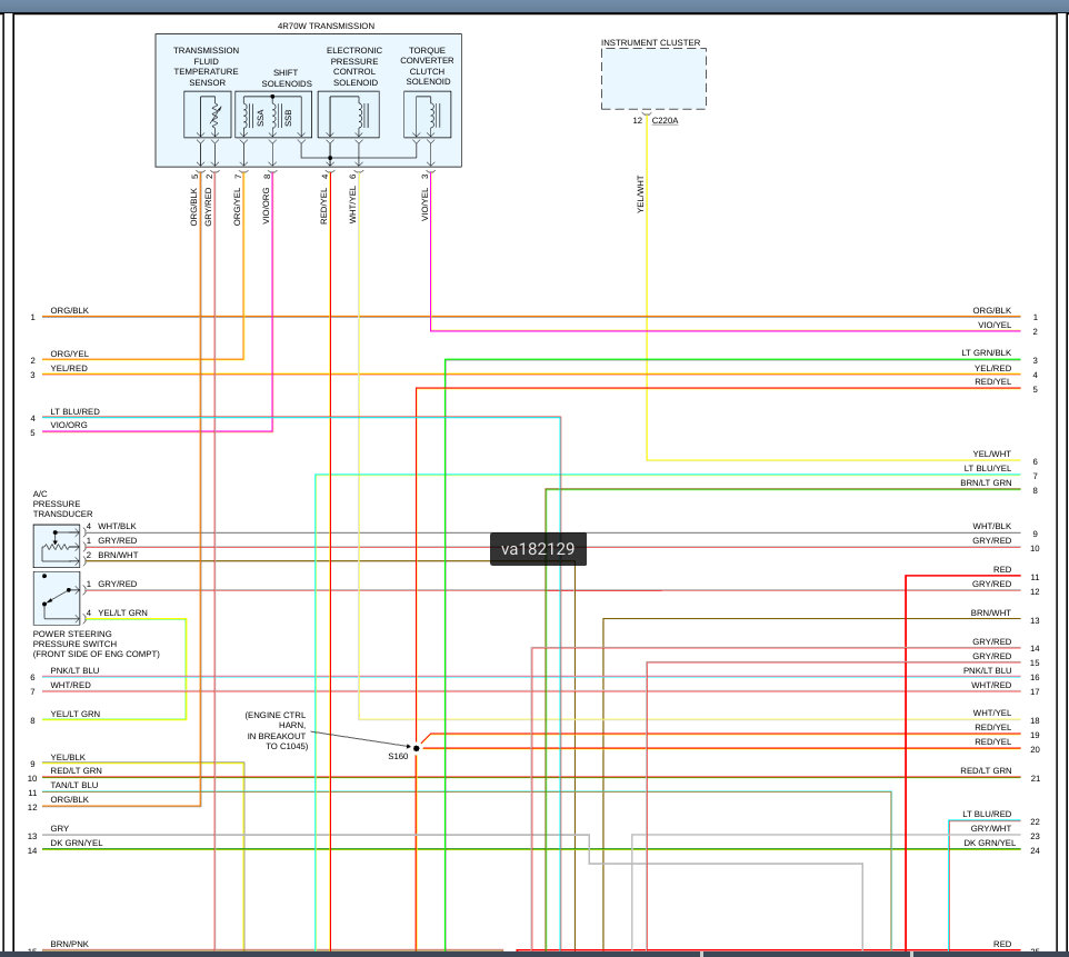

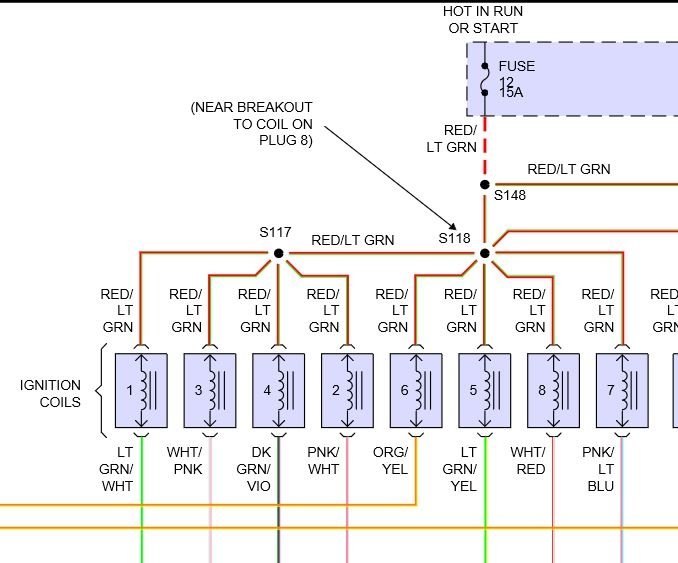

PATENTED_REPAIR_PRO
  • 1,853 POSTS

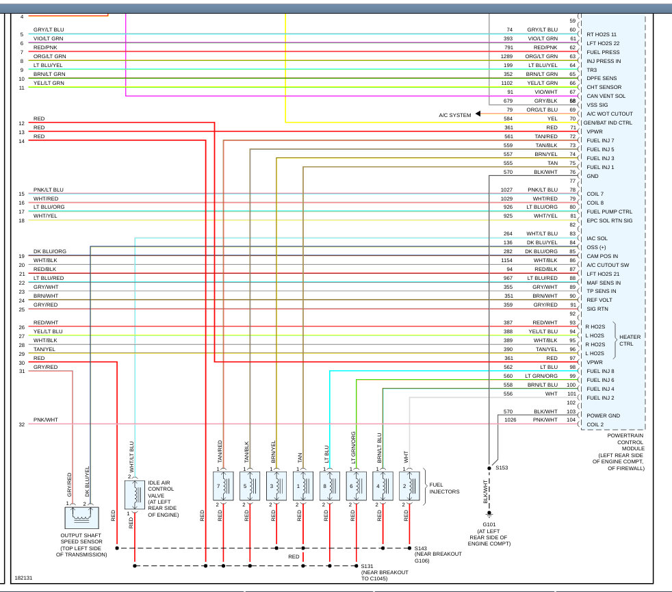

All of the coils are fed from the same fuse #12 in the central junction panel, behind left side of dash so make sure the fuse isn't blown.
RUVIE TUESDAY
  • 10 POSTS
All my fuses and relays are good my cigar lighter works and it's the same fuse that runs the data link connector but when I run a scan. Says can't communicate. How do I check my PCM?
PATENTED_REPAIR_PRO
  • 1,853 POSTS
Pin #12 of the DLc is the purple wire that goes to the pcm pin #13 connector C. Disconnect the plug from the pcm and check for on open/short and short to ground using an ohmmeter on that wire.

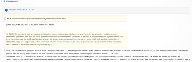

RUVIE TUESDAY
  • 10 POSTS
Could this be a security problem ? When I turn my key forward on the security light on the dash flashes fast is that normal ?
RUVIE TUESDAY
  • 10 POSTS
Would the security system prevent a scanner from communicating ?
PATENTED_REPAIR_PRO
  • 1,853 POSTS
I would have to say yes, this appears to be a security issue.
No, the security system would not prevent the scanner from communicating with the PCM or other modules.
Check the continuity on that purple wire. You are going to have to read the security trouble codes too to find out what is wrong.
If you have a spare key though try that.
If not, clean that key you have where the pellet is and try again.
If the security light goes out finally after ten minutes of leaving the key on run, then you may be able to relearn the password.
You will need a scan tool and I see that the instructions mention something about the instrument cluster.
That is how to enter the "security access procedure".
RUVIE TUESDAY
  • 10 POSTS
That was it all I did was turn the key to on waited like five minutes and the light went out. Started right up.
