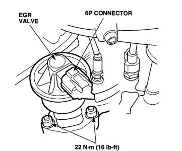

How do you change a EGR Valve on a 1998 Honda Accord?
Thursday, August 12th, 2010 AT 9:54 AM
KHLOW2008
MECHANIC
41,814 POSTS
Hi kelvin43,
Unplug the connector, remove the 2 holding bolts and the EGR valve can come out.
Check the port below the EGR valve for clogging.
