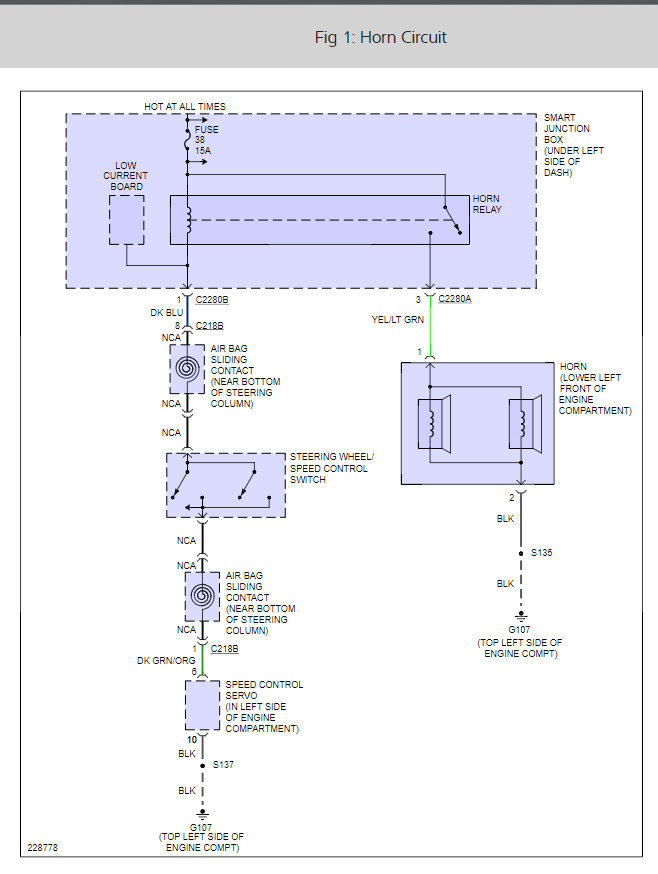

Hey there- My Taurus horn stopped working recently. I checked out the fusebox and verified I was looking at the right one (using the owner's manual) and it was fine.Do you have any thoughts on why a horn would stop working, and what can be done to fix it? BTW- where the hell is the thing located under the hood?
Thanks for any help you could provide.
Dec 27, 2007 at 4:17 PM
  • CAR REPAIR CONTRIBUTOR
  • 54,334 POSTS
Hi!
It sounds like the horn itself went bad which happens all the time but to be sure lets do some simple testing. Here are some guides and diagram(below) that will help you get the job done.
you will need to get under the car safely
Here is a guide so you can check the relay as well.
Please let us know what happens so it will help others.

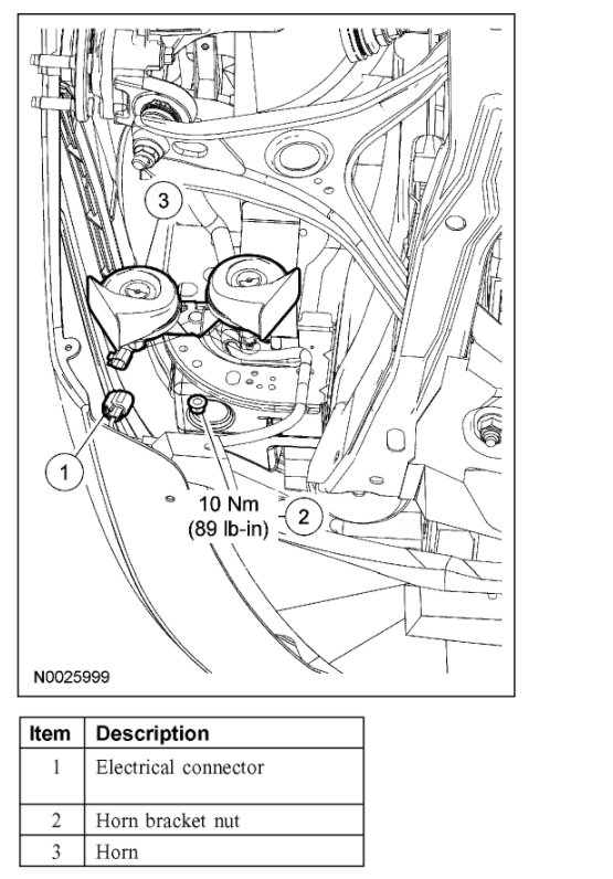

Will do. Was just wondering if y'all had any diagrams for it. Was wondering if I'd have to take off the whole front end just to get to it because when I looked at it yesterday I saw it from underneath by the front driver side fender could remove the plastic by the wheel well and the plastic bottom to get to it or just take the cowl off and the bumper
Aug 15, 2020 at 12:29 PM (Merged)
MA AV
  • 32 POSTS
with cruise control and without
the procedure for removing says disconnect the electrical connector and remove a bolt and both hi and lo horns should come out as an assembly

Well horn wiring is good horn works sounds like crap because it only has the high pitch but its got connectors on so it'll do for now until I get the other

Did you use a voltage tester on the fuse circuit, to see if it is hot? Even if fuse is good, if no voltage, the circuit is dead. You could do some checking at the horn relay. The problem is usually the wiring circuit in the steering column, maybe you'll get lucky? At the datalink connector, pin 16 is voltage, hot all the time, fuse 230--15amp. Pins 4 & 5 are grounds.
