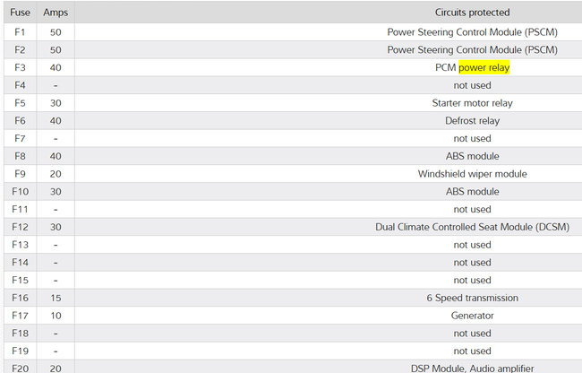

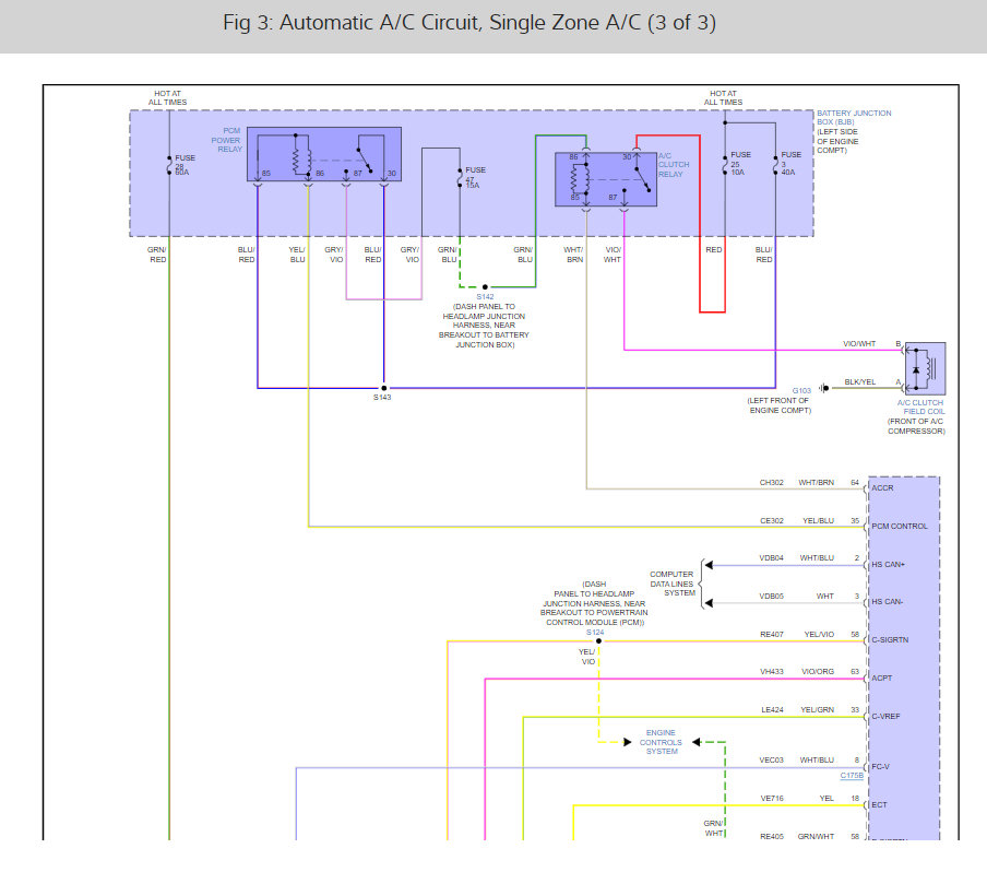

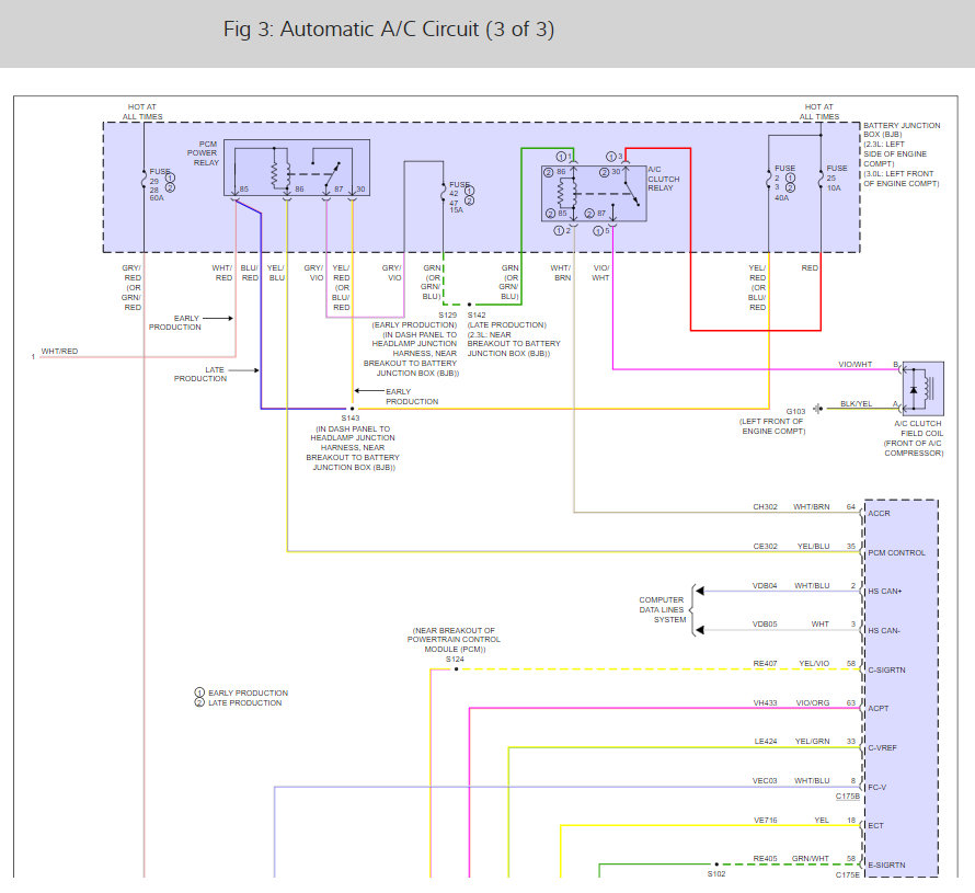

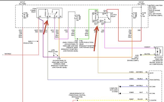

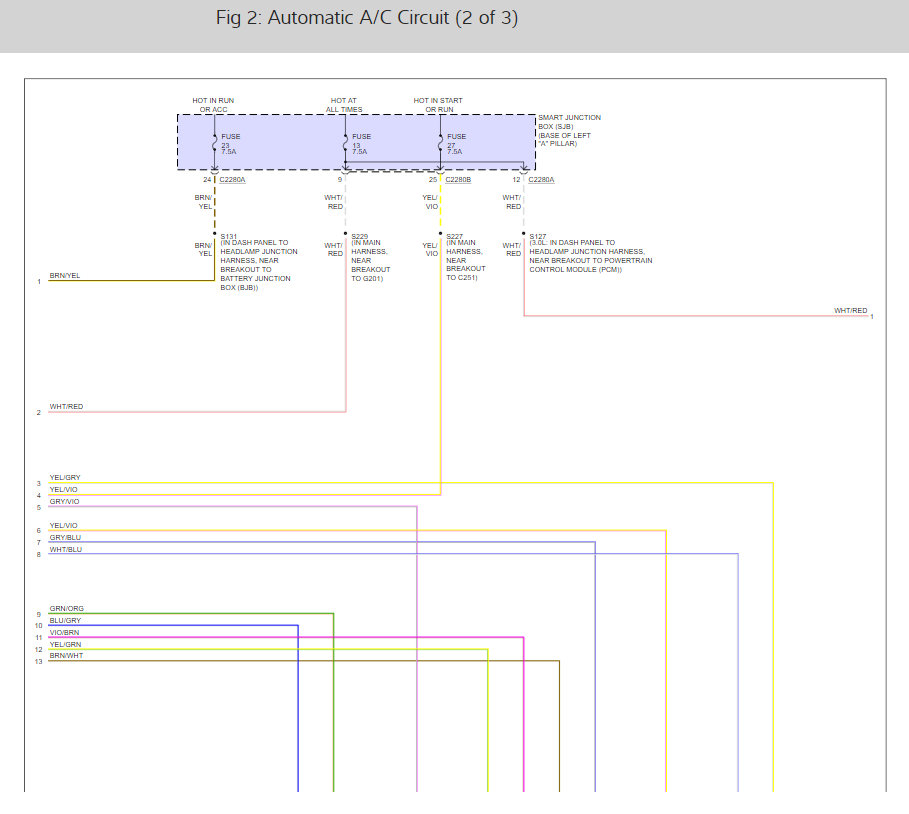

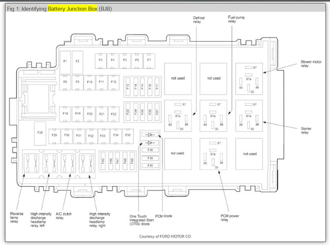

Check where arrows are to see if pcm is turning on a/c relay meaning does it have power check the other relay as well as that can affect it. when the ac/ is on the #2 fan should kick in and the idle should go up if working properly.
Here is a guide to help you test the relays and the wiring diagrams so you can see how the system works. Test the compressor relay.
Check out the diagrams (Below). Please let us know what you find.
Cheers

i will check them tonight but how am i supposed to check the power on the pcm relay with the relay plugged in, i can't access the terminals w/ my meter. i will try to put jumpers from the relay into the slots where the relay would plug into and see what i come up with.
Jun 5, 2013 at 1:41 PM
HMAC300
  • CAR REPAIR CONTRIBUTOR
  • 48,601 POSTS
just leave your meter to any ground one will be hot maybe two then see if pcm slot turns the relay on . on bottom of relay it should have a number and it will be 86 plug your positive side of meter and see if it's getting power or not. if it is try a like relay then see if it works. then probe 85 of a/c relay as well as 30 if you aren't getting power to 30 on ac relay it will have to in order to work clutch hope fully you can enlarge the thumbnail so you get a better idea.
Jun 5, 2013 at 1:49 PM
FRUSTRATEDFUSION
  • 8 POSTS

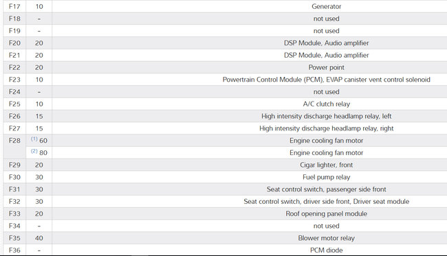

Ok so I did some checking and this is where im at, with the key in the on position I have 12 volts to terminal 85 and 30. The ac relay has power on terminals 1 and 3. But what I found odd is that with fuse # 47 out in my hand I had 12.29 volts on one side and 10.32 volts on the side. So that tells me the pcm relay is sending the power through but the pcm wire to the ac relay isn't closing ground to pull the relay closed. I tested the relay and its working normal.

if you put fuse 47 in and test you should have power at post86 ifnot there is a short there. although you will need a/c on to do this. then it should activate relay and send power to a/c clutch. also check ground on clutch at front of engine compt.only one other thing if this is automatic temp control where you set the tem p this is all wrong an dyou have to scan it to find out if you have a bad sensor someplace.
Jun 7, 2013 at 6:10 AM
FRUSTRATEDFUSION
  • 8 POSTS
The ac switch was lit up on the climate control, while I was testing. I do not have automatic climate control, just dials for hotter and colder. I do have power at terminal 86 on ac clutch relay. I have tested ground for the compressor and it is good, I even ran a new ground temporarily straight from the battery to double check. It doesn't seem like I have any activity from terminal 85 on ac relay "the white and brown wire" that runs to the pcm. How can i test that?

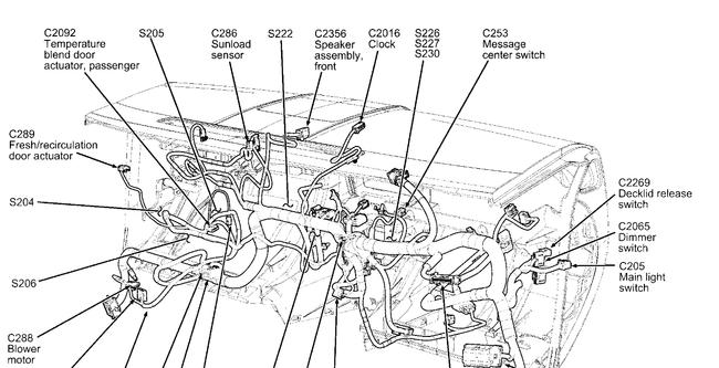

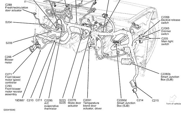

I just went to tips and found this check this part and it may solve your problem you aren't going to like where it is though. if no operation and everything checks out good replace the evap core temp sensor they are very known to fail making you think its a bad compressor (replace that sensor first)
. See the attached figure from the 2007 Ford Fusion component locator article for the A/C Evaporative Thermistor. It is shown in that article as figure 20.
It is found behind the right side of dash, and I understand you can see it looking through the defroster grille
the dash may have to come out to get to it.

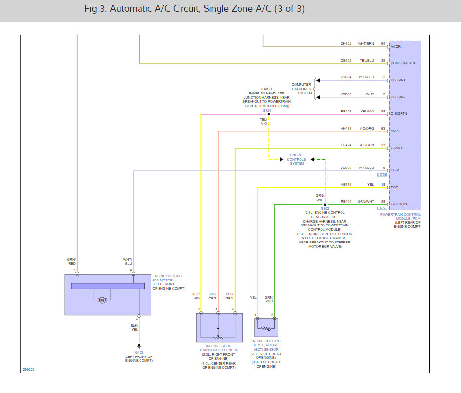

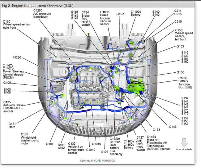

this has been bugging the crap out of me about this. after finally finding the correct diagram the evap switch gets it power from the pressure switch. jump that switch and see if your a/c clutch turns on, if it doesnt' then either the pressure switch isn't pressing the Schrader valve to activate it or the switch is bad or it's a poor connection if the a/c clutch kicks in. Unfortunately the pressure switch is in the engine performance section go figure. it shold be in firewall area depending on which engine you have as there are three different ones for that car. hope it works.

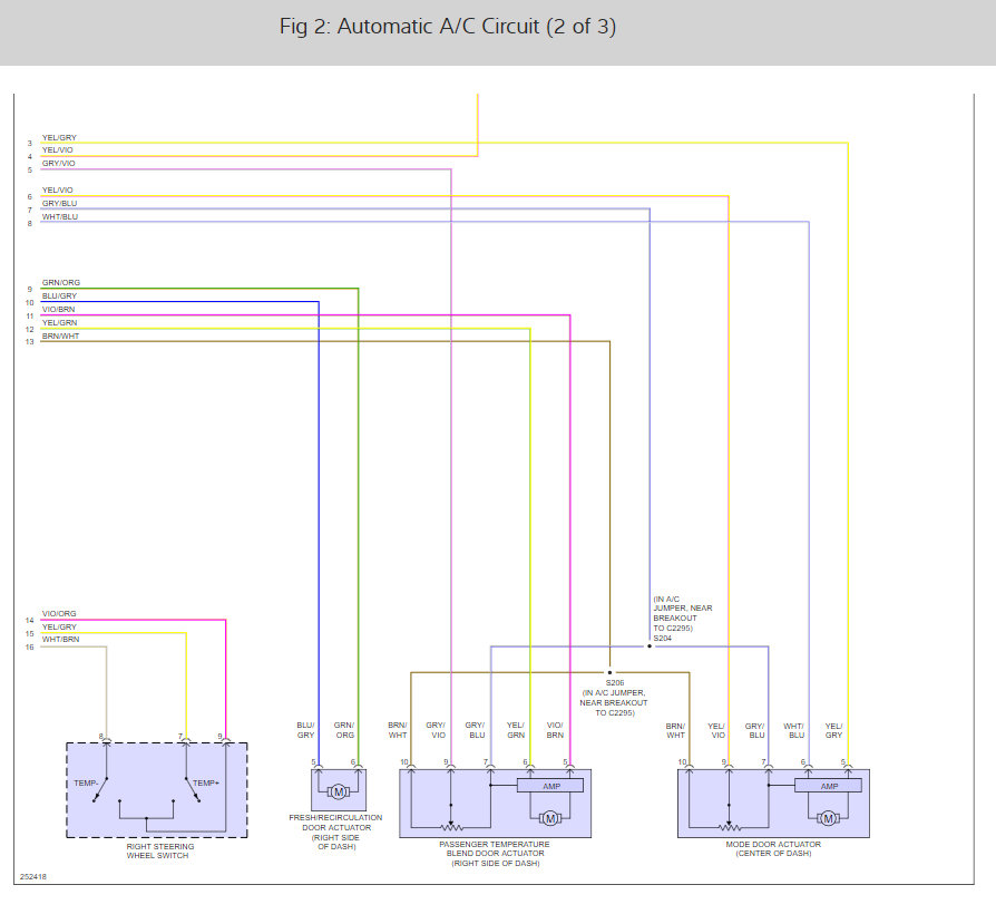

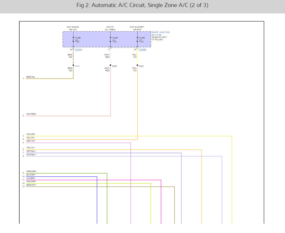

I'd like to revisit this. I'm having a similar issue. I believe it's the sensor center of dash. But I'm not pulling no dash or paying someone $900 to do it either. I want to just drill a hole in airbox behind glove box and cut the wires from old sensor and reroute them to new sensor location. Which should work just fine. The only reason the sensor is in its location is to bill the customer for a $20.00 part. Have a reason to have a service center. I need the correct pin locations for a 2009 Ford Fusion, if anyone can help. It's a 16-pin plug i know.
Aug 29, 2022 at 6:20 PM
  • 54,350 POSTS

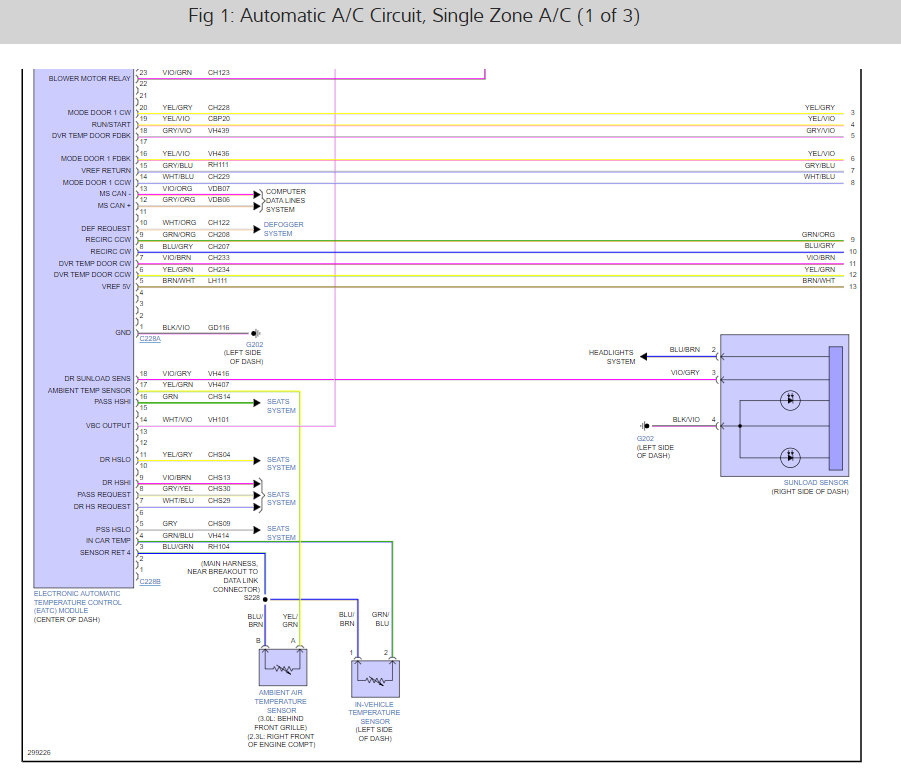

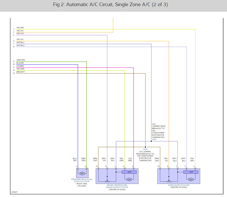

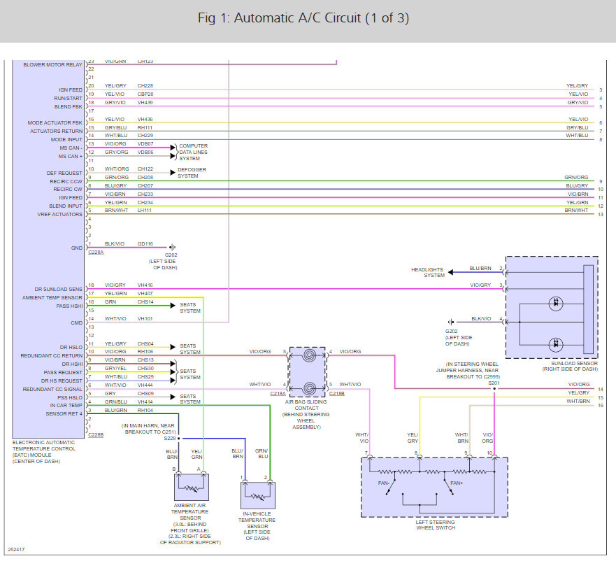

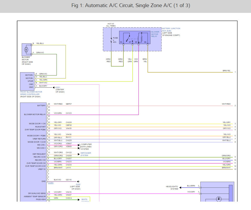

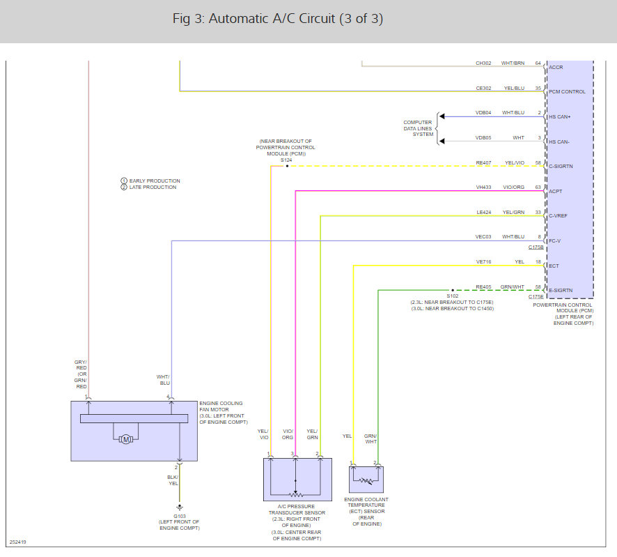

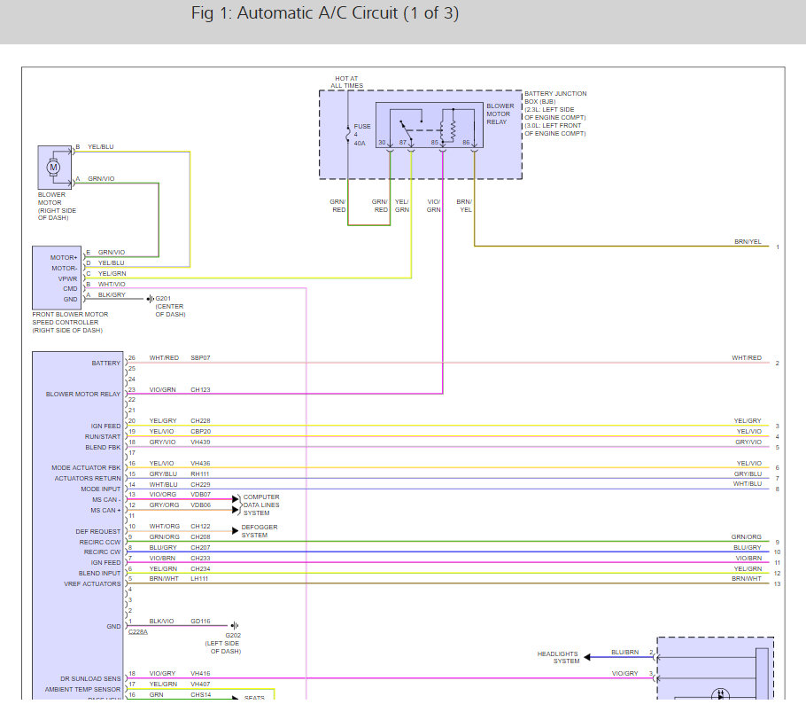

Sure, here are the A/C wiring diagrams so you can see the wiring and how it works int he images below. Let me know if you need anything else.
