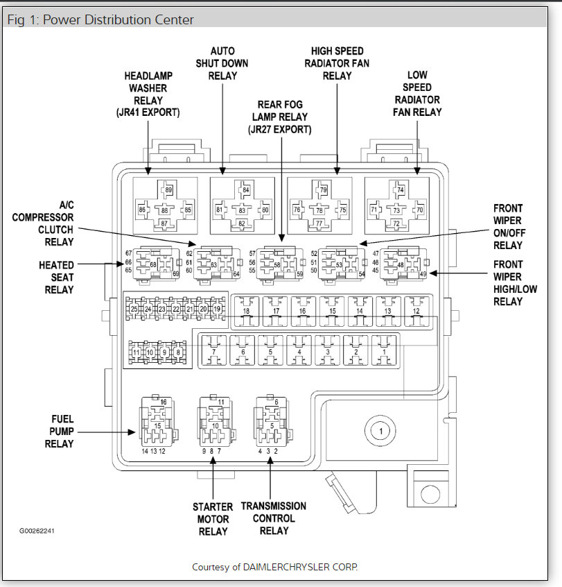

Car was Idling then all of a sudden shut off and would not start back up. Replaced cam shaft and crank sensor still did not work . Replaced ASD relay still did not work. It has no pulsating and no spark, however the fuel pump is coming on.
Aug 14, 2010 at 9:52 PM
  • CAR REPAIR CONTRIBUTOR
  • 75,992 POSTS
Hi ccarpenter05 .
Check and test fuse no. 14 30 amp if okay test for power at the coil and injectors dark green and orange wire-do you have it? Let me know.
Aug 15, 2010 at 12:56 AM
CCARPENTER05
  • 5 POSTS
the injectors have no power, however the coils do. I am going to purchase a new fuse now there was a 20amp in the 30amp place .
Aug 15, 2010 at 9:05 AM
CCARPENTER05
  • 5 POSTS
Replaced fuse still no change.
Aug 15, 2010 at 10:23 AM
  • 75,992 POSTS
It sounds like the ASD relay is not working. Here is a guide to help test the relay with the location in the diagram below:
Check out the diagrams (below). Please let us know what you find.
Cheers
Aug 15, 2010 at 4:44 PM
CCARPENTER05
  • 5 POSTS
So there is no power to the injectors. There is however power to the coil but for only about five seconds.
Aug 15, 2010 at 8:12 PM
  • 75,992 POSTS
Your problem is coming from the ASD relay circuitry or the computer itself is defective.
Aug 15, 2010 at 8:50 PM
CCARPENTER05
  • 5 POSTS
We put a new computer in it and there was no change. I am assuming it is the ASD which is what we originally thought. So we replaced the relay and it started! Should have done that first. DOH
Aug 15, 2010 at 9:15 PM
  • 75,992 POSTS
Cheers
Aug 15, 2010 at 9:24 PM

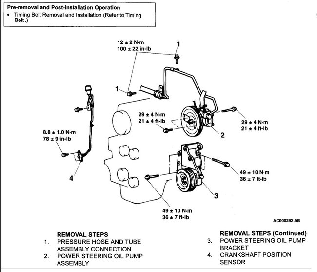

Car was running okay, we changed the exhaust and afterwards it started, but it ran badly, then it would not start. We changed fuses, cam sensors, went through all the fuse boxes, the timing is lined up. We have tried everything possible that has to deal with starting the vehicle and nothing is working. When we hook up the code reader it does not throw any codes. We are at a loss.
Jul 16, 2018 at 8:21 PM (Merged)
  • 54,350 POSTS
It sounds like you have a crankshaft sensor that has gone out. Here is a guide that will show you what you are in for when changing the sensor:
and
Below are some diagrams to show you what it will be like on your car.
Please let us know what happens, we are interested to see what it is.
