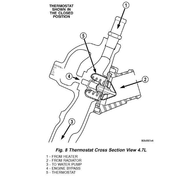

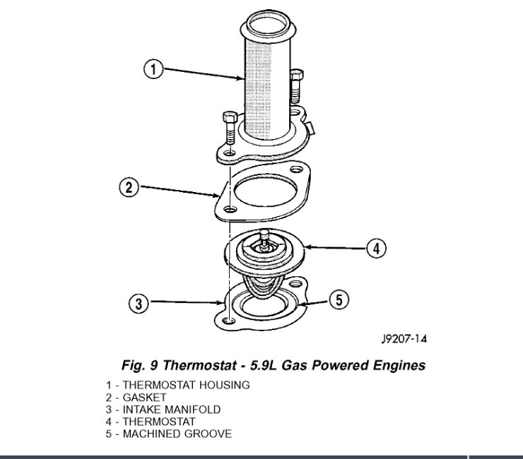

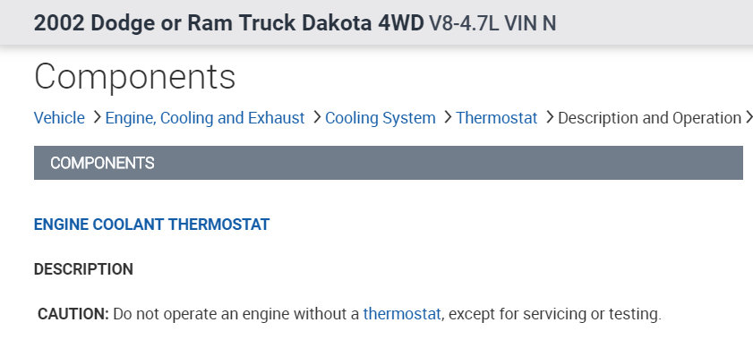

UNCLEDONUT86
  • 2002 DODGE DAKOTA
  • 4.7L
  • V8
  • 4WD
  • 163,000 MILES
I’m having issues with overheating, my vehicle maintains a constant while driving. But as I go the coolant boils over and out the over flow. It first happened while highway driving after having the A/C on, I lost a bunch of fluid before I realized what was happening. I stopped driving with the A/C on to no avail. So I let it cool down and put in a jug of 50/50 and got myself home. The following day I topped off the coolant and proceeded to drive for approximately 9 hours. The boiling over only occurred for the last 20-25 mile. Now It seems to be intermittent it boils up whenever it feels like it. So question, is it the thermostat: water pump: fans: head gasket: ext. Please help. My truck is the only way I am able to get to my daughter 4 hours away.
Saturday, October 3rd, 2020 AT 12:43 PM (Merged)

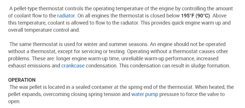

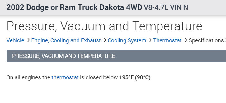

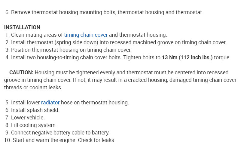

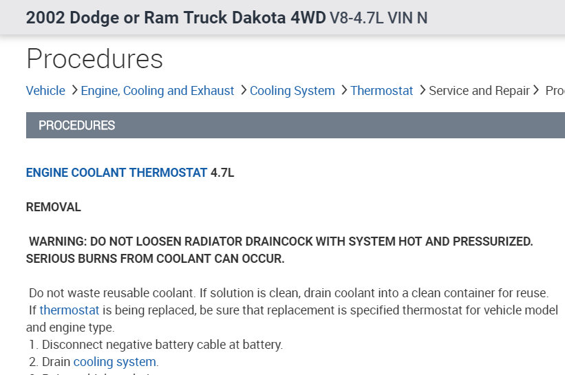

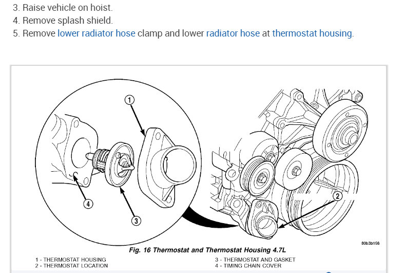

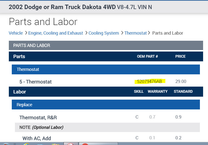

SCGRANTURISMO
  • 4,897 POSTS
This sounds like your vehicle's thermostat might be starting to stick. The thermostat is what allows the coolant to flow. When it's closed, the coolant doesn't flow, when it's open, it does. The problem is when the thermostat gets stuck closed. The coolant doesn't flow and your vehicle's engine overheats. In the diagrams down below I have included a description, Original Equipment Manufacturer (OEM) part number, specs, and the instructions for the removal and installation of your vehicle's thermostat. Please go through these guides and get back to us with what you are able to find out.
