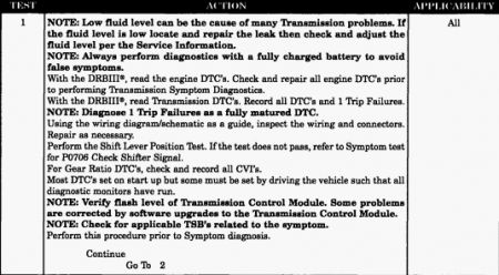

Start and drive the van do you have check engine light on if so need to get the codes if no OBDII reader or scanner try and cycle ignition key ON OFF ON OFF ON in less than 5 sec read in the odometer area trouble codes let me know what you have for codes most common is tranny solenoid pack and or speed sensors

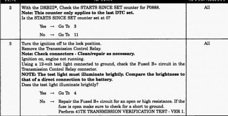

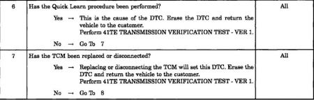

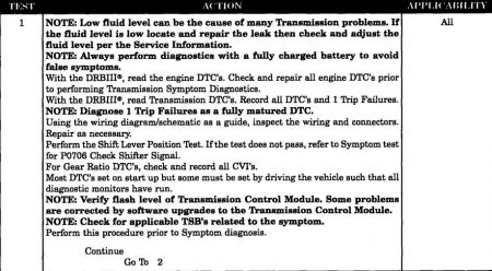

DTC P1684: BATTERY WAS DISCONNECTED When Monitored and Set Condition: P1684-BATTERY WAS DISCONNECTED When Monitored: Whenever the key is in the Run/Start position. Set Condition: This code is set whenever Transmission Control Module (TCM) is disconnected from battery power B+ or ground. It will also be set during the DRBIII(R) Quick Battery Disconnect procedure . POSSIBLE CAUSES QUICK LEARN WAS PERFORMED RECENT BATTERY DISCONNECTION TCM WAS REPLACED OR DISCONNECTED INTERMITTENT WIRING AND CONNECTORS FUSED B+ CIRCUIT TO TCM OPEN GROUND CIRCUIT OPEN

Thanks for all of your help. I really appreciate it a lot. I changed the negitive battery cable today and the van is still in Limp mode. So, what the P1684 code is, may be because the battery and the PCM when replaced needs to be reprogramed. Or it may be like you said the coil pack or the speed input/output Sensor. I will let you know when I take it to the Dodge dealer. Also, after we changed the negitive battery cable the code P1491 came on. I looked it up online and it said that it had something to do with the coolant fan. Funny thing is, is the coolant fan come on and off like normal. All the trouble with the van being on limp mode and the check engine light being on happened after the PCM was replaced and programmed. It was not done by Dodge. It was done by a site online called Auto Computer Exchange. Could it be that even know I gave them my mileage and VIN number that they could of programmed the PCM incorrectly? Even with the bad PCM, the engine light did not come on. Well thanks a lot. My family and I appreciate it a lot. All your help means the world to us. Thanks again and God Bless you for all of your help. Danial Bartlett

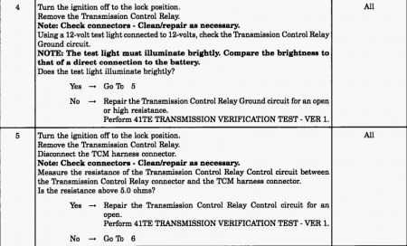

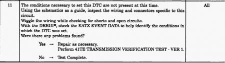

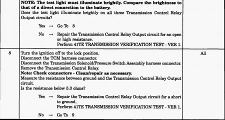

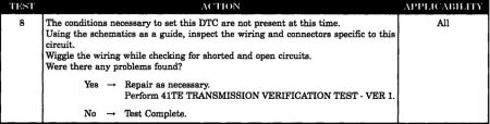

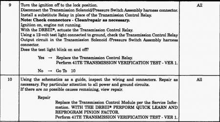

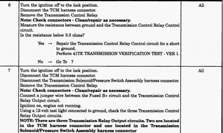

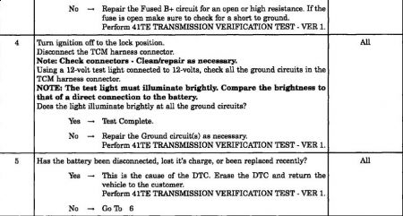

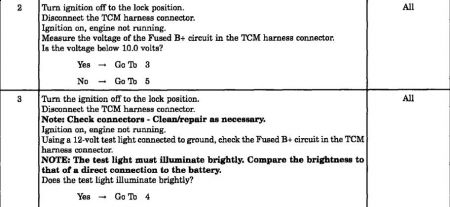

When Monitored and Set Condition: P0888-RELAY OUTPUT ALWAYS OFF When Monitored: Continuously Set Condition: This code is set when less than 3 volts are present at the transmission control relay output circuits at the Transmission Control Module when the TCM is energizing the relay. POSSIBLE CAUSES FUSED B+ CIRCUIT OPEN TRANSMISSION CONTROL RELAY OUTPUT CIRCUIT OPEN TRANSMISSION CONTROL RELAY CONTROL CIRCUIT OPEN TRANSMISSION CONTROL RELAY GROUND CIRCUIT OPEN TRANSMISSION CONTROL RELAY CONTROL CIRCUIT SHORT TO GROUND TRANSMISSION CONTROL RELAY OUTPUT CIRCUIT SHORT TO GROUND TRANSMISSION CONTROL RELAY STUCK OPEN TRANSMISSION CONTROL MODULE INTERMITTENT WIRING AND CONNECTORS

Oct 16, 2009 at 6:02 AM
DANIALBARTLETT
  • 13 POSTS
Thank you so much for all of your help. I am taking the van in on Monday to the Dodge Dealer for a second diognostic test on it. They are not going to charge me for it since when I had the last one done that one of the relays were out of the fuse box and a wire (maybe a ground? I am not sure) was disconnected from the fuse box. Also, they told me if it is just a programming problem they will program it for me. Sorry for bothering you with all of this. But, when Dodge does do this next diognostic test will they be able to say what is wrong with the van for sure at that point or will they tell me the same thing that you have told me? Also, if one of the relays circuits in the TCM are open or there is a short to groung, how hard it that to repair? Last thing can you give me any idea on where the TCM is located ane where the Transmission is located in the 2003 Dodge Caravan. Thank you so much for all of your help and time.

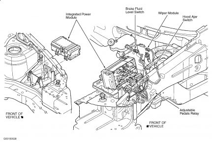

TCM is on the left side of the engine
check in the wheel well on the frame
wiring is very common
let ,me know I ll try and send you wiring diagram

Would you have an idea where the TCM power relay sense circute is located on the 2003 Dodge Caravan? Thank you sir
Oct 19, 2009 at 3:41 PM
BMRFIXIT
  • CAR REPAIR CONTRIBUTOR
  • 19,053 POSTS
Sorry you are going through all this
lets try and make sure you have all your fuses in place and nothing is missing
check fuse #15 its a 20A with key on you should have battery power on it
also locate the tranny control module and check for power with key on the YEL/RED wire
and let me know

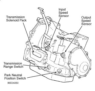

I just have one more question is the output speed sensor on the right hand side of the engine (drivers side) below the fuse box and the battery? The input speed sensor about a foot or so away from the output sensor to the left? I just unplugged them and then unscrewed them. Then screwed them in and plugged them in. Could I have scrwed them up while installing them? Sorry about bothering you. Thank you sir

Yes its the correct procedure and positions

changing parts its not going to help you , you have to start by checking the wiring harness and relays use a test light And or voltmeter

There are two small negitive cables and one large negitive cable that go to and from the battery. The large negitive and one small negitive cable go to the frame of the van on the left hand side. The other small negitive cable is grounded to the frame under the battery. If one of these cables are bad could that cause the van to go into limp mode and cause the code P0888 come up on the van? P0888 is that the output is in the off position and how do I get it in the on position? Also you gave me possible solutions
If any one of these things are open, how do I close it and fix the problem?
