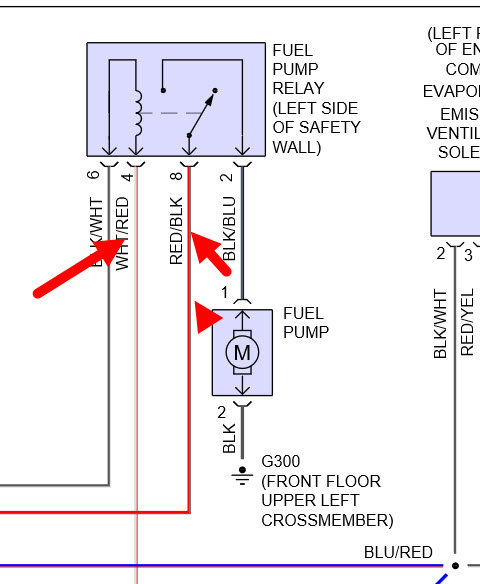

Here is my dilemma, my car was starting to stall on me would not stay idled unless I held down the gas pedal for about a minute and now it wont start at all!
So here is what I have figured out so far, there is no power to the fuel pump unless I bypass the fuel pump relay, I have bought a new fuel pump relay and still did not work. Even when I bypassed the fuel pump relay and got it pumping the car would still not start. I have also changed the fuel filter which did not help. The only light I see on the dash is the oil light but when I crank it over it disappears. Also, the car will start with starter fluid. Any suggestions would be much appreciated. My next guess would be the crank shaft sensor even though there is no check engine light on. I just bought the car for $800.00 and it is sad that it is just sitting there.
Monday, January 25th, 2021 AT 2:05 PM (Merged)

RORTA

HMAC300

RORTA

HMAC300
  • 48,601 POSTS
One thing I forgot is to check your ASD relay that may be the problem as it supplied fuel pump relay. It is on left side of firewall. Guess it is kind of crazy to check fuel pump when you have to jump relay to get pump to work lol. If you can check white/red wire in picture single arrow that comes from PCM double arrow comes from ASD relay. Although that may supplying power already. What you might do also is check the ground wire it may not be letting relay get ground then if no power from PCM check wire for continuity should have about five ohms or less be careful if you disconnect PCM as those are very small connectors. Finally it may be a bad PCM as well or a bad connection at PCM so you could try some dielectric grease at PCM connection.
