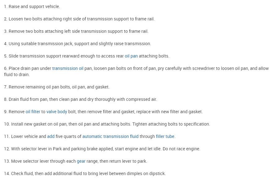

  • CAR REPAIR CONTRIBUTOR
Got it.
Can you check for any codes?
I would start by changing the oil/filter in the transmission.

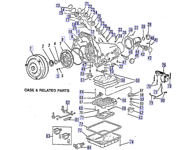

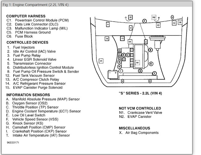

KATLINUHL5727
ABS light came on speedometer quit working and will not shift into third or fourth gear. Showed no signs of transmission failure.
Apr 9, 2021 at 7:12 PM (Merged)
  • 54,350 POSTS
It sounds like the vehicle speed sensor (output shaft speed sensor) has gone out. Here is its location so you can replace it. F and #43 in the diagrams.
Check out the diagrams (below). Please let us know what you find.
BRYANK36
it was the vss thank you.

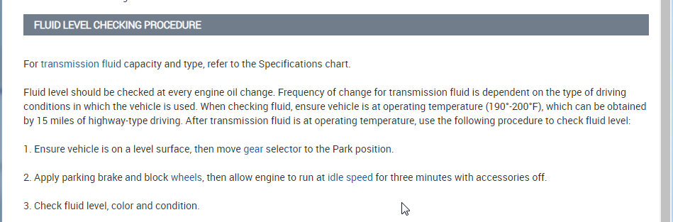

We need to start with the basics. Let's inspect the fluid level and condition. If the fluid is dirty we may need to start with changing it but that is also a sign that the damage is already done and it won't fix it.
So if the fluid is dirty then that is normally caused by a clutch slipping and it burns the fluid which causes more damage and eventually you lose forward gears first and then reverse in most cases.
Below is the process to check the fluid.
Then we need to check for codes.
Let's start with this and go from there. Thanks

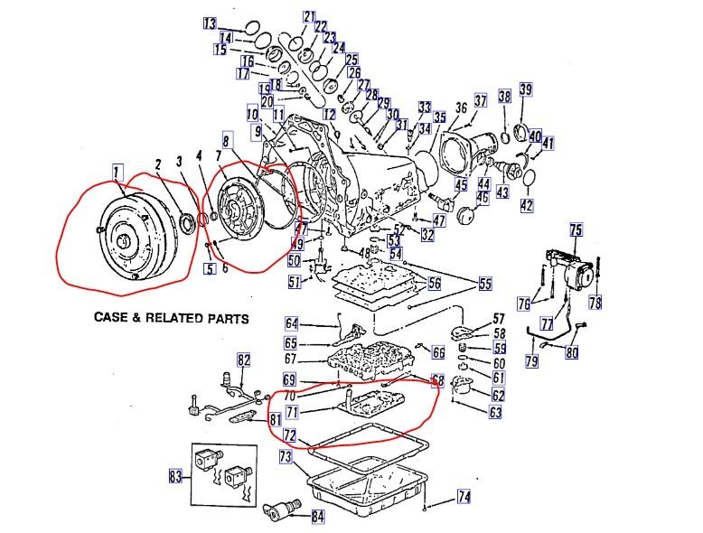

CRIDDLE
Why is my transmission not going into drive and high rpm.
Good morning,
The first thing is to check your fluid and make sure it is correct.
It could be a clogged filter in the transmission. I would drop the pan and change the fluid and filter.
Beyond that, you may have a failed torque converter or front pump failure. That will require removal and inspection.
