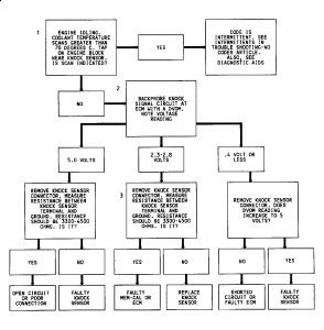

1993 Buick Park Avenue has these error codes, 43 and 58. How are they repaired? What's wrong withe the car?

Code 43 is knock sensor fault does engine have any internal noise? see flow chart to diagnose
Code 58 is PASS-Key fault has key been changed, door lock problem?
