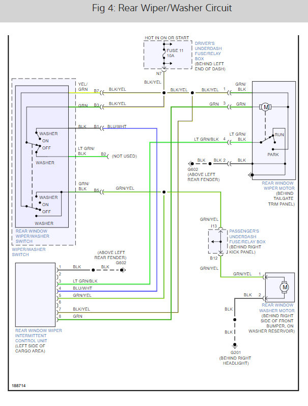

My rear wiper, both windshield wiper pumps, and the front windshield wiper intermittent function do not work. Its seems odd that all these would go out at the same time. Has anyone ever had the same problem or know what I should to try and solve it?
I checked the fuses, they seemed OK but I've heard that some may have been mislabeled so if correct, who knows what fuse to look at. Yes it has rain sensing automatic wipers. Any help would be greatly appreciated.

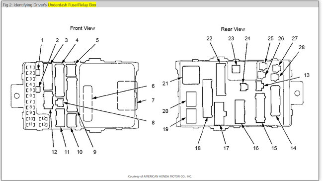

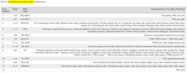

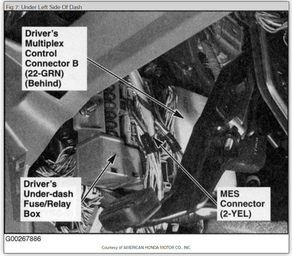

Hello
This sounds like the fuse #11 in the drivers fuse panel is not getting power or is no good this guide will help us test it with the wiper wiring diagrams below to show you how the system works.
Check out the diagrams (Below). Please let us know what you find. We are interested to see what it is.
Mar 17, 2009 at 6:44 PM
DEARSMITHS
I checked and those numbers you cited on my Acura MDX fuses and the fuse was melted, I installed a new one and bam! all fixed!

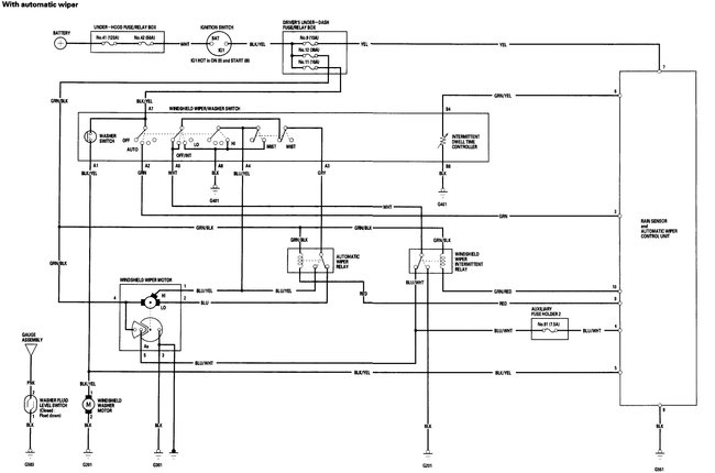

My auto wiper is not working. I found the diagram for the auto wiper fuse on the driver side, but I can't see to physically find the fuse. Also, where is the located. They say it's near the rear view but I don't see it.

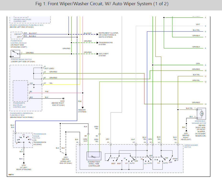

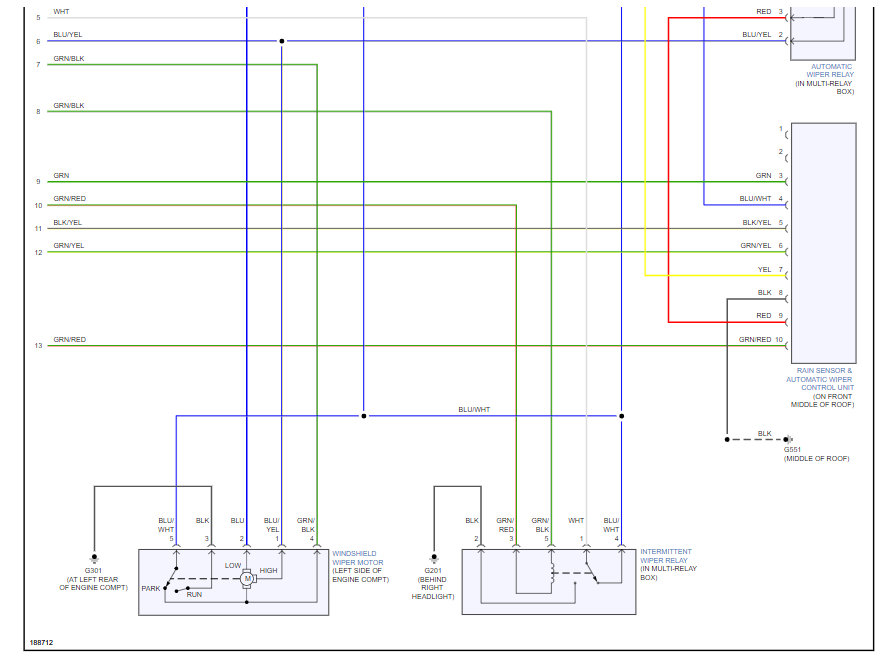

I’m also having problems with my wipers on a 2004 Acura MDX the auto function doesn’t work at all and they will not park. They stop as soon as I turn the switch off so I have to carefully bump the switch until they park. Checked all fuses and relay and all appear to be ok. My manual doesn’t have schematics for auto wiper system any help would be greatly appreciated

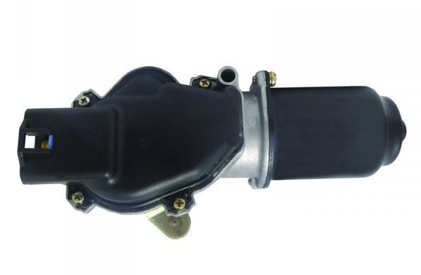

If all 4 fuses test good and the relays check out the most likely suspect would be the park switch on the wiper motor itself. I would also verify that the ground shown as G301 is good. It will be one of the black wires from the wiper connection.

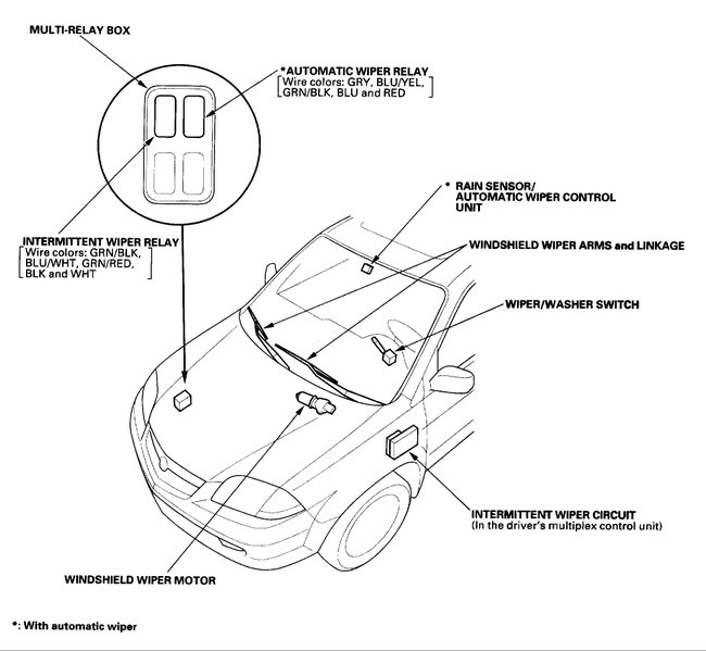

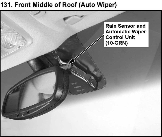

I recently purchased a 2004 MDX, and the intermittent wipers never worked.
After some research I found the original rain sensitive windshield had been replaced with a aftermarket without rain sensing.
Is it possible to bypass the rain sensor either by installing a jumper or programming the computer.
A new factory windshield with rain sensing is $1000.00 so I would rather bypass the sensor if possible.

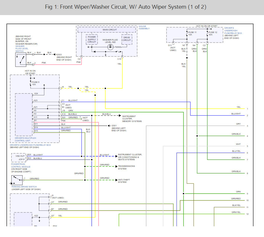

Hi lunenburger. See if the diagram can help you solve your problem.
https://images.2carpros.com/forum/automotive_pictures/192750_AcuraMDXWiper01Auto_1.jpg
https://images.2carpros.com/forum/automotive_pictures/192750_AcuraMDXWiper02Auto_1.jpg
https://images.2carpros.com/forum/automotive_pictures/192750_AcuraMDXWiper01NonAuto_1.jpg
https://images.2carpros.com/forum/automotive_pictures/192750_AcuraMDXWiper02NonAuto_1.jpg
Jul 1, 2020 at 11:09 AM (Merged)
ITSACHEVY
  • 5 POSTS
Thanks I see from the schematic the auto function is controlled through the park so that makes sense. I will first verify ground to wiper motor but from there I would imagine you would have to replace the wiper motor to replace the park switch? or are they separate? Thanks for your help

These schematics are exactly what I need but I can't get the resolution high enough to read them.
Is it possible to send a higher quality image or email a pdf file.
Thanks again

Yeah, It's attached to the back of the wiper motor under the plastic cover. You might be able to repair it if you're handy with tools and electronics. It consists of a couple wiping contacts and a rotating gear with brass contact plates. The wires break to the contacts or the fingers wear. Just follow the wires to the control contacts.

I took the original wiper motor apart and couldn’t find any broken wires and contacts looked good so I ordered a used wiper motor that was supposed to be good and installed that and still the same problem. The mist function doesn’t work the auto function doesn’t work and they don’t park. And based on the drawings everything seams to point to the wiper motor but I can’t find anything wrong and even a second motor does the same. I do have a good ground I did check that so I’m at a total loss on this. Right no low speed and high speed wipers work but will not park and when I use the window washer the pump runs but the wipers don’t work so I have to switch the wipers to low speed when I use the washer. They are hard to use this way and would love to figure out what is going on with them.

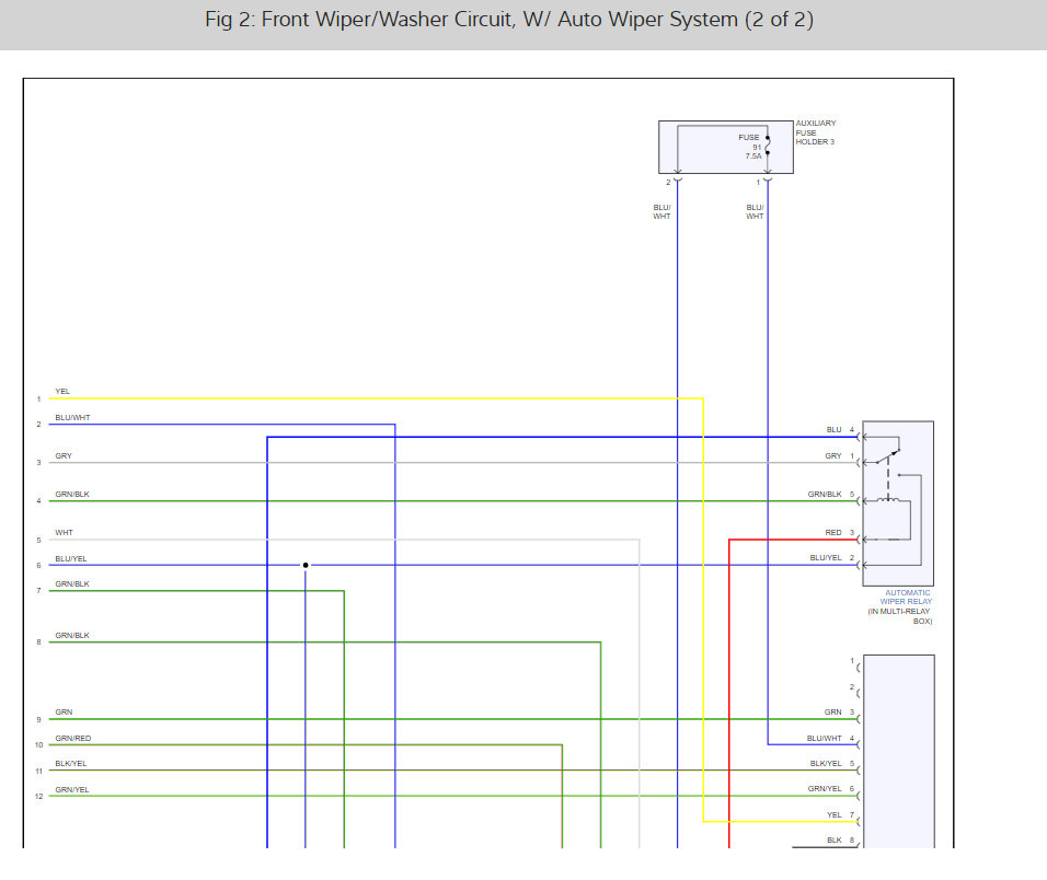

OK you have a few other problems than just parking. You checked all of the fuses and tested the relays already, correct? On fuses don't just go on looks, that can easily burn you instead test them with a test light. If those all check out you will need to test the automatic controller itself. If you look at the schematics you will see the pin numbers for the connections. The unit is behind the rear view mirror and includes the rain sensor.
With the ignition ON And the wiper switched to AUTO mode. You should have battery voltage at the Yellow wire (7) and the Green wire (3). Now if you push the washer switch you should hear the motor and get battery voltage at the Black/Yellow wire (5)
You should have a ground at the Black wire (8)
If that all works pour some water over the sensor, if the wipers don't come on and you don't hear the auto wiper relay click then the unit is faulty.

Ok I preformed the tests at the auto wiper sensor and I do have voltage on pin 7 and pin 3 and 3 goes off when auto is turned off and back on when switched back to auto. I misspoke earlier and the mist function does work it just doesn’t park either. When I hit the washer switch I do get 12 volts at the blk/yel and the pump turns on but the wipers do not. It is the washer circuit that doesn’t turn the wipers on. When I pour water over the window pin 10 grn/red does momentarily go low and if I ground it the relay does click so I think the sensor does work as water poured on the window does pull the auto relay to turn on. I also measured voltage at pin 4 blu/wht and when the wiper is in the home position I have 12 volts there but when off park position I have 0 volts there. So I’m not getting the connection from blu/wht to blu wiper low speed to park the wiper. So it either has to be either a wiring problem at relay, bad relay or bad wiper switch.

I would suspect the relay and it's socket first then the wiring itself. The switch simply removes power from the circuit and the switch on the wiper motor then keeps power applied until it parks.
It sounds like the controller is working.

I got everything working and it wound up being a relay after all. I think it had to bad relays and even though I bench tested for continuity they were still bad. I finally traced everything out and jumped across the relay contacts as a test and they cycled home. So I ordered 2 new relays and it worked fine from there. Thanks so much for your help and the schematics definitely saved me.
