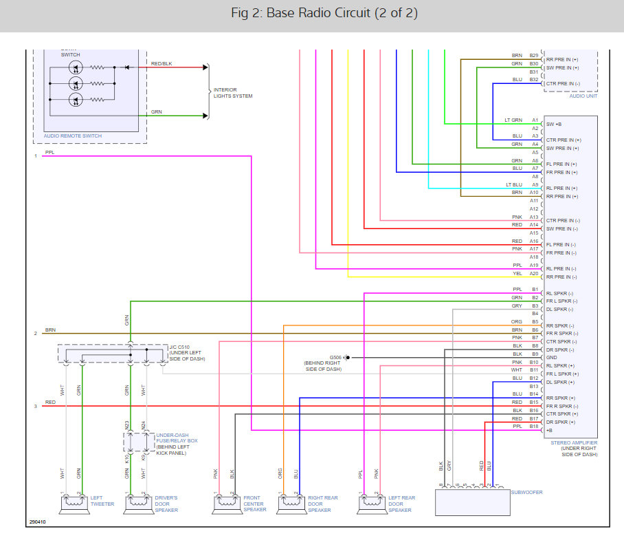

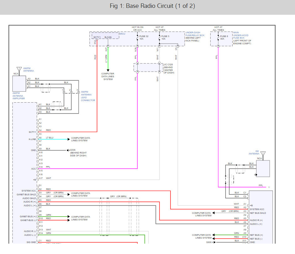

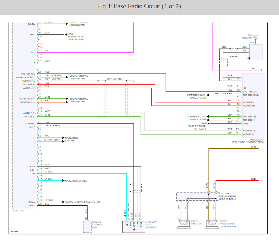

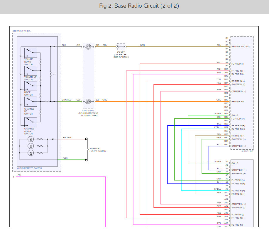

This guide will help you check for power at the fuses and the grounds for the system. The wiring diagrams below will show you how the system works.
and
If everything check out the head unit is bad. Check out the diagrams (Below). Please run this test and get back to us.

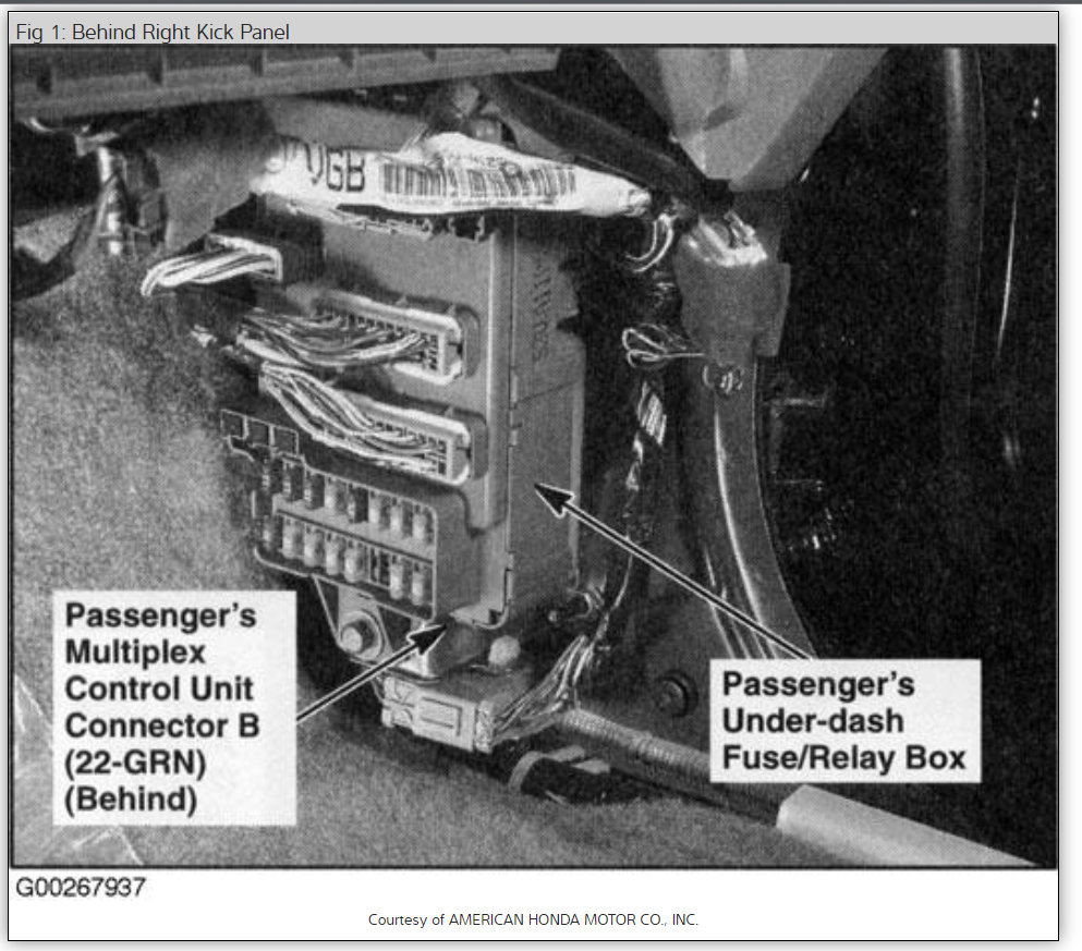

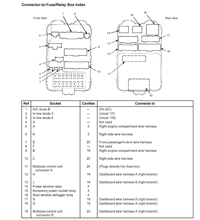

Hi SATTAR419,
When wires are left hanging afte being cut, they would cause shorting when the bare ends of powered wires contacts with any body parts or grounds. Use wire tapes to cover them up individually to prevent shorting.
Check fuse # 9 ( 15 A ) in passenger underdash fuse box. It is for the accessory power socket relay.

Check the following fuses. Did you use a test lamp to test the fuses?
Underhood fuse is # 47 and # 48.
Driver's underdash fuses are # 6, # 8 and # 9.
Passenger fuse # 9.

Hi tajimodern,
Did you check Fuse number 9 in passenger under-dash fuse box?
An accessory power relay in the same fuse-box provides power to the radio and navigation system.
