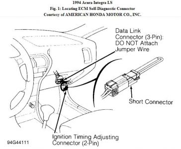

how do i check the CEL on a 1993 acura integra. i dont want to take it to the shop, and i have no idea were to look for the obd1 port thing can u help me

https://images.2carpros.com/forum/automotive_pictures/192750_SCS94IntegraLS_2.jpg
The diagram shows the SCS. bridge it with a jumper ( papaer clip etc ) and turn ignition switch ON. Count the blinking of the CEL to get the trouble code.

is there going to be any type of color that i might no which wire to pull? becuase i look under there and there is alot of different wires and i dont know which one to pull. so idk what to do. any suggestions

You do not pull any wires.
Look for the 2 and 3 terminal unattached coupler.
If the holder is there, it should be a green rubber with 2 holding points for the couplers.
