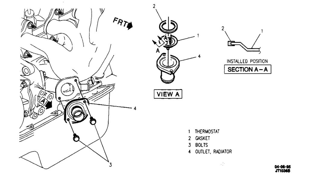

I cannot seem to find the thermostat on the car listed above. Where is it located?

It is at the upper hose in front of the engine.
I attached a picture and procedure below.
Remove or Disconnect
1. Negative battery cable.
2. Drain and recover coolant until level is below thermostat.
3. Radiator outlet pipe attaching bolts.
4. Outlet.
5. Thermostat.
Clean
Radiator outlet mating surfaces.
Install or Connect
1. Thermostat.
2. Radiator outlet.
3. Attaching bolts.
Tighten
Tighten thermostat housing retaining nuts to 14 N.M (124 lb. In.).
