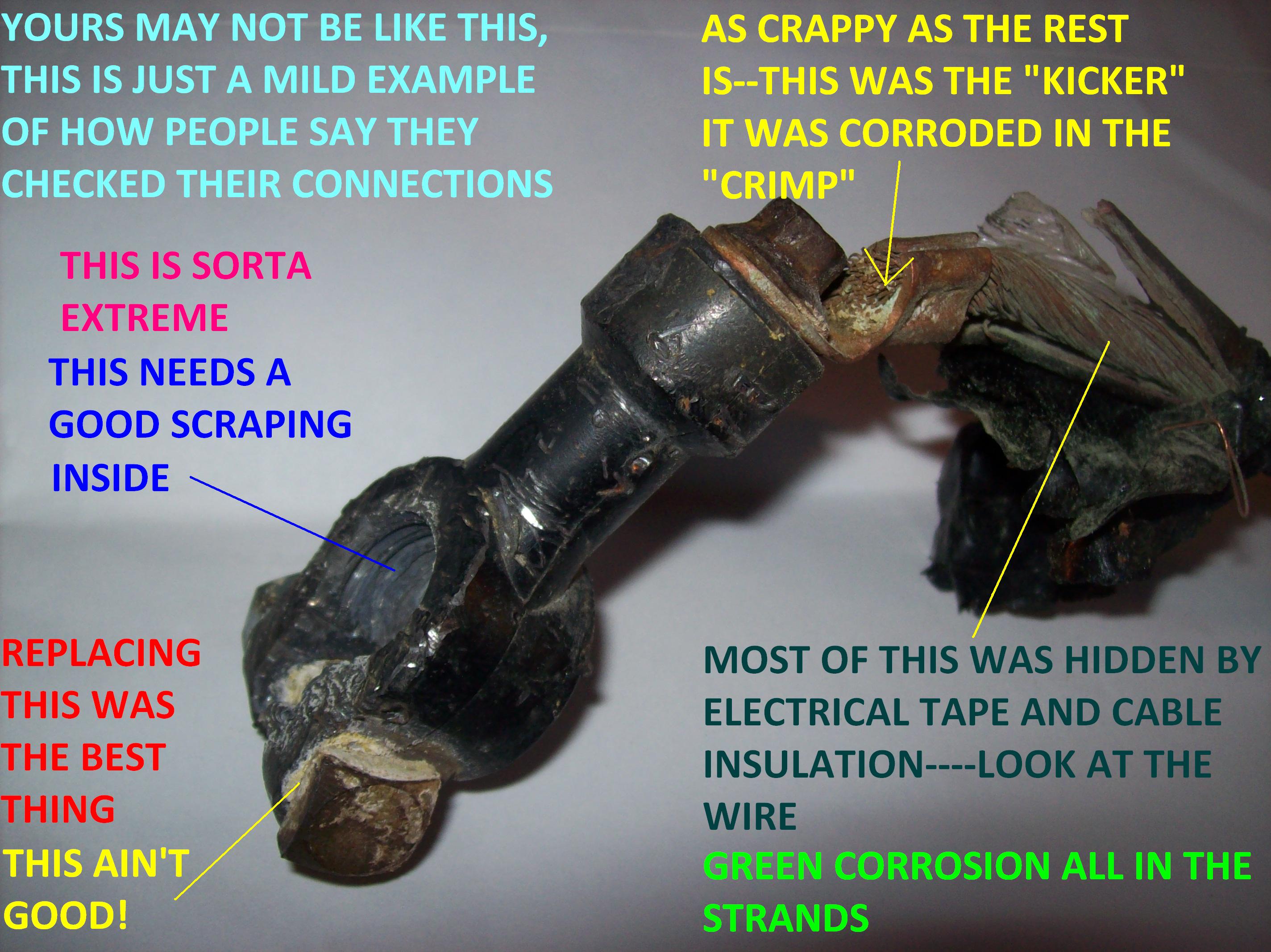

CJ MEDEVAC
  • 11,005 POSTS
WELL I SORTA POSTED THE "ATTACK YOUR CONNECTIONS" ANSWER ABOVE
I DON'T KNOW HOW MUCH YOU GOT INTO DOING IT
MAYBE YOU MISSED SOMETHING. MAYBE A BAD STARTER? (IT CAN BE REMOVED AND TESTED AT A POPULAR AUTO PARTS STORE)
BELOW IS A PIC OF A BATTERY CLAMP---JUST PART OF THE CONNECTIONS ARRAY
LOOK AT WHAT I LABELED AS WRONG---APPLY TO EVERY CONNECTION, NOT JUST THE CLAMPS
THIS BELONGED TO A JEEP GUY AND WAS ON HIS 1985 CJ 7. HE'S NOW A NEW PAL
EVEN WITH HIM HAVING A BRAND NEW BATTERY, IT WOULD NOT START UNLESS IT WAS JUMPED OFF FROM ANOTHER VEHICLE
I OFFERED MY ASSISTANCE IN HELPING HIM, TUNE UP HIS JEEP. HE ALWAYS PAID SOMEONE AND NEVER TOOK PRIDE IN DIYing HIS OWN STUFF
THIS WAS GONNA BE HIS VERY 1ST DIY (I AM A WHIZ WITH CJs--NO DOUBT IN MY ABILITIES)
THIS CLAMP ALMOST RUINED MY SOON TO BE PAL-NESS WITH THIS GUY
HE WAS SO HARDHEADED, WHEN I INSISTED HE HAD A CONNECTION PROBLEM BETWEEN THE BATTERY AND THE STARTER. HE KEPT TELLING ME HE HAD CHECKED EVERYTHING AND IT HAD TO BE THE BATTERY.I MONKEYED WITH IT AND LOST ALL POWER AND IT WOULD NOT JUMP OFF (EVEN THOUGH THE BATTERY SHOULD HAVE DONE IT ON IT'S OWN)
THE MAN HAD KNOWN ME FOR A TOTAL OF ONE HOUR, AND NOW HE WAS ABOUT TO BAN ME FROM TOUCHING HIS JEEP! BEFORE HE COULD SAY A WORD, I WHIPPED OUT MY KNIFE AND SKINNED THE ELECTRICAL TAPE BACK ON THE POSITIVE CLAMP. BELOW IS WHAT I FOUND, I CUT OFF THE WIRE ABOUT 8 INCHES, INSTALLED ONE OF "MY" NEW SPARE CLAMPS.
WAH-LAH. NEW PAL
SINCE THEN WE HAVE INSTALLED A NEW CARB, CLEANED UP THE MESS UNDER THE HOOD. IT PURRS LIKE A KITTEN!
IF YOU WANNA REALLY SEE ME IN ACTION, LOOK AT THE JEEP CJ 5&7 FORUMS IN THIS SITE
KEEP US INFORMED
THE MEDIC

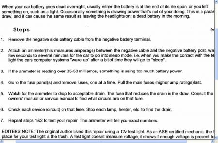

You have a short circuit eating up the battery do below battery drain test.other possiblities are starter, starter relay, transmission range switch and ignition switch.
https://www.2carpros.com/forum/automotive_pictures/12900_parastic_draw_1_218.jpg
