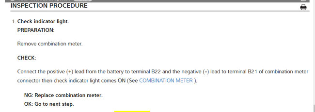

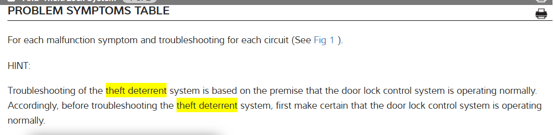

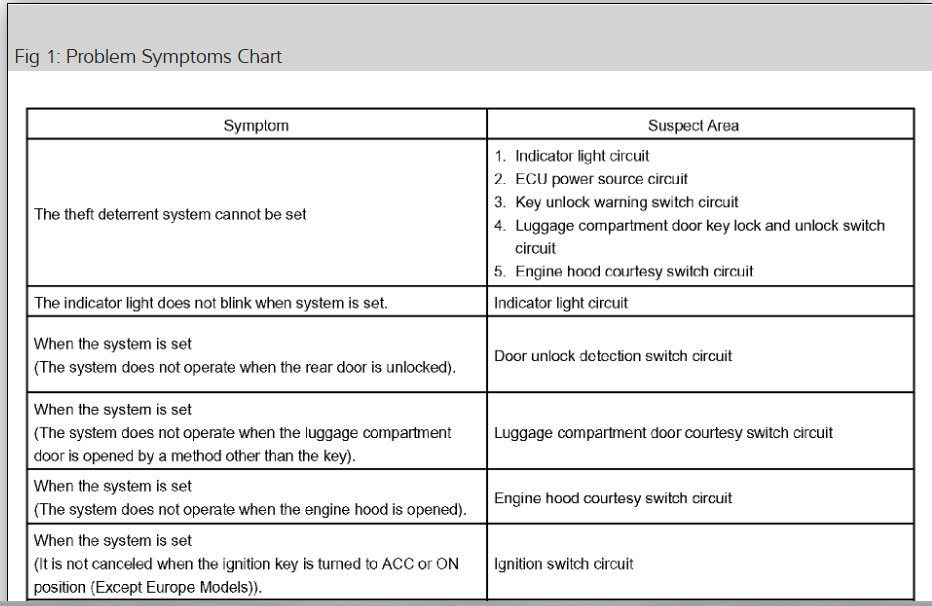

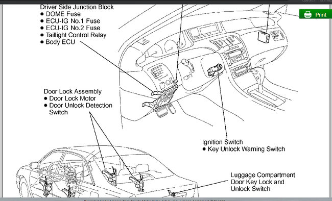

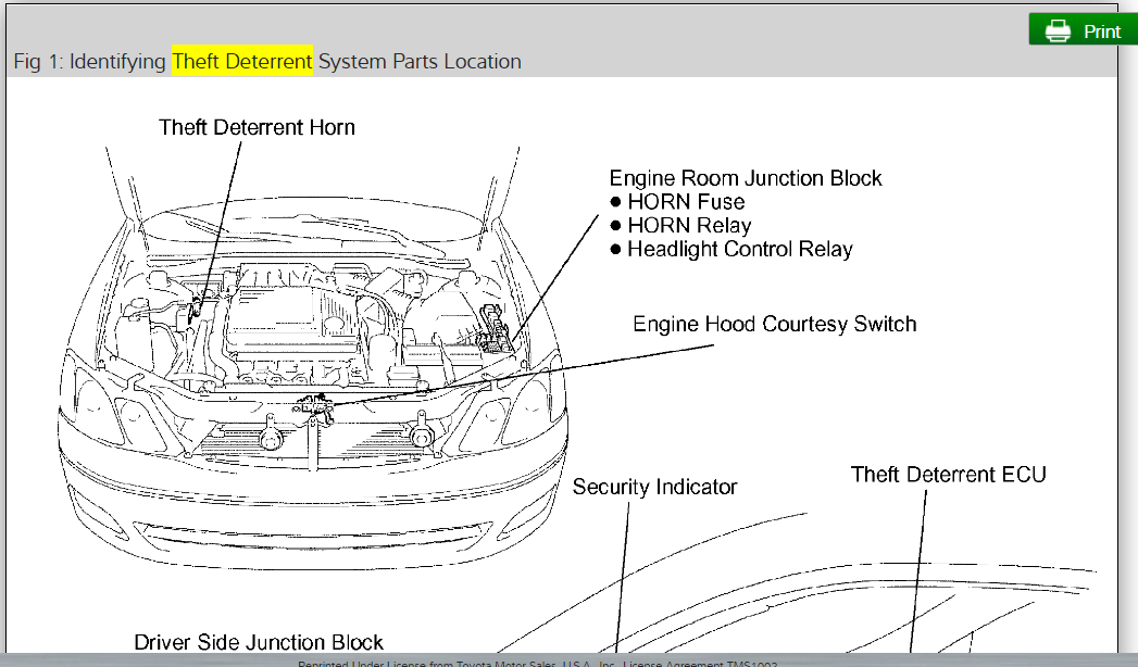

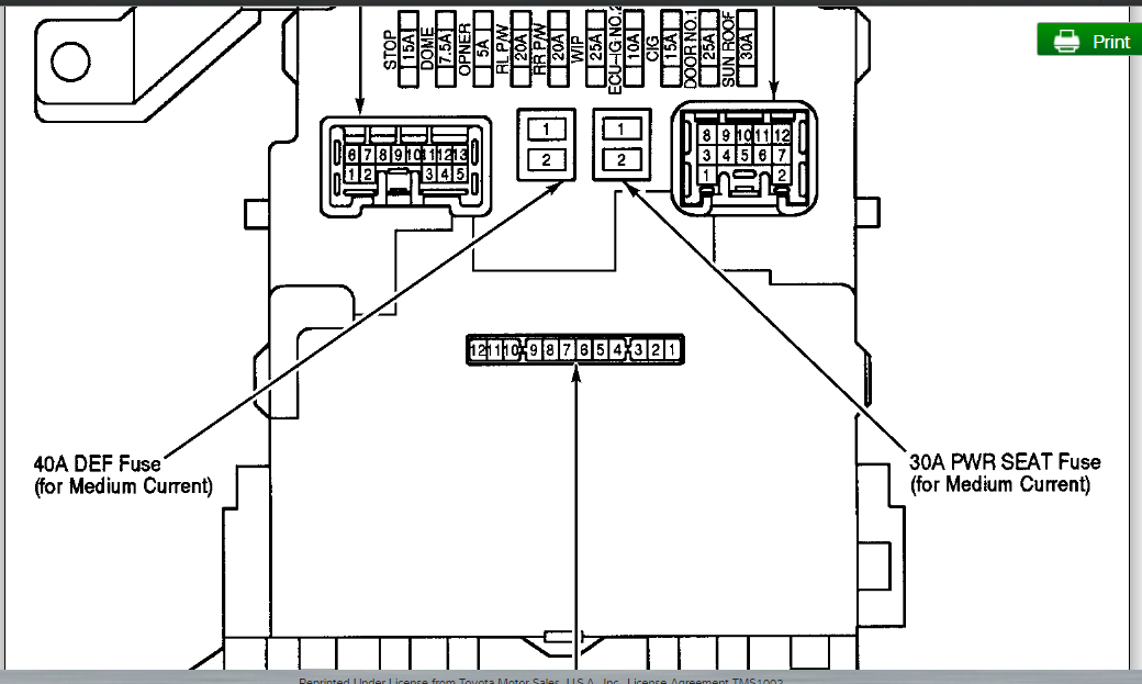

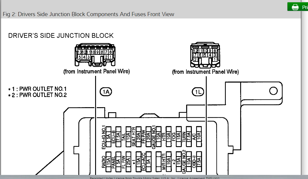

Turns over but won't start. I think it's the anti theft system disconnected battery.
