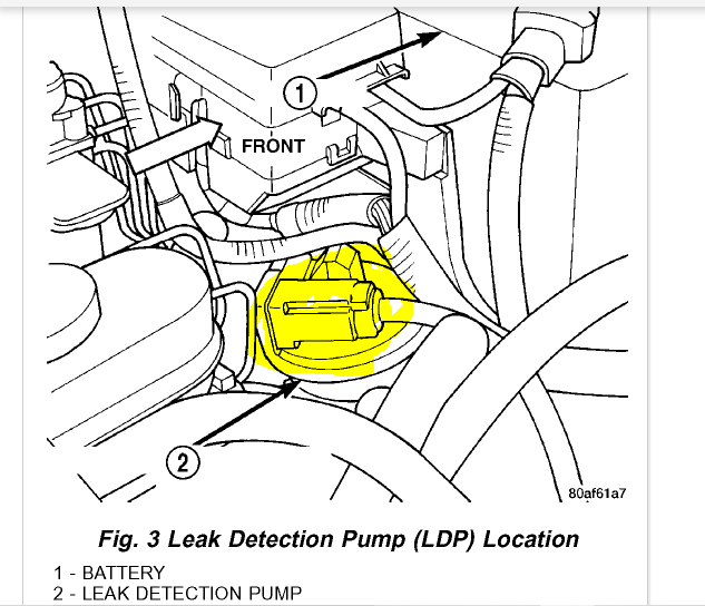

Hi:
Unplugging it won't make a difference. We need a place for the exhaust to exit. As far as the leak detection pump, that isn't going to cause it unless there is a large vacuum leak. Have you checked for vacuum hoses that have been damaged?
I attached a pic of the pump below. Check to see if anything has been chewed through, causing a leak. Also, the 3.9L is a durable engine. Unless the oil hasn't been changed or the engine was abused, compression shouldn't be an issue.
Let me know what you find.
See pic below
