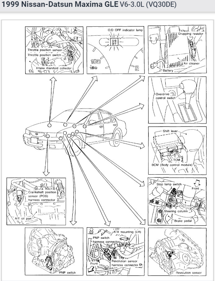

Will not start
TOM WILEY III
  • 1999 NISSAN MAXIMA
  • 6 CYL
  • 2WD
  • 100,000 MILES
The on button is lit up. It just cranks and will not start.
Tuesday, July 17th, 2018 AT 11:36 AM
KEN L
  • MASTER CERTIFIED MECHANIC
  • 55,535 POSTS
It sounds like you have a crankshaft angle sensor that has gone out which is common. When these sensors fail they may not trigger a check engine light. When you turn the key to the on position without starting the engine can you hear the fuel pump prime? If so I would do the crankshaft sensor. Here is a guide to help you see what you are in for when doing the job and diagrams below so you can see the location for your car:
