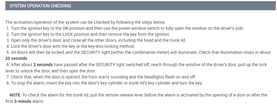

Can turn key but no response. New battery new comp.
Monday, November 25th, 2019 AT 4:57 AM
Have you checked the security system? Does the security light stay on when you are trying to start the engine? If not then we need to measure voltage at the starter and see what we have.
Let me know about the security light and we can go from there. Thanks
