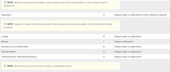

It wont start or fire. We changed the computer. Pick up coil. Fuel pump relay. Ignition coil and still wont start or fire.

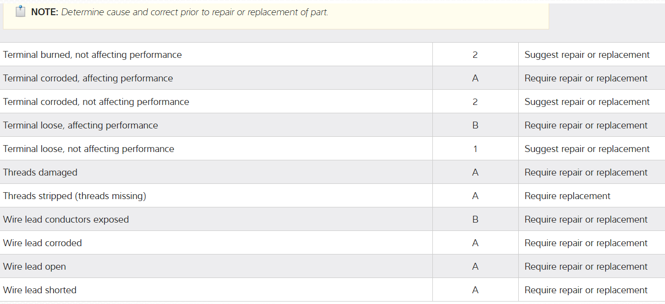

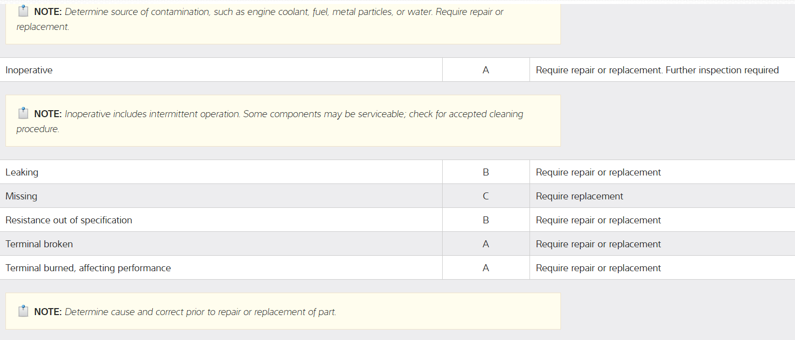

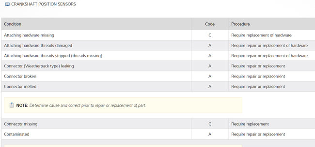

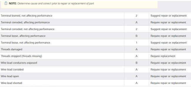

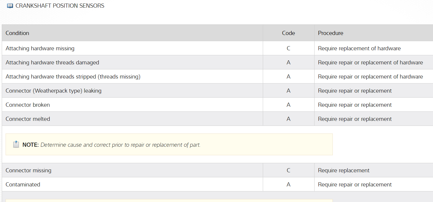

This sounds like it could be a problem with your Crankshaft Position Sensor(CKP). Here are are a few links explaining what a CKP sensor is, symptoms of when it goes bad, and how to replace it:
https://www.2carpros.com/articles/how-a-crank-shaft-angle-sensor-works
Also, I have included a factory Inspection flow chart for you in the diagrams down below. Check it out and let us know what you find out.
