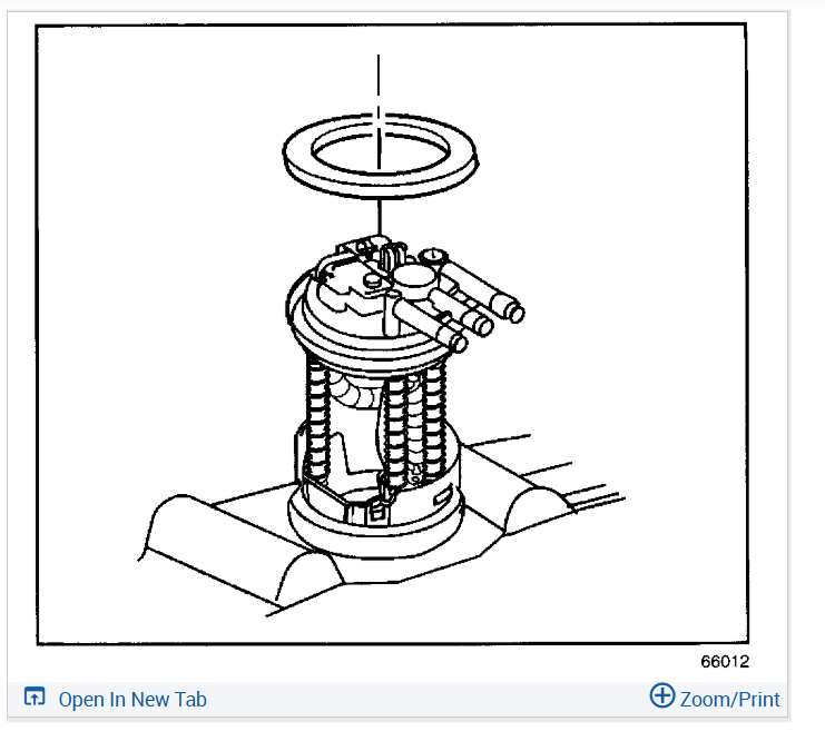

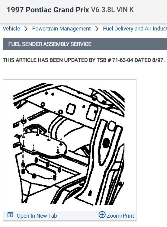

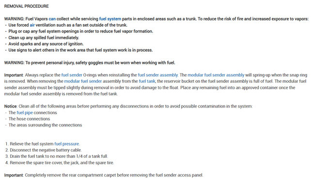

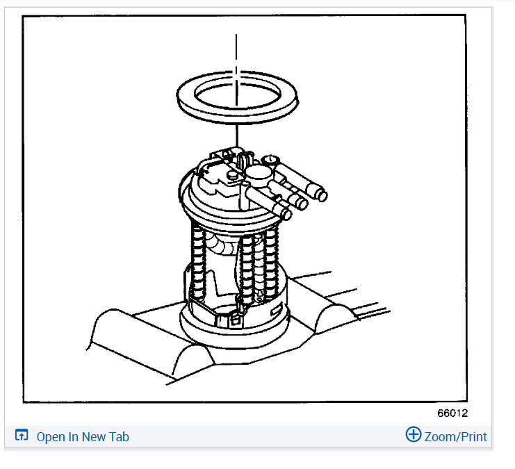

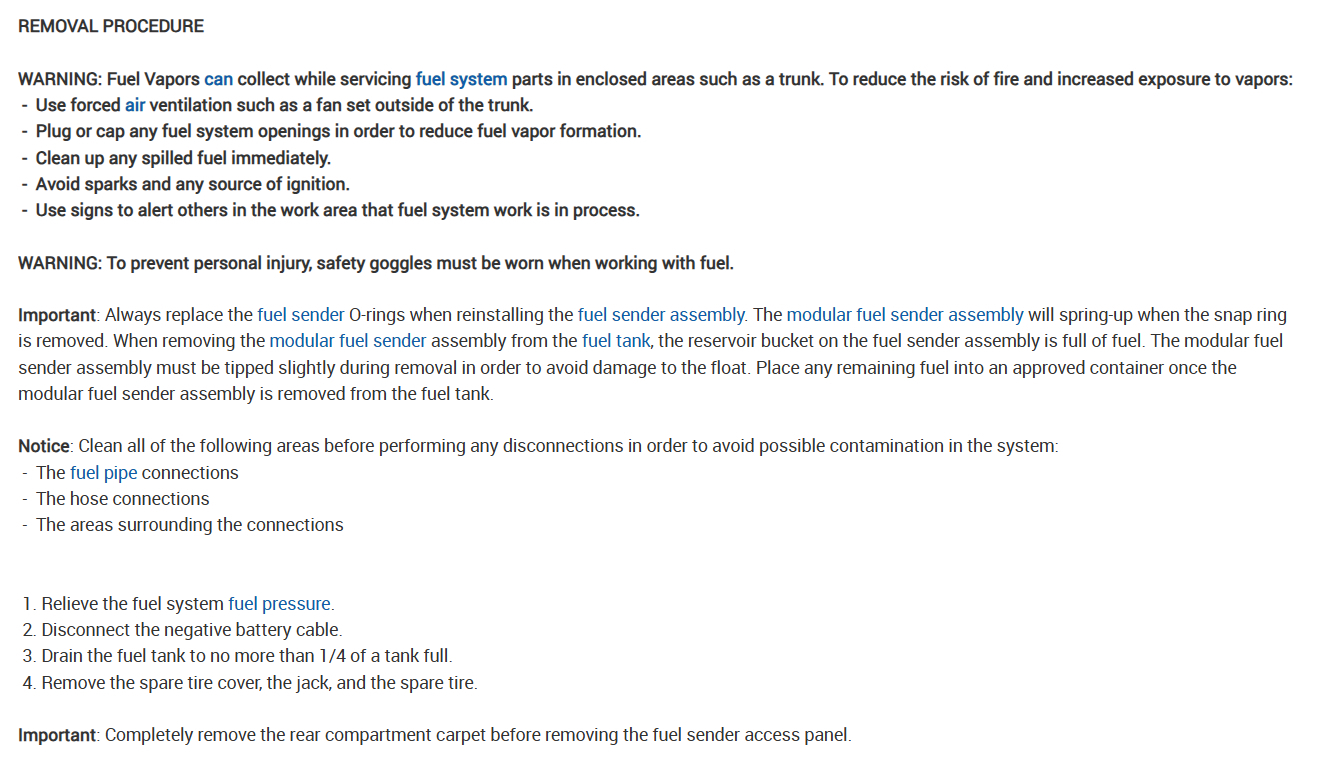

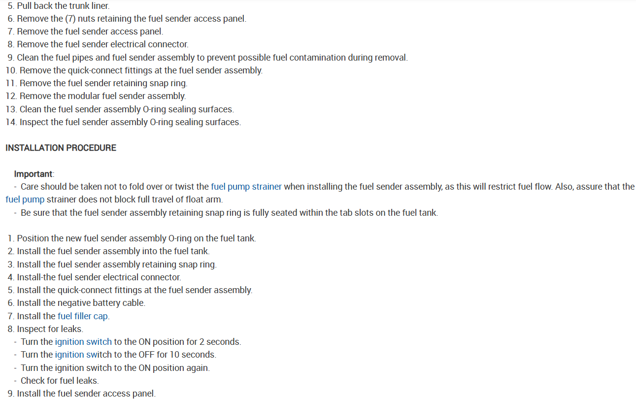

Okay, the engine sounds good, thank you. I would see if the engine runs on starting fluid. If so it sounds like the fuel pump has gone out which is common with these cars. Please go over the video above again to help you with the procedure. Thanks for the video it helps. You are lucky the fuel pump has a trap door which makes the job much easier.
