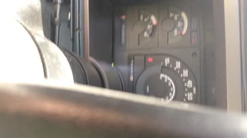

Can you tell me what it exactly doing?
Does it click or make any noise when you try to start it?
Are you getting any lights illuminated on the dash?
Just so we cover the basics, have you tried to jump start it? It is possible to have a discharged battery and that could be the cause of no start.

Brand new battery. Dash lights and everything works.
Wednesday, February 23rd, 2022 AT 9:44 AM
SQM
  • 6,383 POSTS

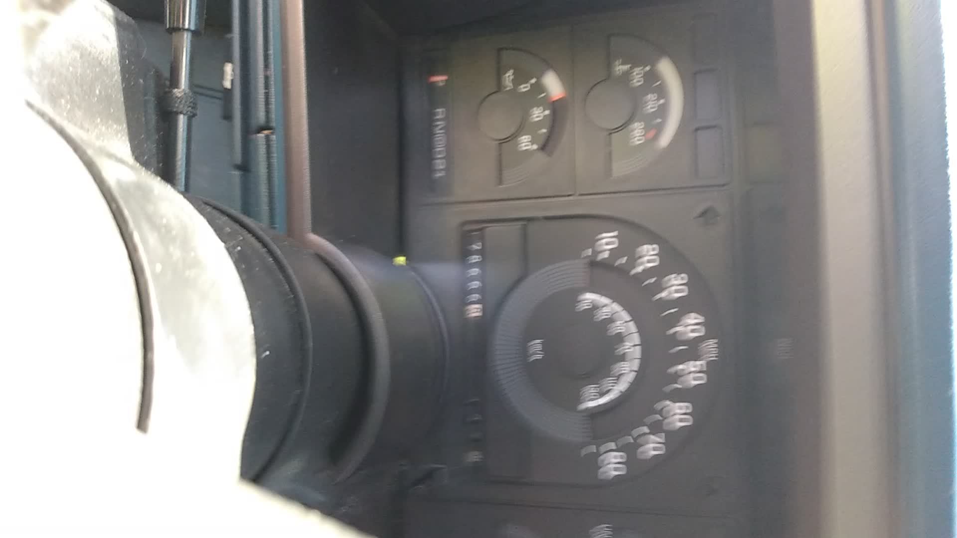

Just watched the video. The engine is cranking over but not starting.
This could be due to not getting any spark or fuel.

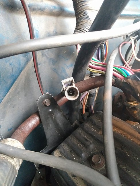

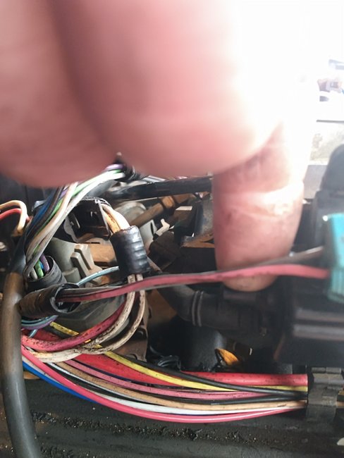

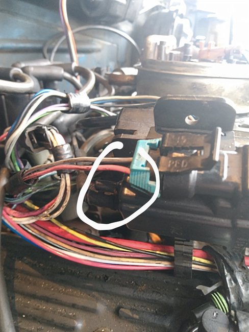

After yesterday I found these two things unplugged. Can you tell me where they go?
Thursday, February 24th, 2022 AT 7:51 AM
SQM
  • 6,383 POSTS

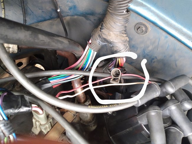

On the first picture I see that it is by the distributor, can you tell me how many wires on that plug? Also, maybe another picture from a different angle would help.
You can also check to see if there is power to the connector with the key to the on position. This could tell us if this is for the ignition system.

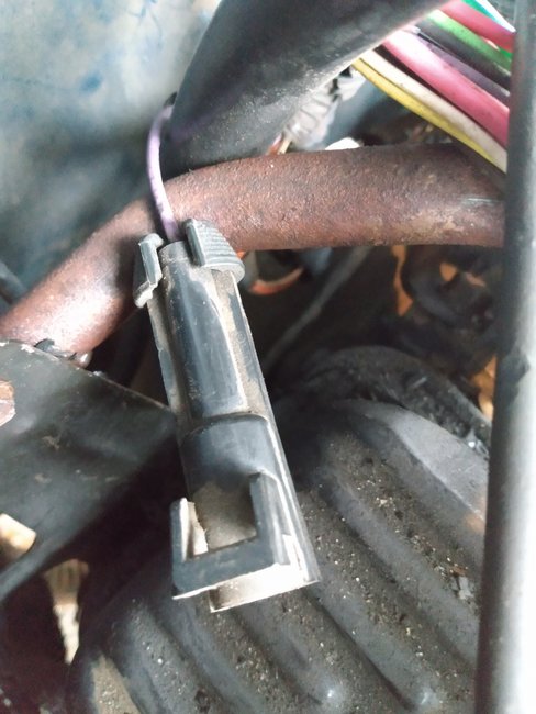

Here's more pics of the plug. Could it go to the fuel pump?
Thursday, February 24th, 2022 AT 8:10 AM
MICHAEL NEEDS HELP
  • 23 POSTS
There is one wire and it's hard to tell if it's blue or purple or what because I am color blind.
Thursday, February 24th, 2022 AT 9:11 AM
MICHAEL NEEDS HELP
  • 23 POSTS

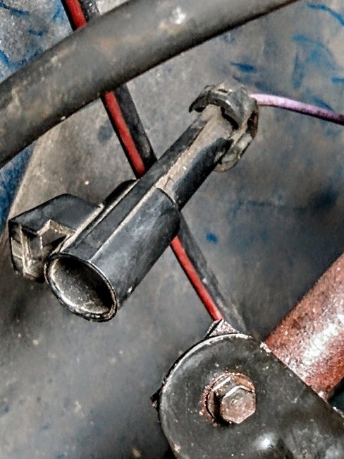

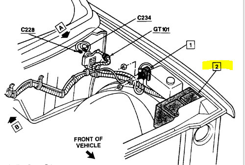

Also where does this go?
Thursday, February 24th, 2022 AT 10:06 AM
SQM
  • 6,383 POSTS
I am having difficulty finding the harness that those plugs belongs to.
When you turn the key on, is there power to those connectors?
Check the coil pack and make sure the connectors are secure.

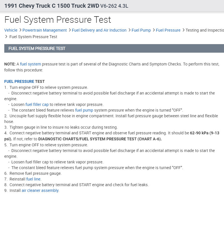

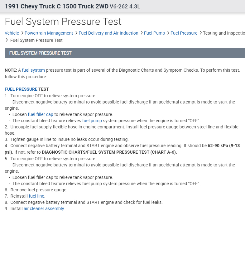

If the pump is turning on, then it is not the relay. It could be a weak pump that is not providing adequate pressure. Or some sort of restriction in the line, like a dirty fuel filter of a clog in the line.
If the pump is turning on, then testing the fuel pressure can help you determine if the pump is weak or has issues in line or a bad fuel pressure regulator.
This engine should have at least 62 PSI fuel pressure with the key on and engine off.

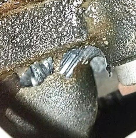

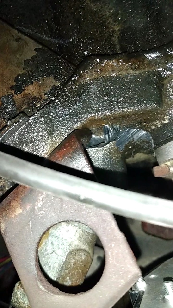

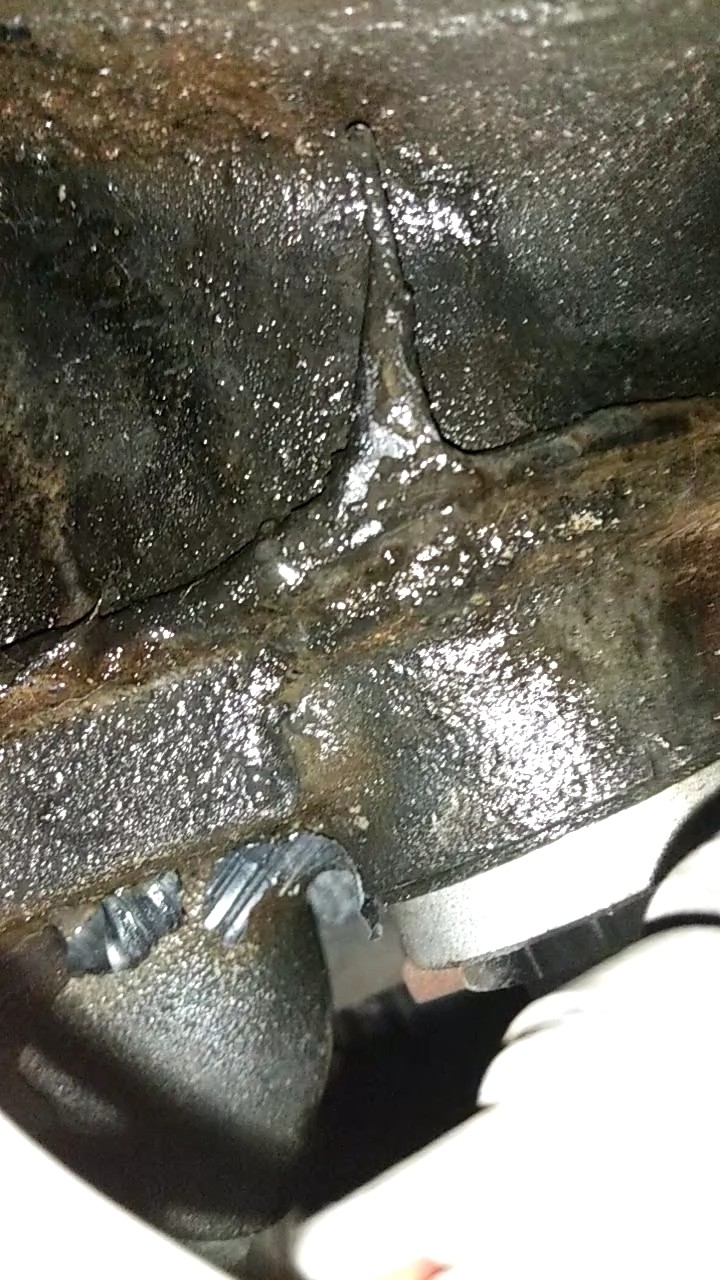

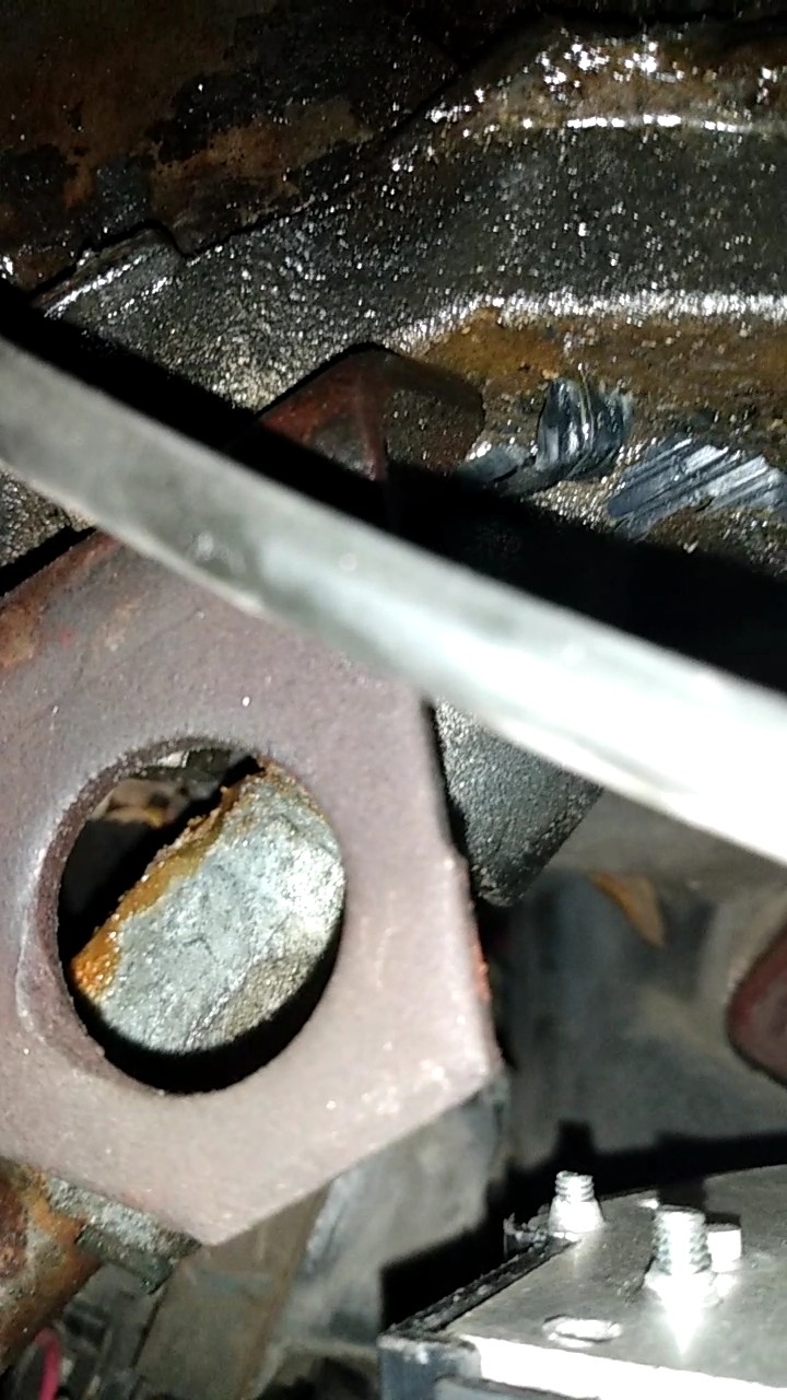

After a day of rest, I'm back at it, this time I have replaced the plugs, fuel relay switch, headlights and still no crank. So, I went chasing a loosen ground wire. Well low and behold I found something, but I don't know what it is, I made a video and took several frames for you, this is shot on the firewall looking forward. What is the black and is it disconnected? Also is this ground wire supposed to have something else hooked to it I know it's dirty.
Tuesday, March 1st, 2022 AT 7:29 PM
SQM
  • 6,383 POSTS
It is difficult to figure from the picture. But the black piece looks like part of some sort of connector or seal.
The ground wire looks to be normal. You do want to clean around it and possibly remove the bolt and clean the mounting surface for good contact.

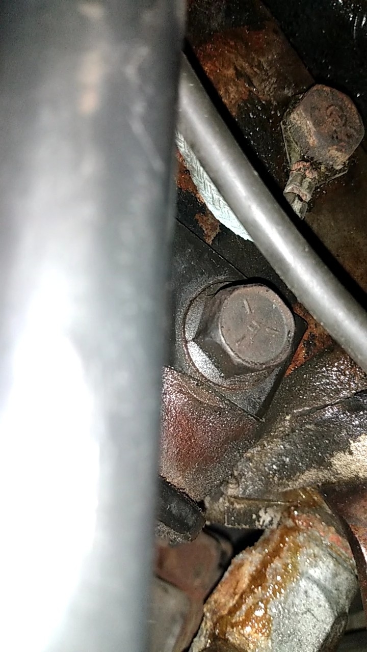

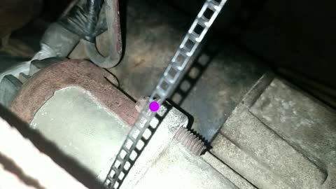

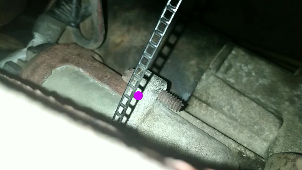

After much looking, I am down to the starter or the fuel pump, mind you all this started with a head light bulb replacement. I made a video of the starter; sorry it was the best I could do. I'm lost at what I'm looking at or for.
Wednesday, March 2nd, 2022 AT 9:15 PM
SQM
  • 6,383 POSTS
From one of the earlier videos you uploaded, the engine is cranking over. Since it is cranking over the issue probably not the starter. As if the starter was bad, you will get a clicking noise and that will be all with not cranking over.
Did you get a chance to check for fuel? Even if the pump is turning on, it is possible to have some sort of clog in the fuel line or have a bad fuel pressure regulator.
As you mentioned you are getting a good spark, then the only item left is fuel.
