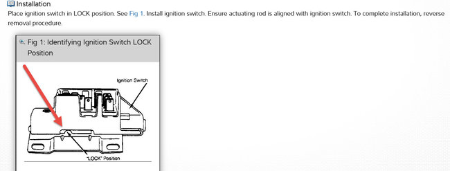

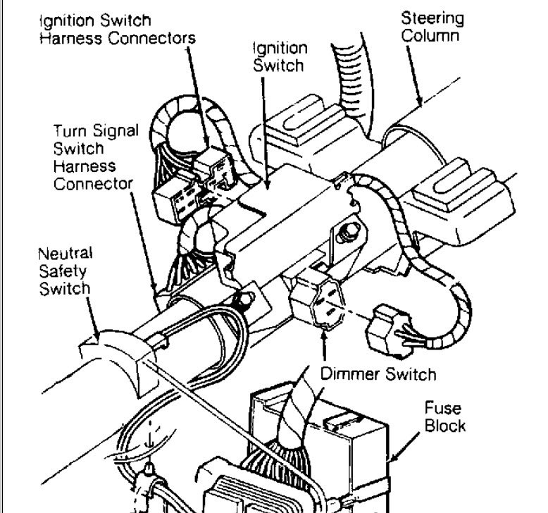

Trying to find ignition switch, not the key ignition the switch by firewall. How to change it?

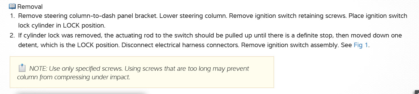

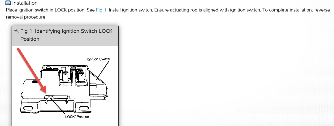

See pics this may come in 3 emails.

LADAVE04
Thanks alot, I am going to check link also, was just trying to cover all bases, battery and strater are good. Cleaned all grounds, so its down to switch or link. Thanks for the pics it helps to see what I am looking for.
Monday, December 28th, 2015 AT 9:48 AM
HMAC300
  • 48,601 POSTS
Well if you get power to everything but start it's usually a fusible link that has burntup they run right off of battery to fuse box underhood.
Monday, December 28th, 2015 AT 11:59 AM
LADAVE04
Ya, this one runs from starter up across to driver side then right into the switch on column under dash. This wire has no link in it. Made me crazy till I fround someone who knew this.
