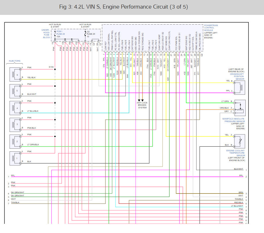

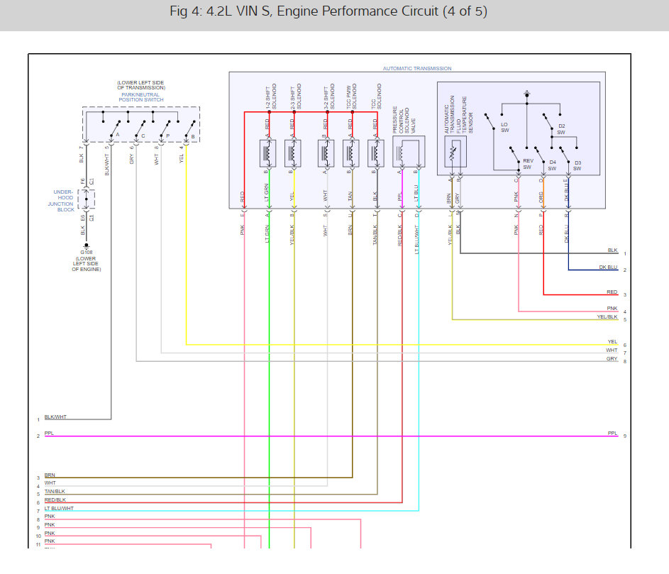

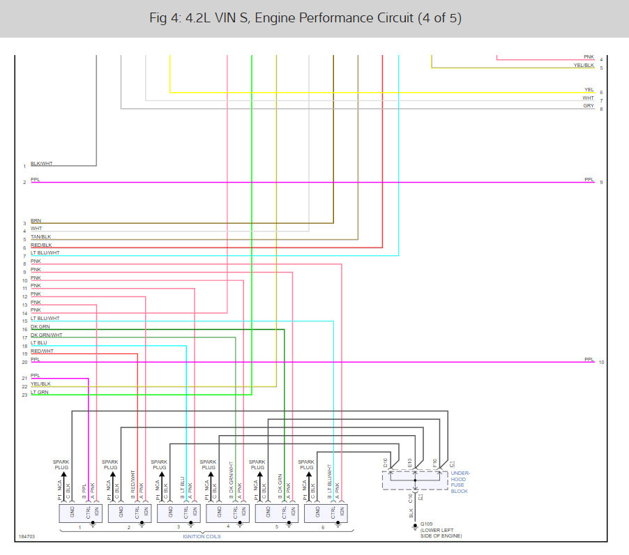

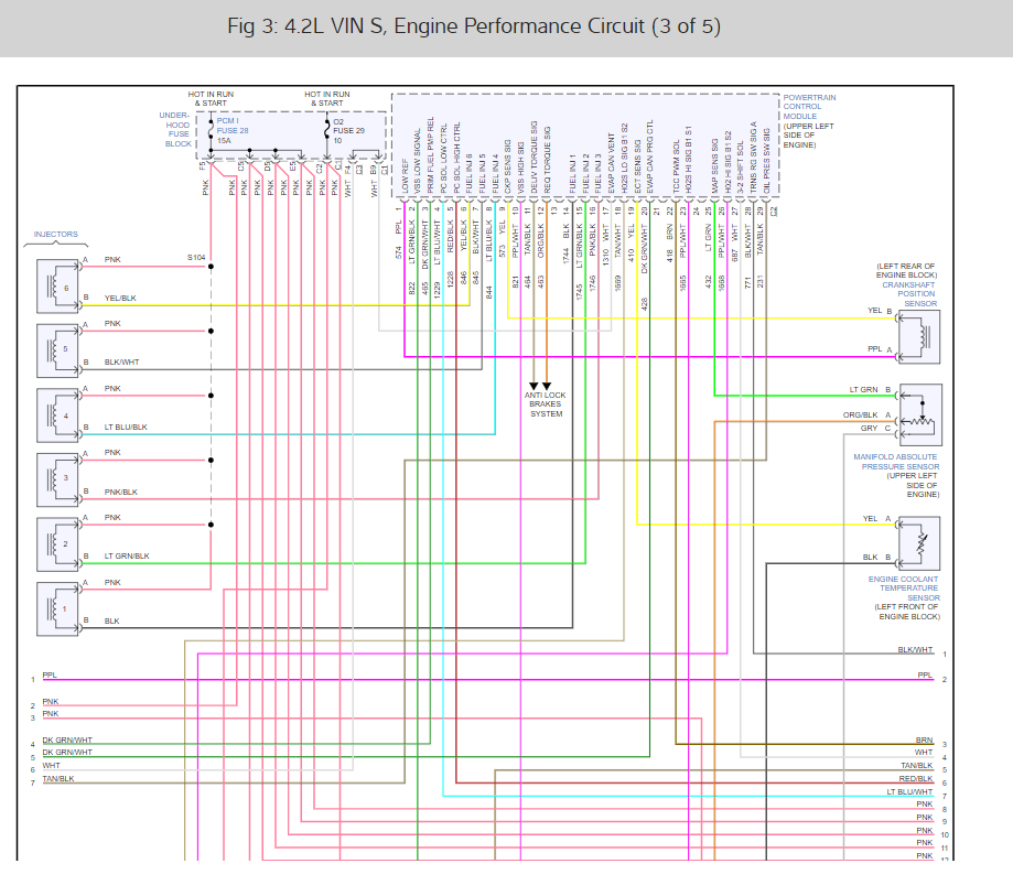

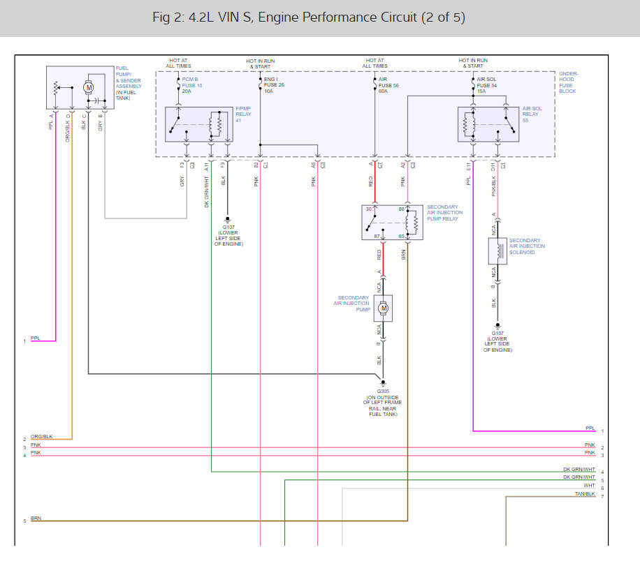

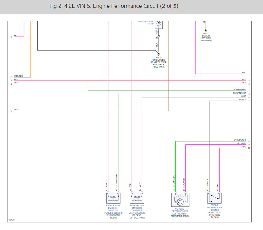

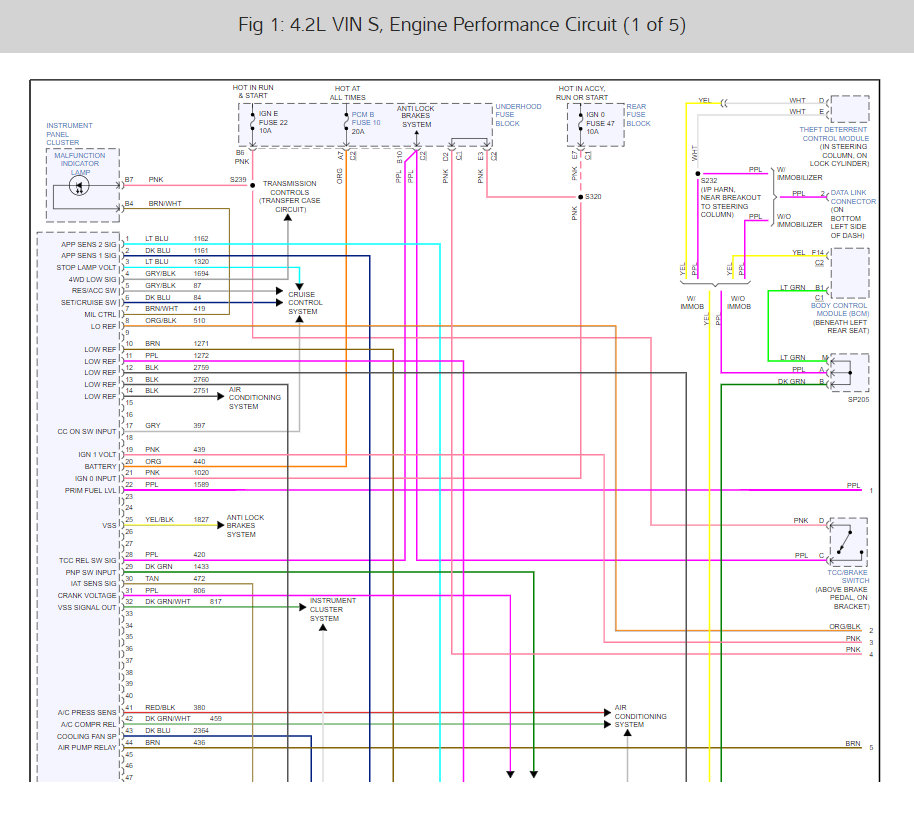

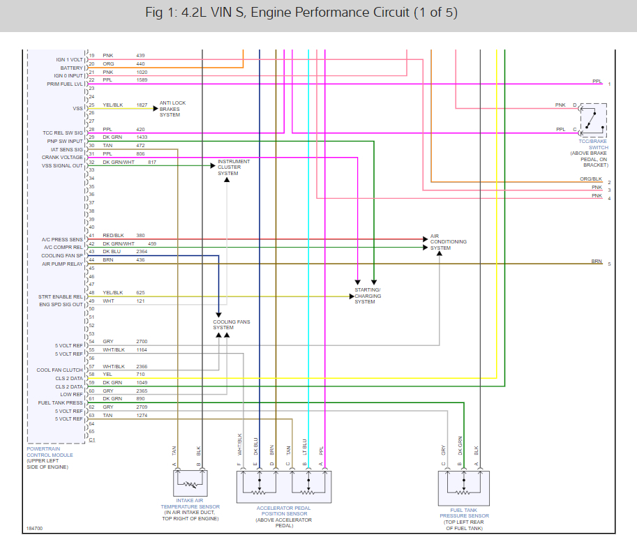

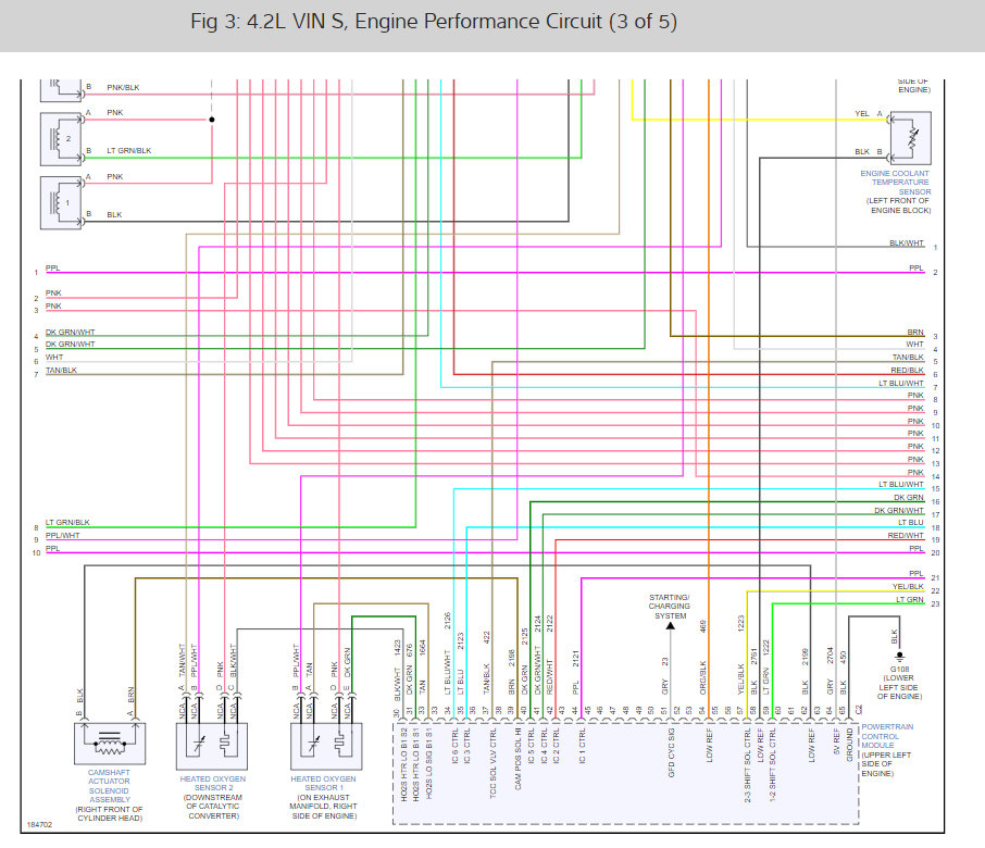

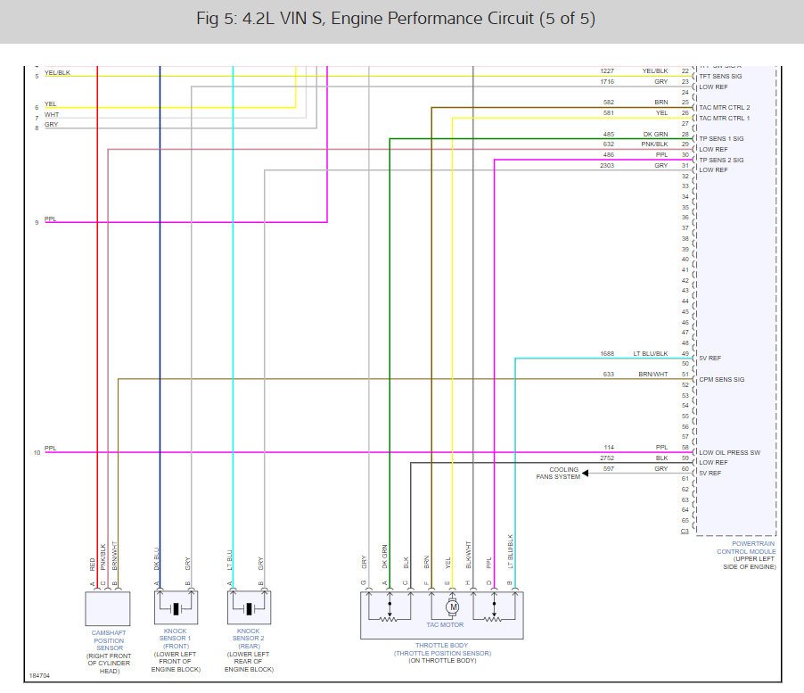

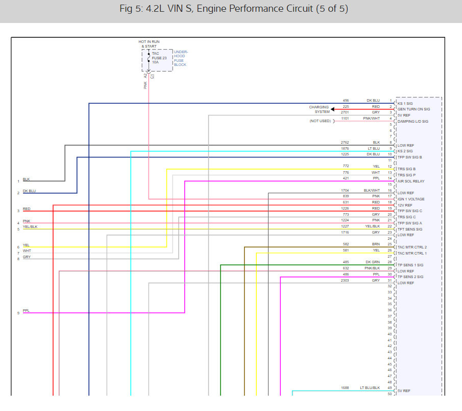

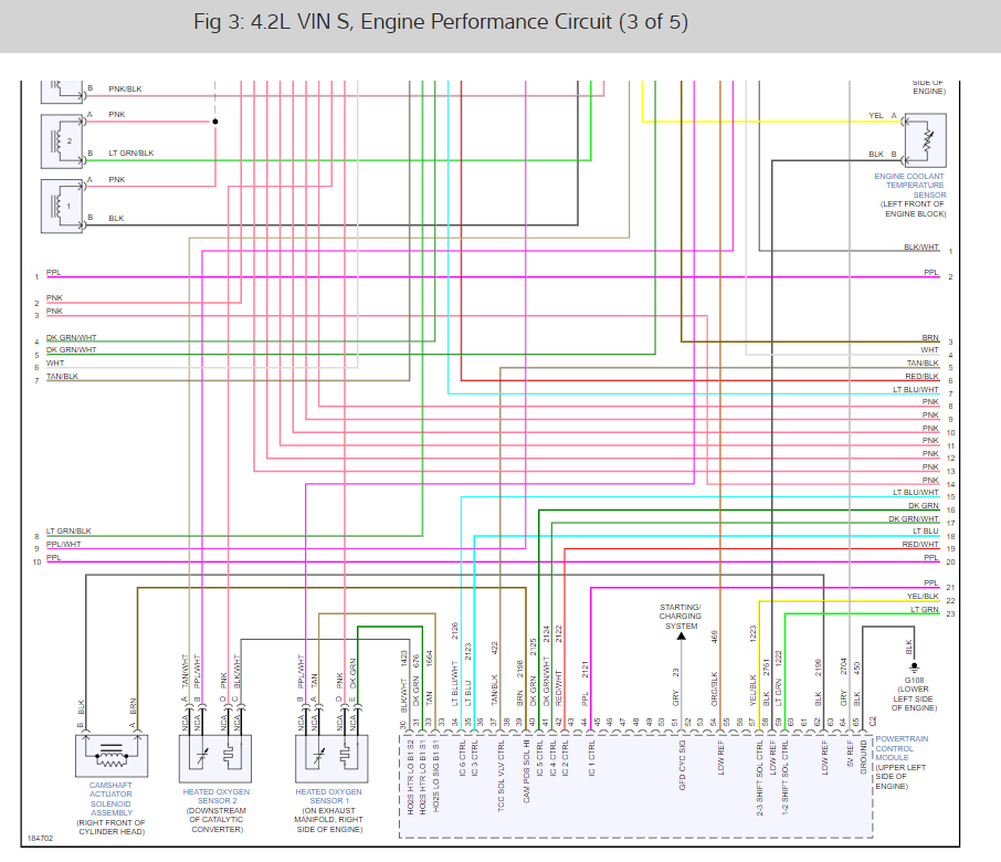

I need the labels for the wires for my 26 pin connector because mine got cut.
Monday, January 25th, 2021 AT 1:46 PM
KEN L
MASTER CERTIFIED MECHANIC
55,266 POSTS
Here is a guide to help you witht he testing and the engine wiring diagrams below:
