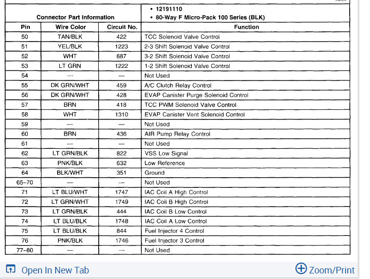

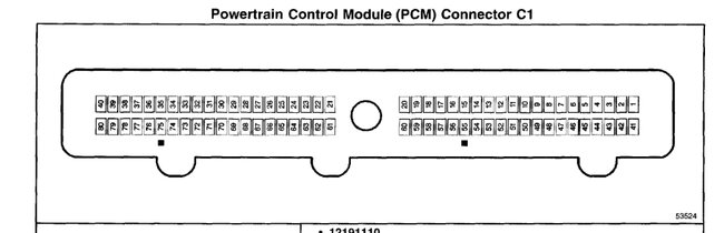

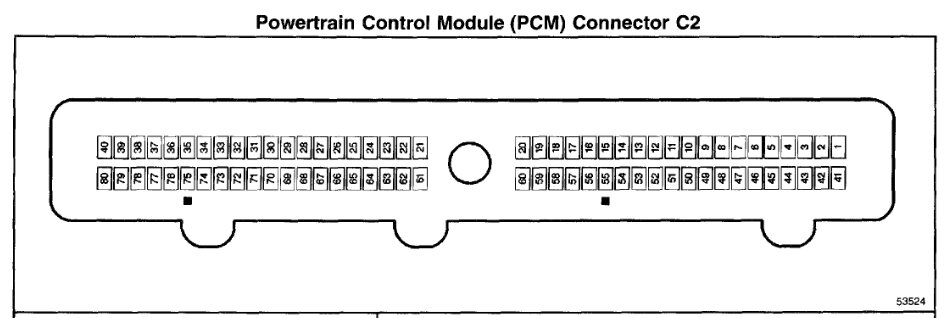

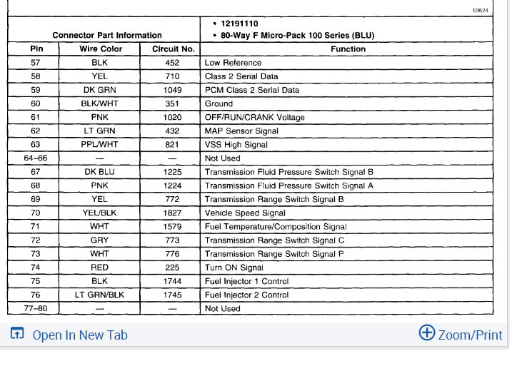

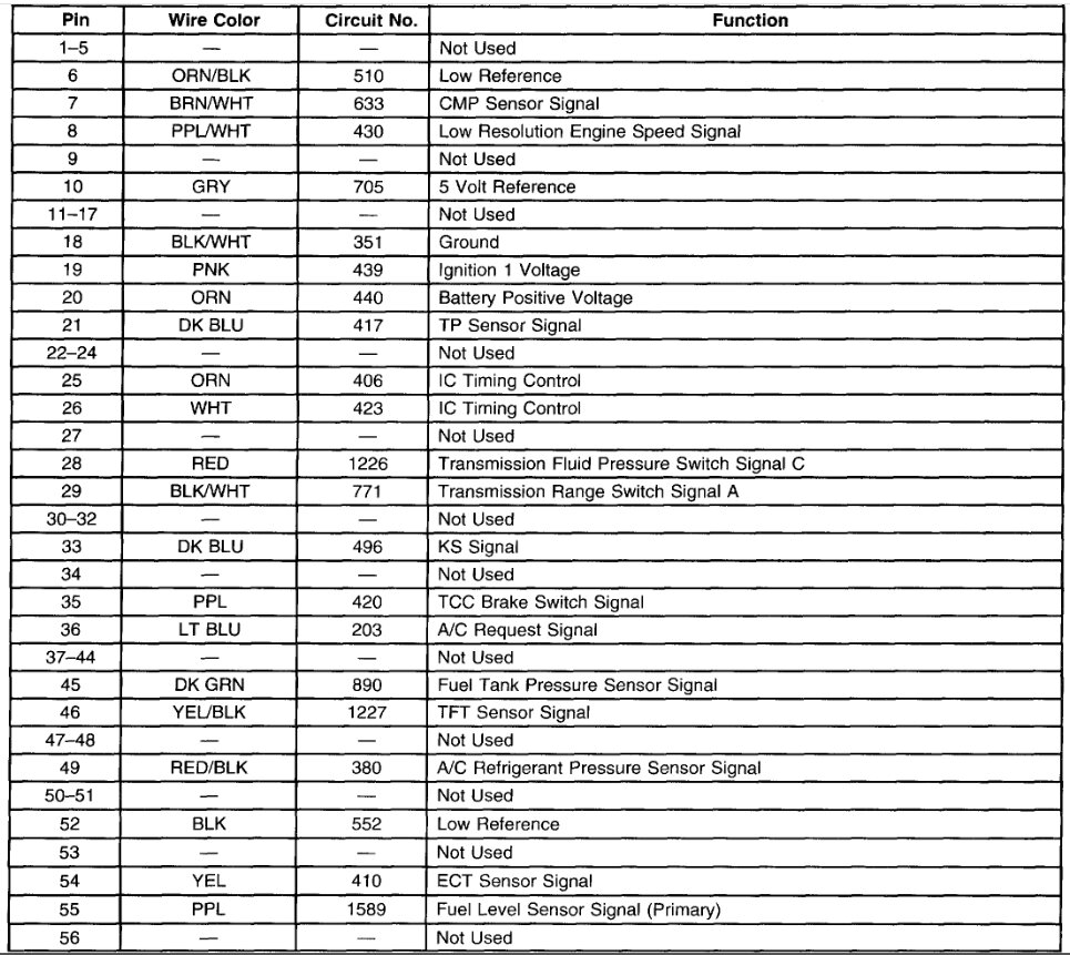

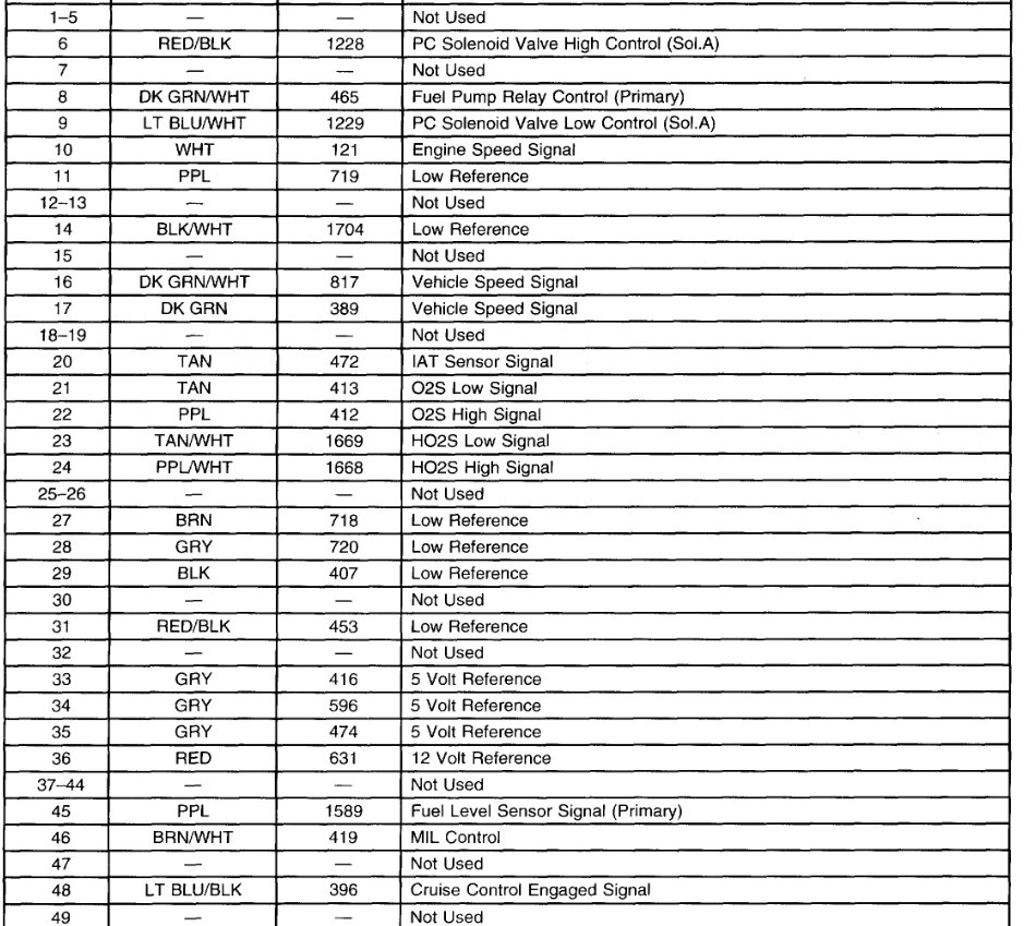

I have a wiring harness from a 2001 s10 2.2l. I need pin outs for the computer as the harness is going into my 98 s10 that is a 2.2l and I need to integrate it into the truck. Thanks in advance

Sure, here are the PCM C1 and C2 connector pinout views. Check out the images (below). Let us know if you need anything else.

What pin outs are these? Are they for the 2001 or the 1998 I’ll need both for this to work.

This post is for the 2001 CHEVROLET S-10.
