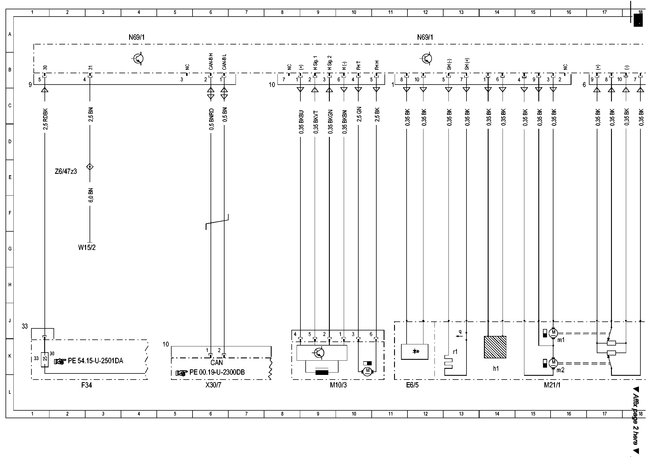

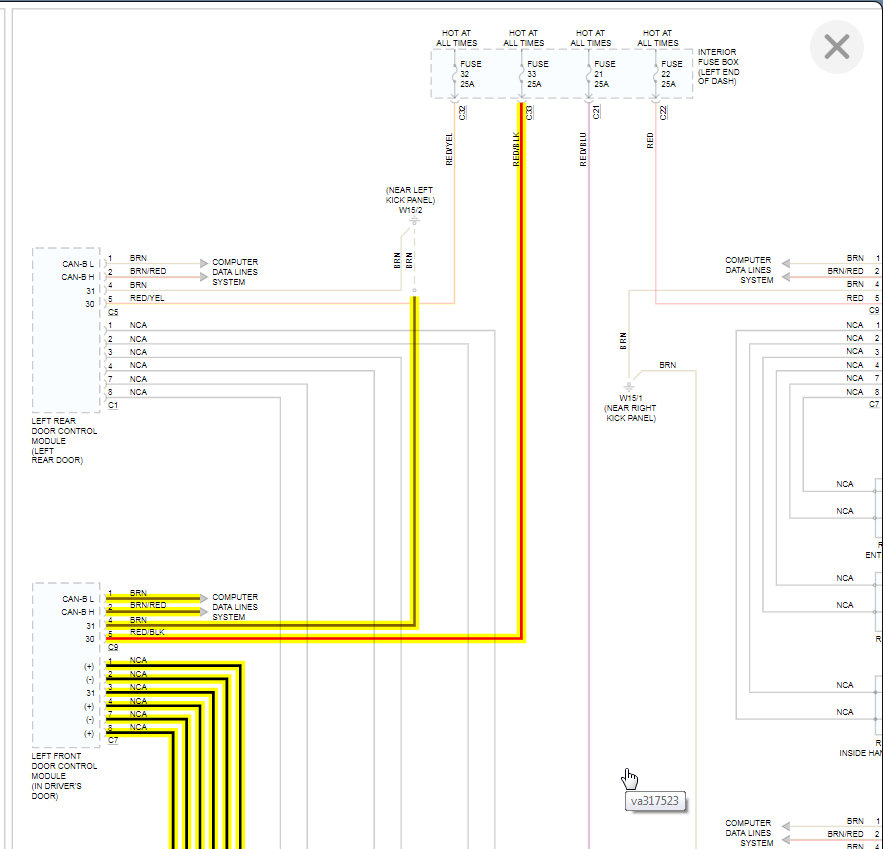

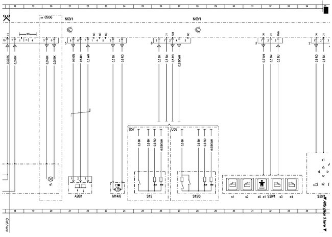

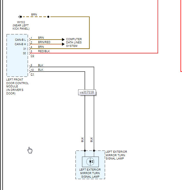

I need the wiring diagram for the DCM to the driver side mirror. For the power heated mirror and turn signal indicator. Thanks

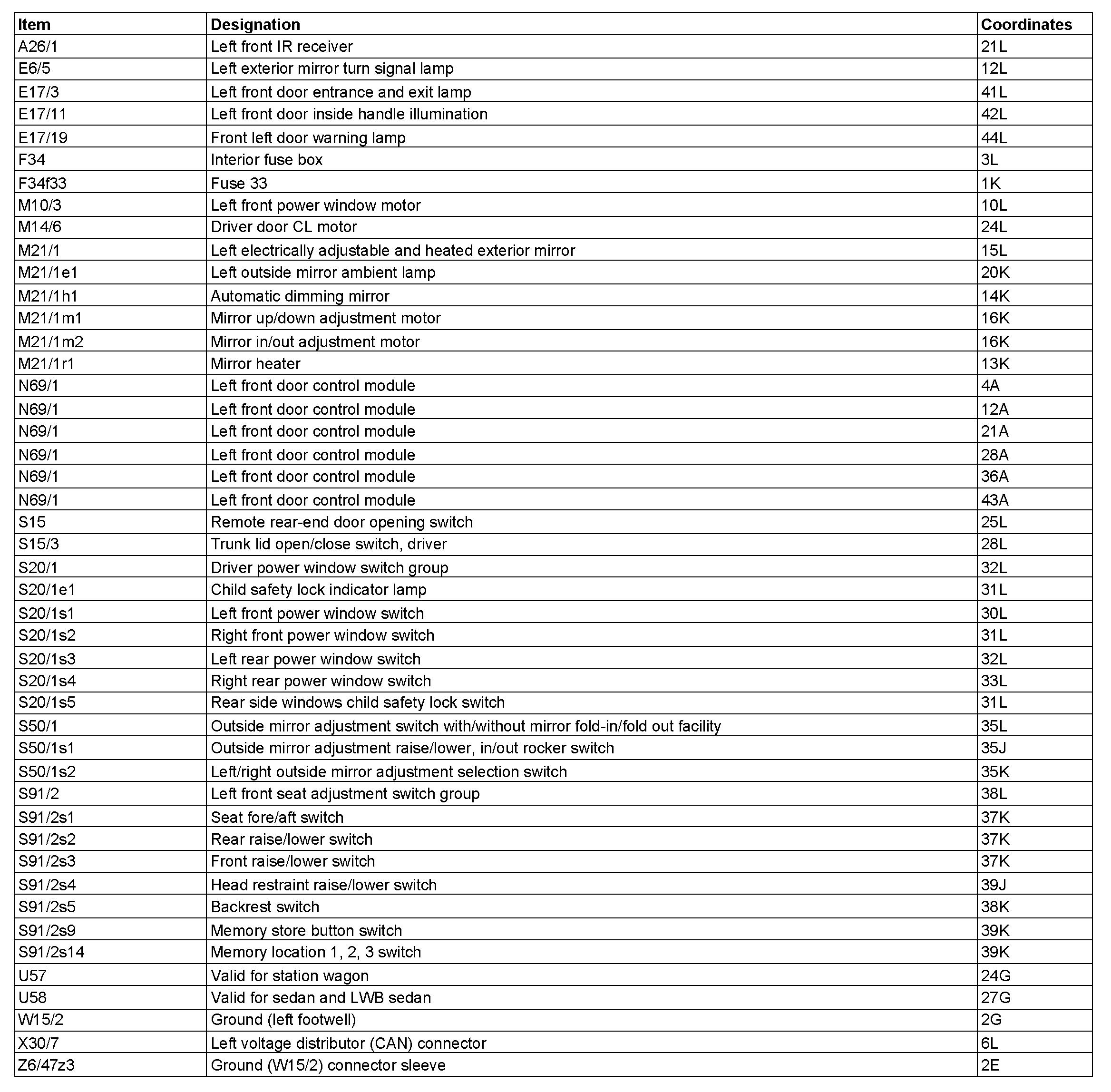

I attached the DCM schematic for the left door. Let me know if it helps.

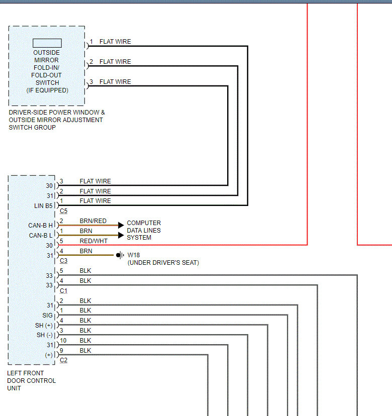

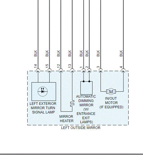

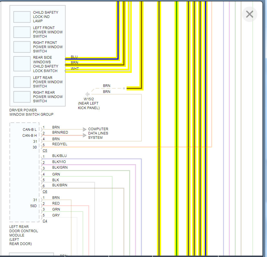

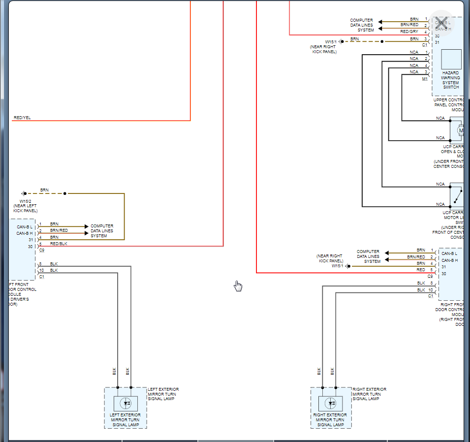

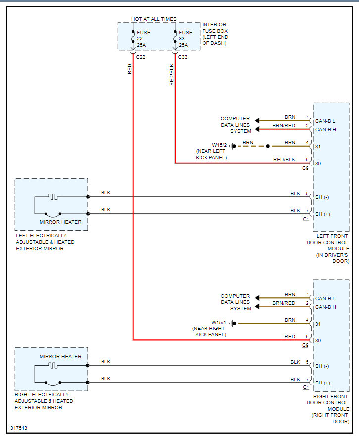

Here is the diagram for the DCM to the heated mirrors and the last two are for the turn signals in the mirrors. Let me know if you need more. Thanks

I still need the pin out leaving the DCM on 1 and 6 going to left side miror where it connects to 4 different functions. The turn signal(done), the mirror heater, the mirror motor, and dimming feature. The mirror motor uses a plug with 7 wires while the other three use only 2 wires. That’s 13 wires total to terminate using module 1 and 6 from the DCM. So a pin out for these or a diagram sure would help. Thanks again.
Monday, February 17th, 2020 AT 3:00 AM

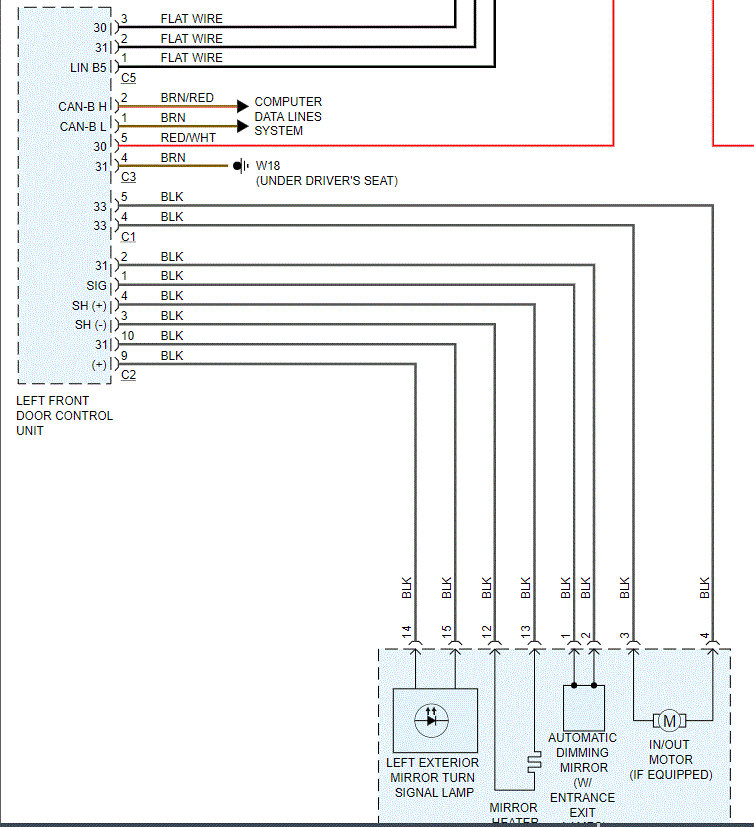

Unfortunately, I could not find a connector view which would be great. So I think I got all the circuits you need for the front left door control module.
Let us know if we missed something and we can go after that. Thanks

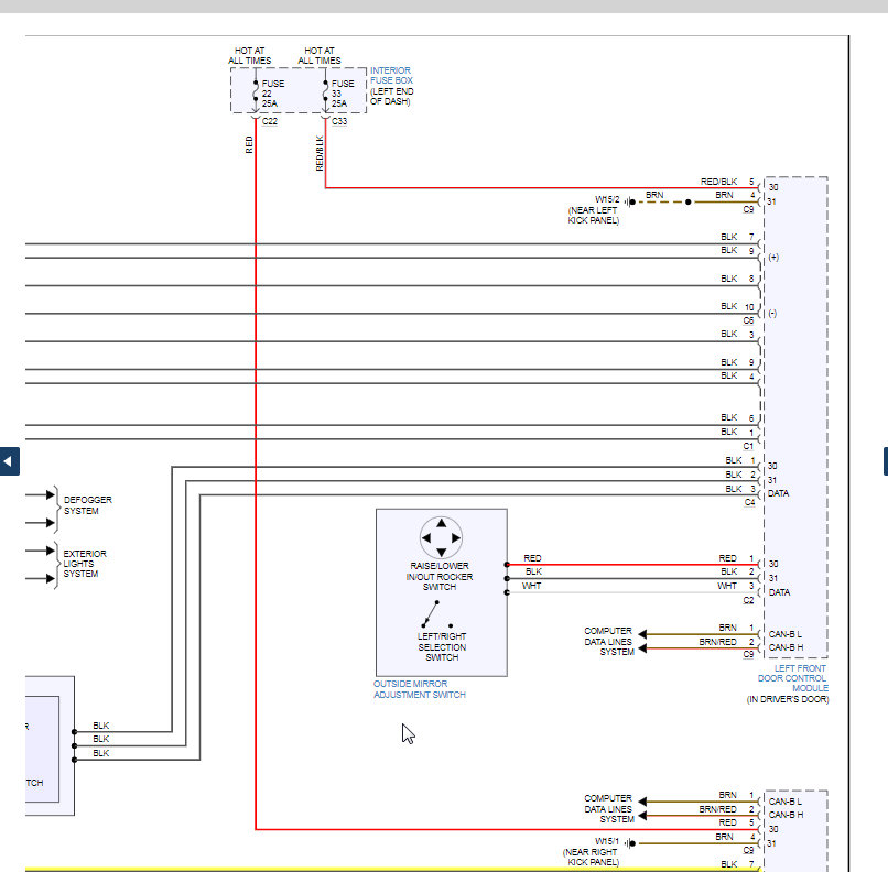

Thanks but still need wiring diagram for the drivers side mirror motor that moves mirror.
Also module 6 on the dcm. Also module 1 from the DCM. I need to know the config. For the 8 pin connector that goes to side mirror motor. And module 6 on DCM and where it terminates. Thanks again.

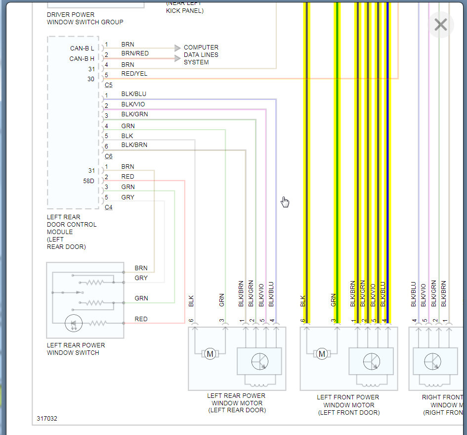

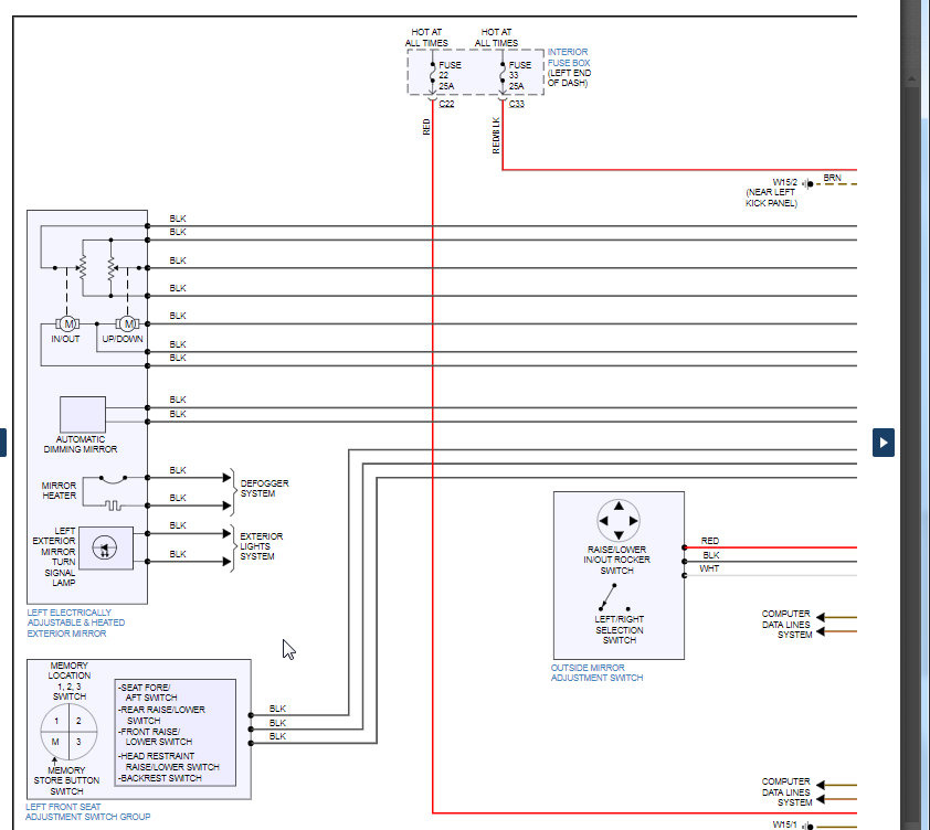

Let me know if this is what you are looking for. I have schematics all over the place. LOL

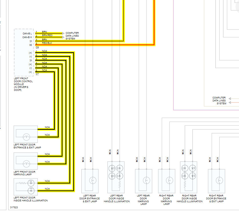

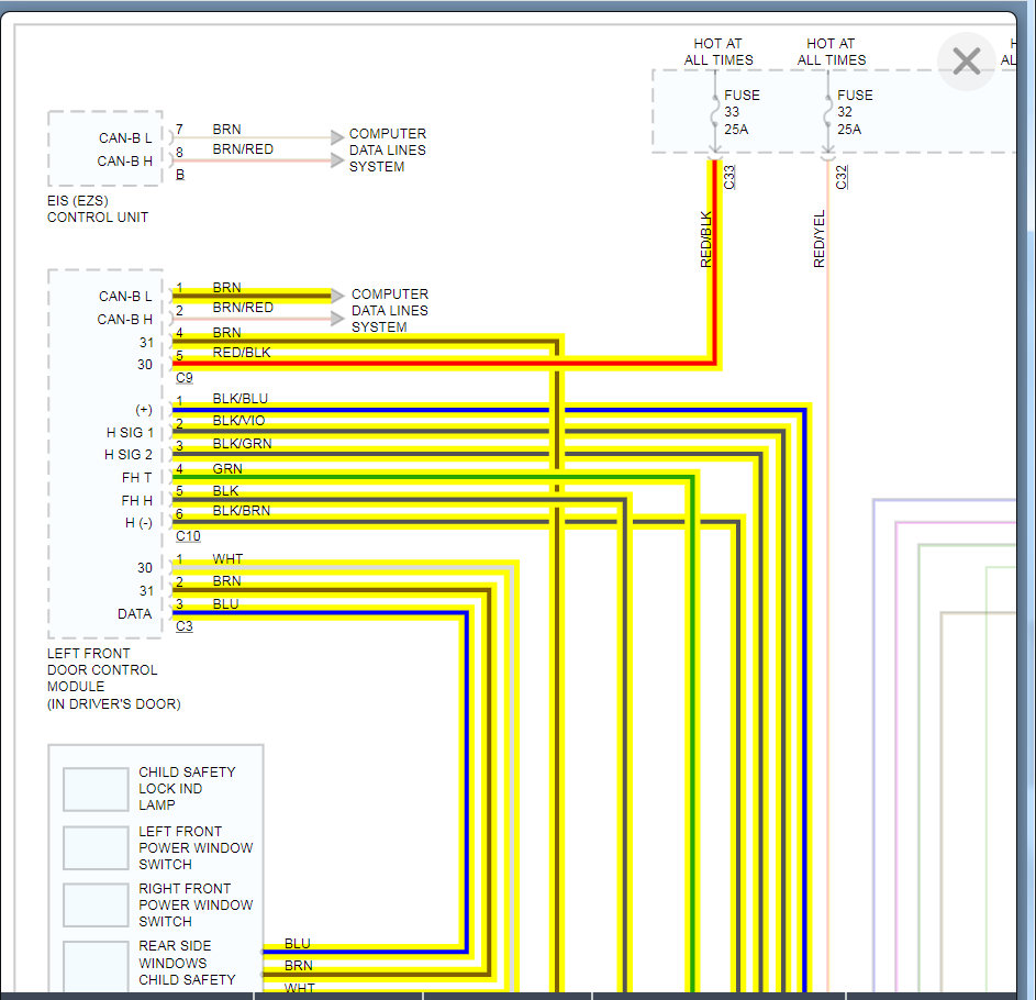

Howdy thanks for the help. I am still looking to see schematics for the c6 on the DCM. And she what it supplies.

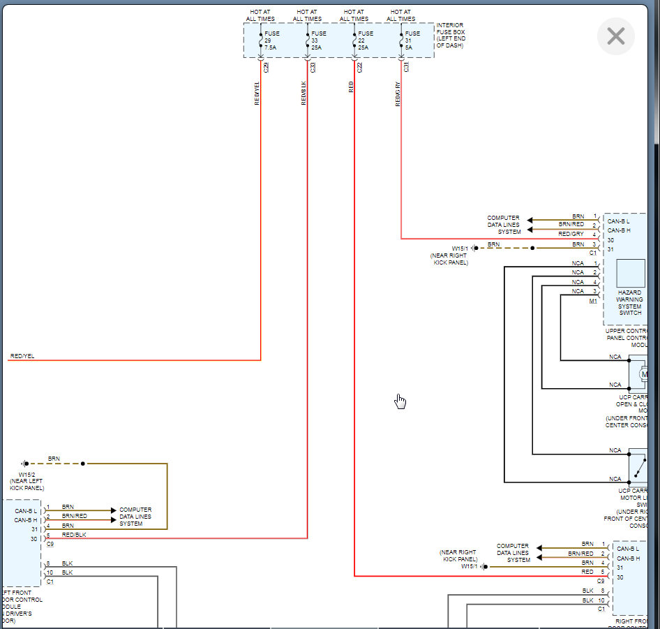

Okay. I switched from AllData to Mitchell and they seem to have more diagrams. Here is C6 from the DCM to the Power Mirror motor.
C1 for the dimming function. However, it only has Pin 1 and 6. I am looking for the others.
C2 Pin 1-3 are included and it appears that is all on that connect. Is that correct according to the vehicle?

I’m sorry but I meant c6 not c2. C6 is what has been the missing link.

Never mind I see the c6. You are awesome to stick with it. Many thanks now I won’t do the work 5 times.
