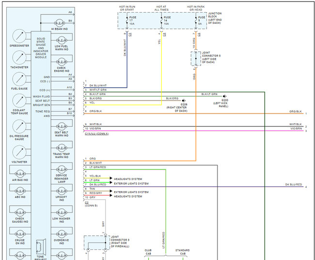

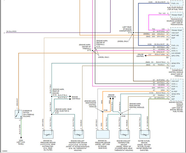

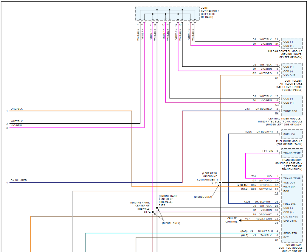

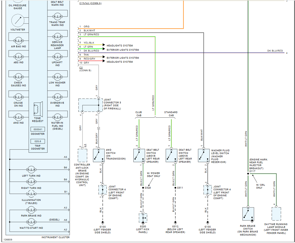

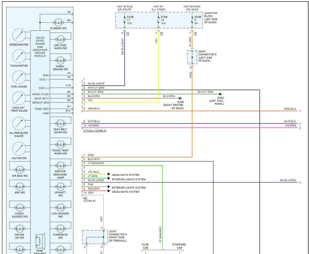

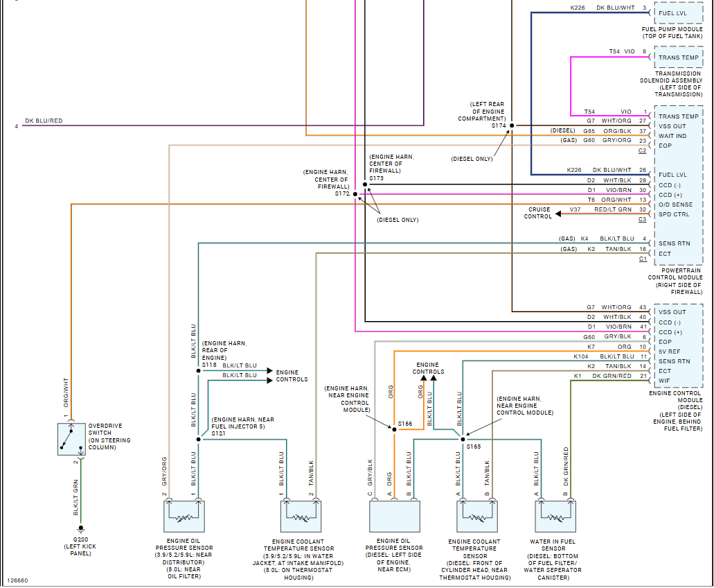

My friend says he's rewiring a cluster on a 2000 Dodge ram 1500 and I'm looking for a diagram. Or anything useful please

Here is the wiring daigrams for the instrument cluster as requested. Check out the images (below). Let us know if you need anything else.
