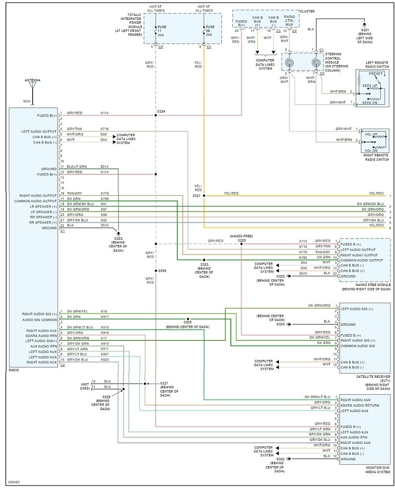

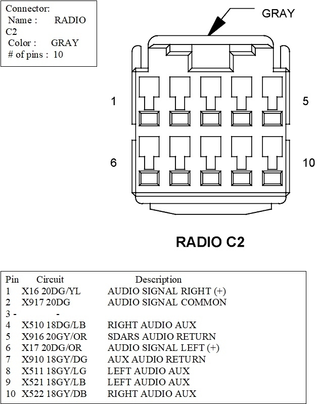

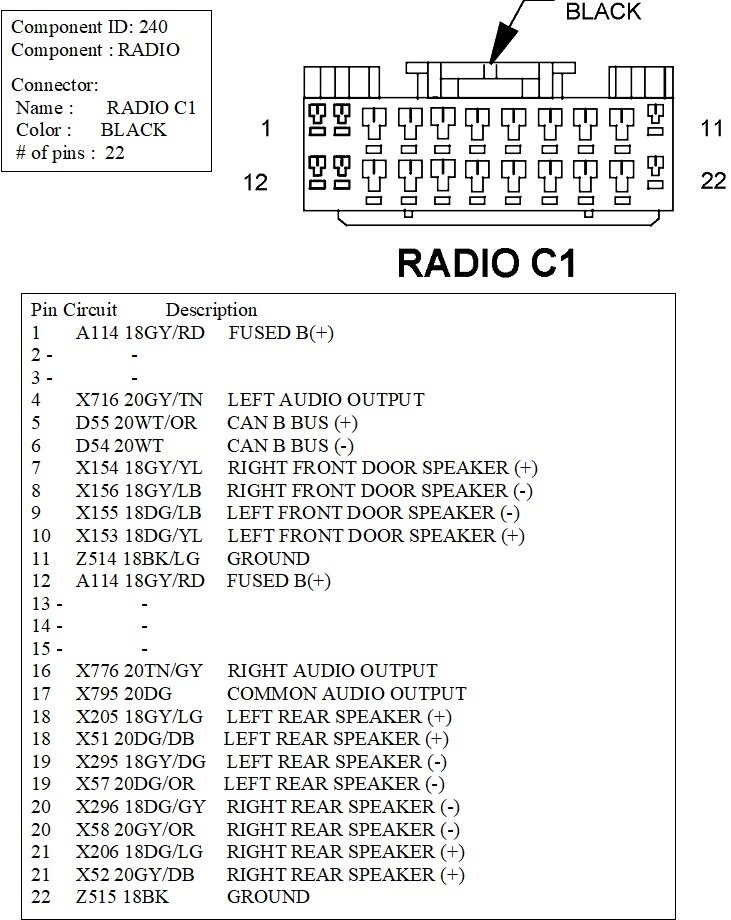

Need a schematic of radio harness on a 2008 1500 factory has 2 plugs.

Here's the connectors to get you started. Which system do you have? There's the base system, and the premium system that uses a remote amplifier.

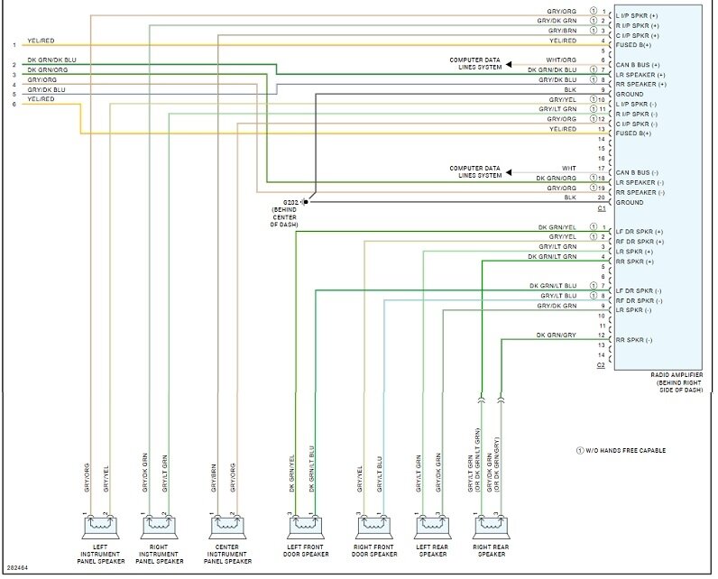

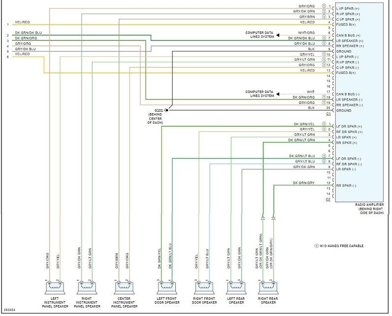

Update: These are the diagrams for the premium version. Let me know if you need them for the base system or if you have other questions. If you need to enlarge these, the easiest is to copy them into a typing program like MS Word, then expand them there. When I try to expand them then piece the sections together, they lose too much definition and become almost unusable.
