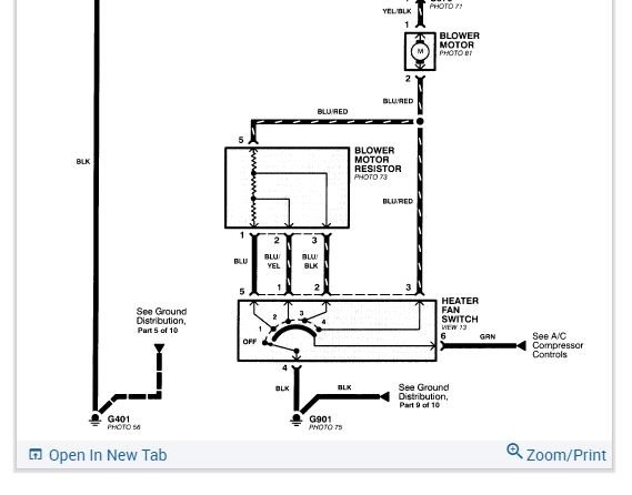

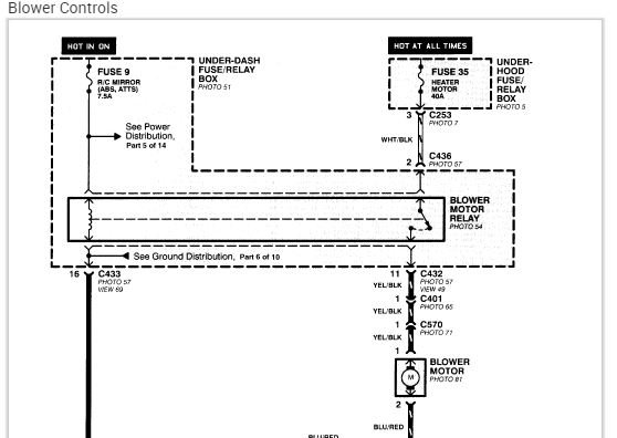

Blower motor.

Hello my name is Dave.
Here is the wiring diagram for your blower motor. Please let us know if there is anything else we can help you with and thank you for using 2CarPros!
