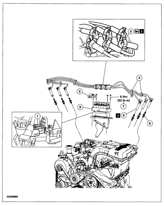

I want to replace my spark plugs and wires since I know my SUV is due for it. But I do not know where the wires are located. I got the idea of how to change the spark plugs, but how do I change the wires? The only video I found was for V8 engine and it looked completely different from mine.

Attached image for the wires. When you disconnect them from the spark plugs trace them back to the coil. They normally run towards the back of the intake. Hope this helps.
