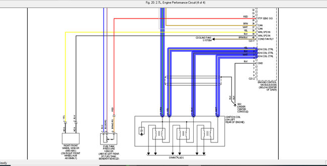

Had to replace coil pack wire plug 4 pin. Got it from wrecking yard it's different color still 4 pin colors are black, red white and yellow from ignition plug . what i need is colors go to what coils the coil pack has 1 yellow/black. 2.Blue 3 orange/white. 4 black/white schematics would be awesome plug to plug please.

hello,

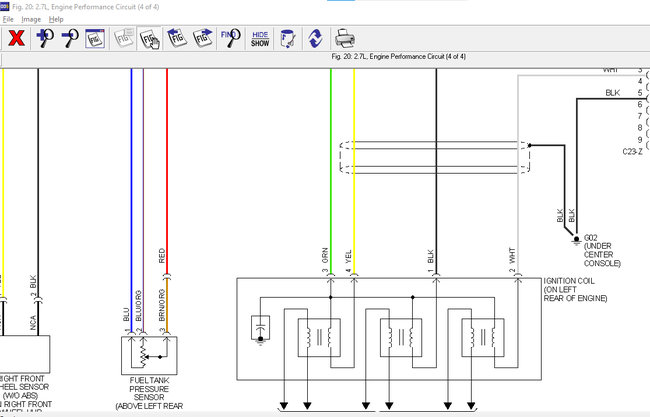

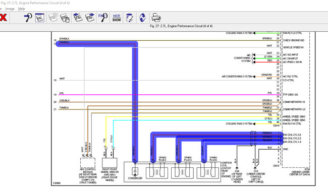

Check the diagram below for coil pack color. picture 1 below if for hyundai santa fe 2.7 v6 same engine and picture 4 is the diagram specific to your engine sonata 2.7 v6.
1 is org/bl
2 is yel/wh
3 is pink/bl
4 is red/bl
Let us know if you need more help.
thank you
